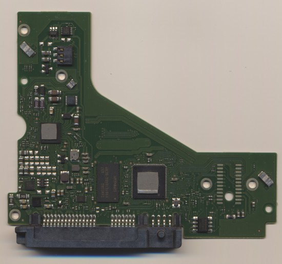

Repair – Front
https://ufile.io/ez3jou40
Repair – Back
https://ufile.io/h77bd47a

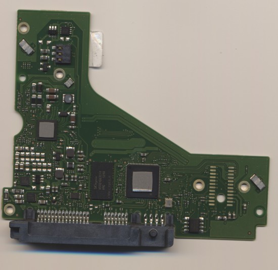

Granted please note they said that the original rom was too damaged to transfer. They did this as a courtesy. I have another pcb donor board that has supposedly a new rom with my original bios information transferred over to it. However, you can see here the "condition” of the original rom. I am hoping all the information can still be transferred from this rom. Its not beat up too bad right?
Both pcb donor boards; the one with the original rom and the new transferred over with the information rom do not power up the drive at all. Zero, zilch, nada.
I can post photos of the new rom and new board if needed as well however, it looks good I believe. If the information was transferred over properly.

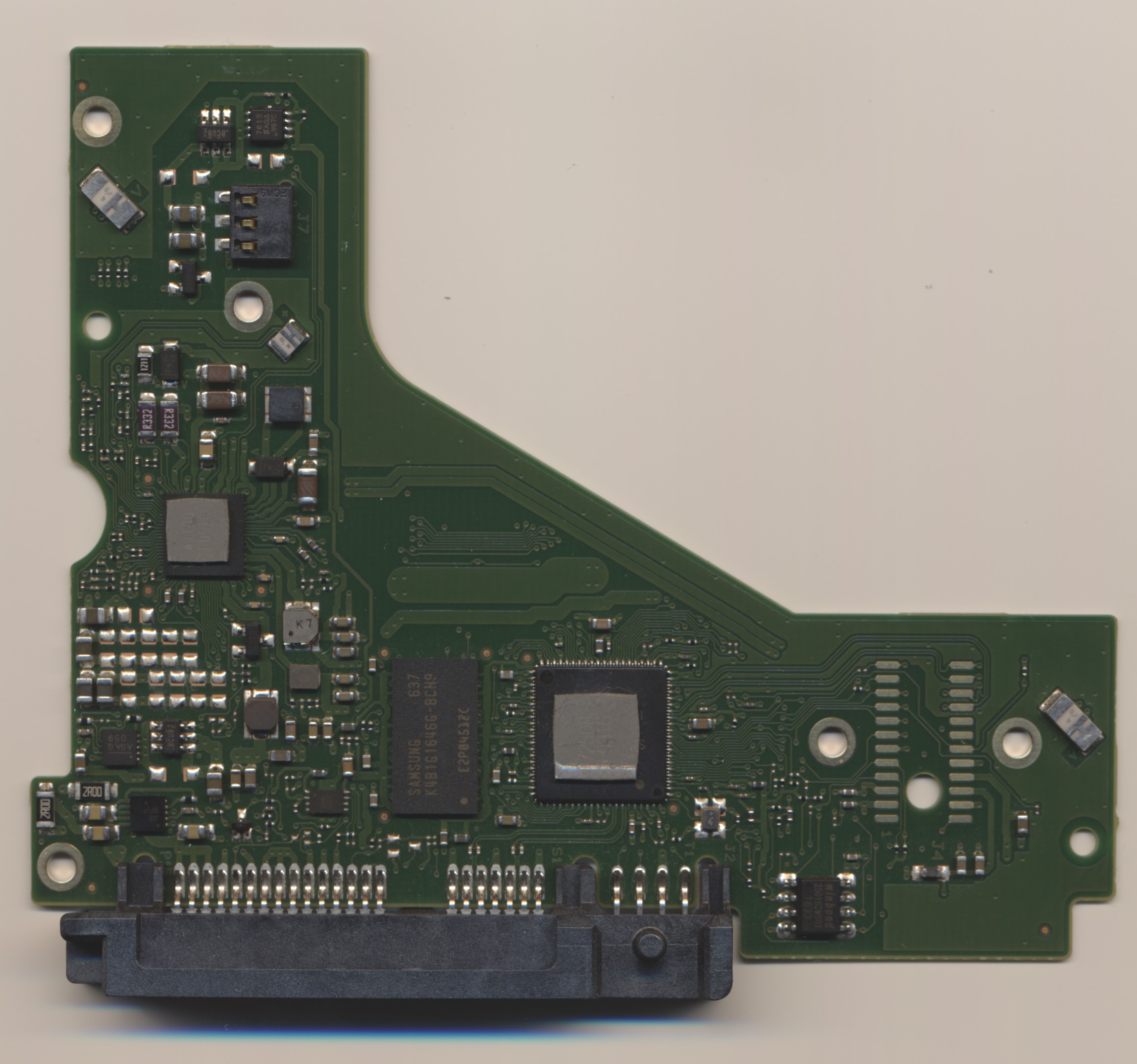

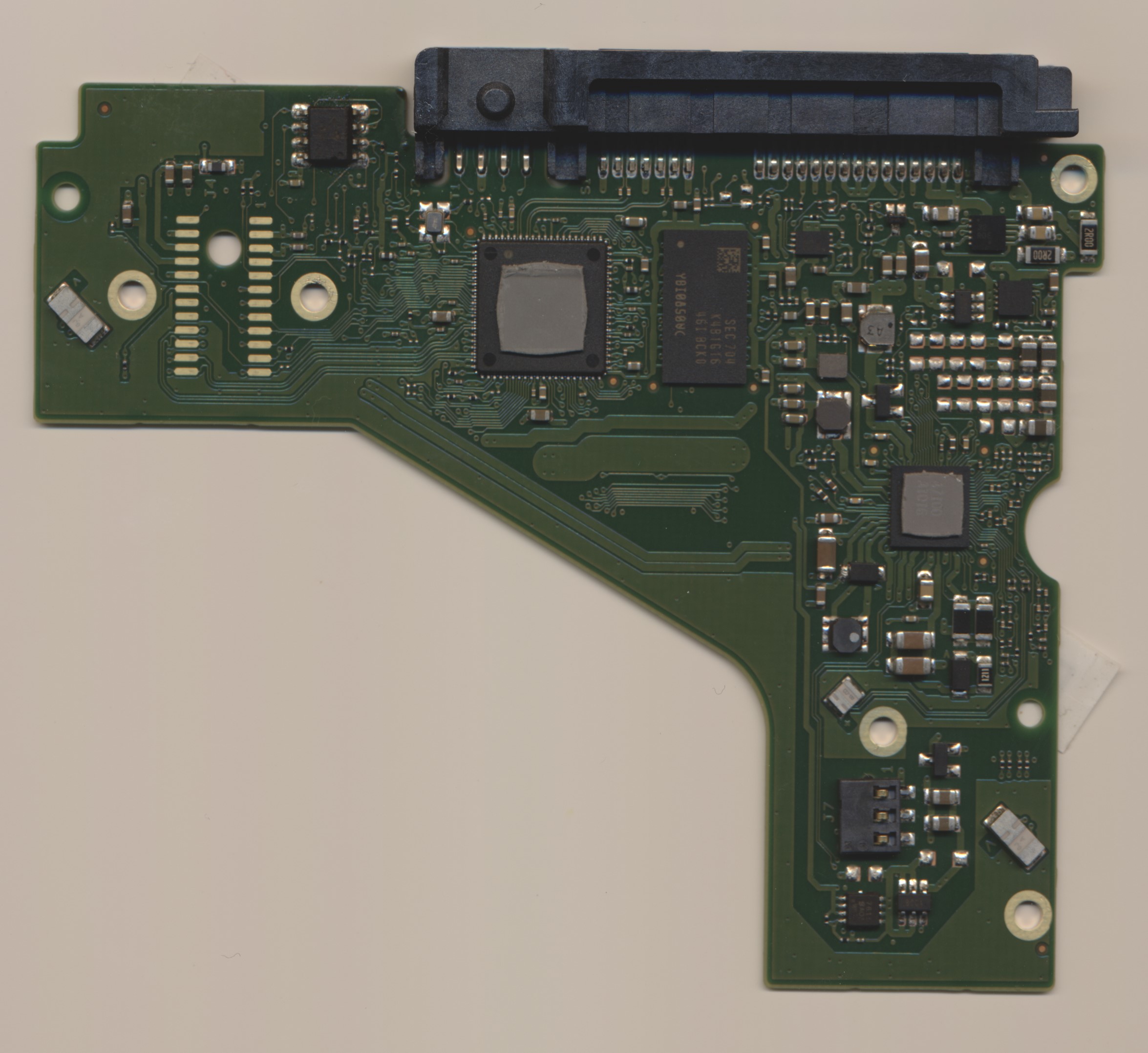

 Post subject: Re: Seagate Archive HDD Failure. No Crash, No Spin, Silent.

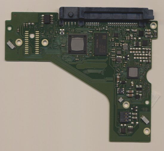

PostPosted: May 7th, 2021, 6:34
Posts: 1312
Soldering is fine just a little heavy. Chip doesn't look cooked to me.
I've only seen rom problems cause no spin a handful of times, I'm sceptical. Pepe you have more experience that I do - if it does end up with you drop an update here for us - I'm curious.

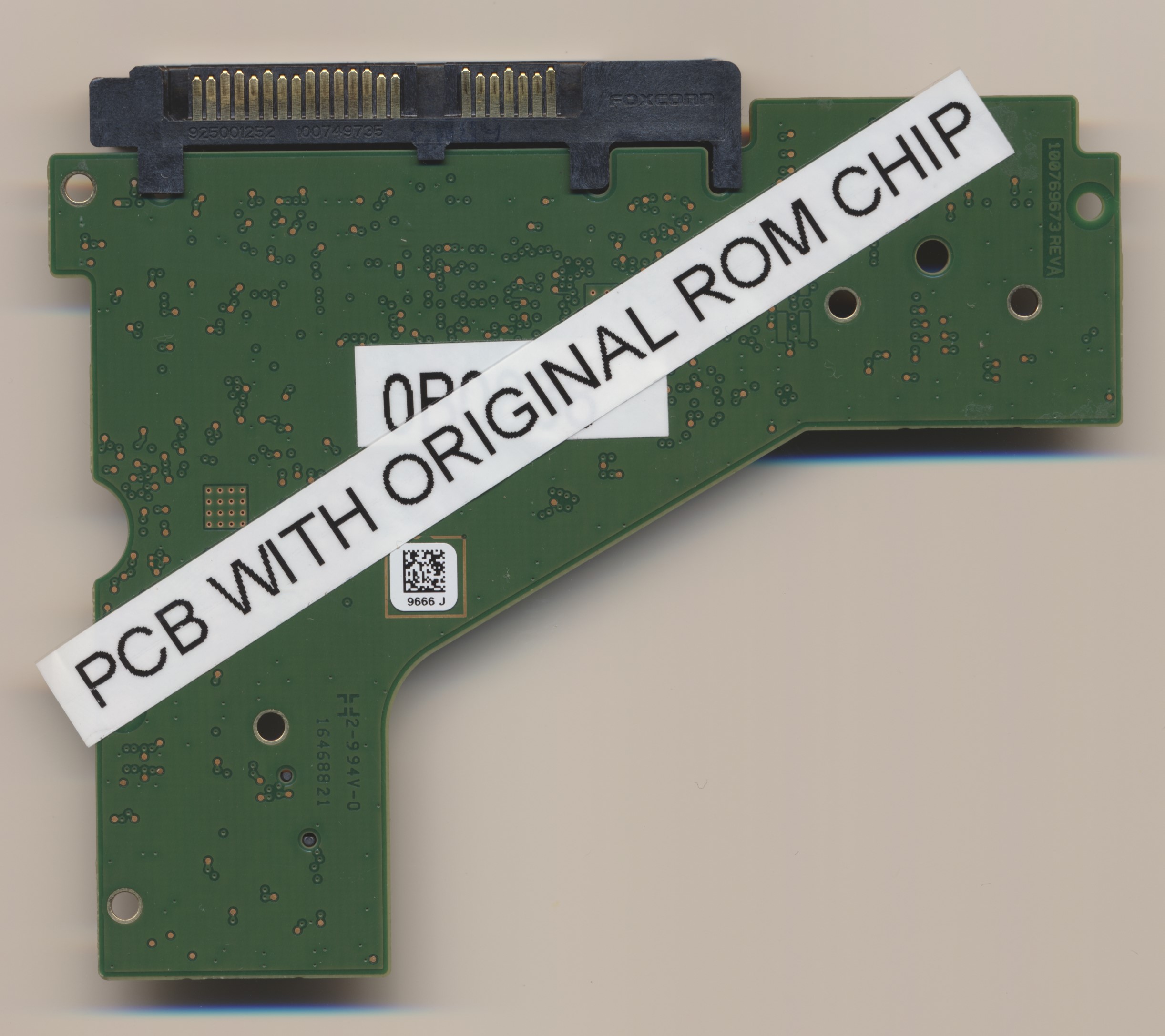

PostPosted: May 7th, 2021, 9:10
Joined: April 20th, 2021, 5:39
Posts: 82
Location: America

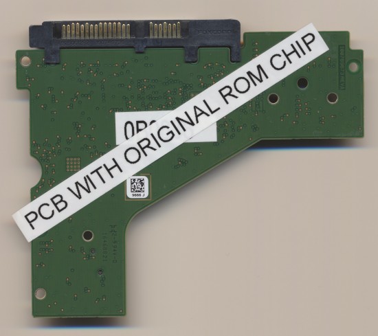

Also, when I have the donor board and a random bios on the hard drive and I plug it in directly to the motherboard and boot into Ultimate Boot CD. I think it can see the disk everything says: zero, zero, zero, i.e. clusters, size, etc. Not sure if I can enabled or disable PUIS when the drive is in this state. I mean None of the programs can read the drive or do a scan.
If I plug in a new board with original bios information the drive is dead and doesn't even spin up or turn on.
How is this happening, can a corrupt rom leave the drive completely dead and powerless and not even turn on?

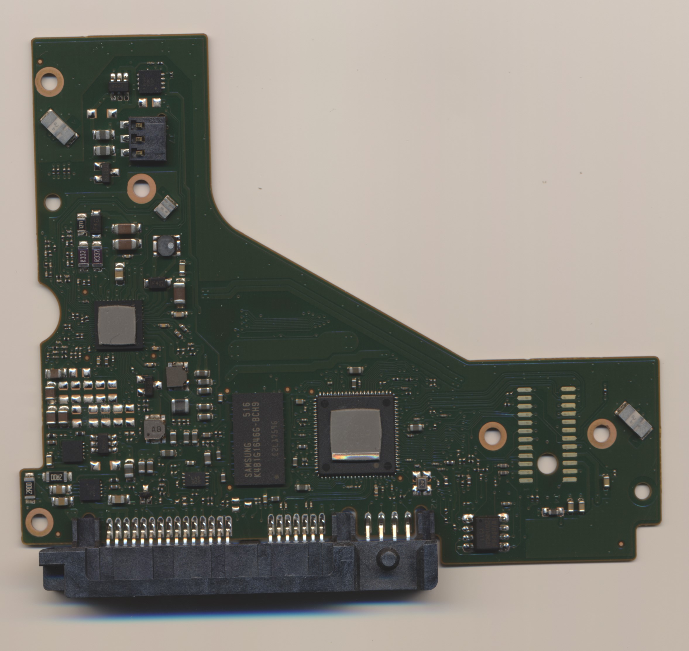

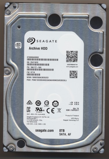

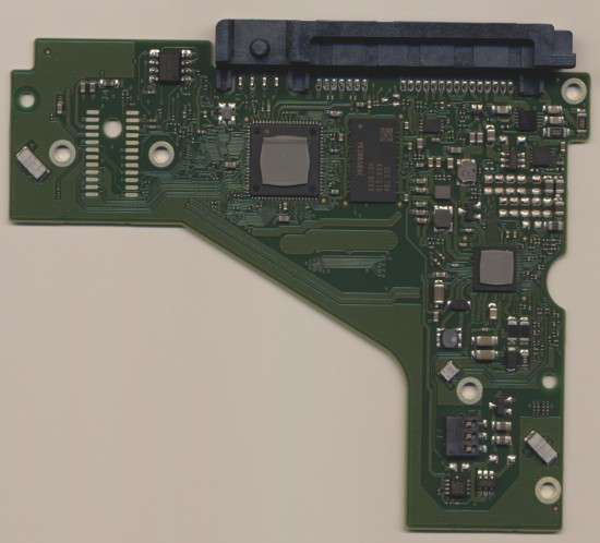

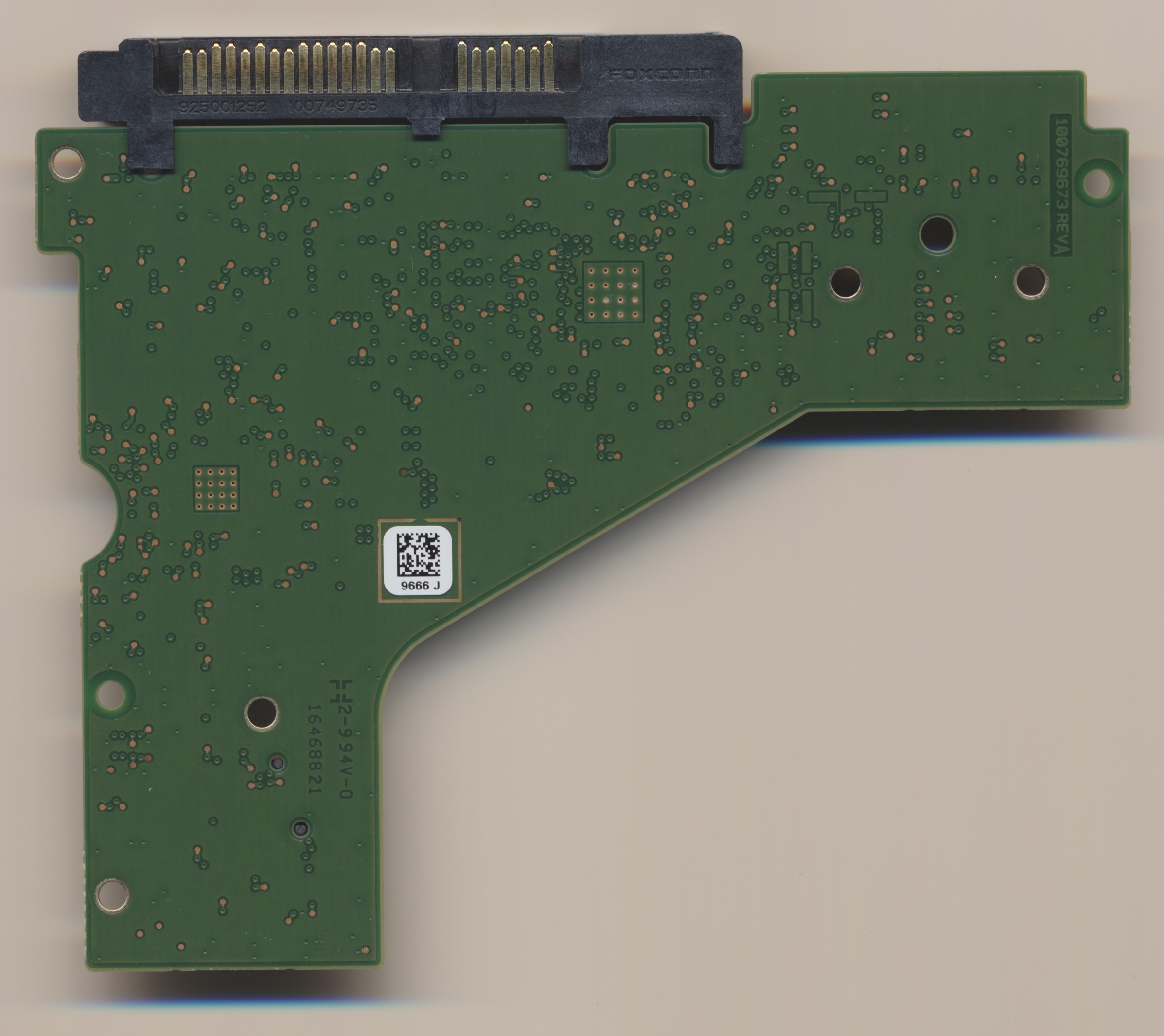

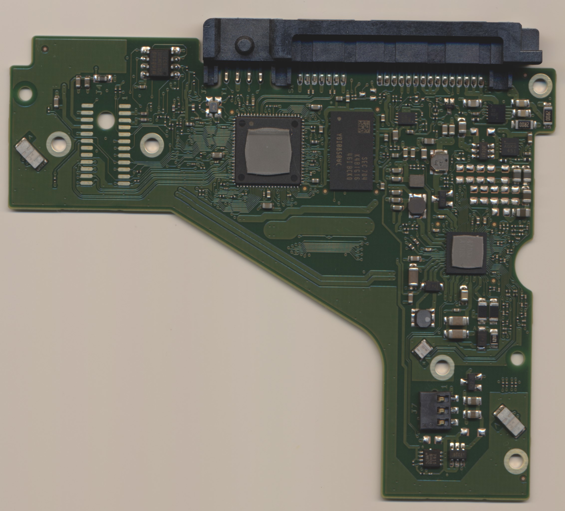

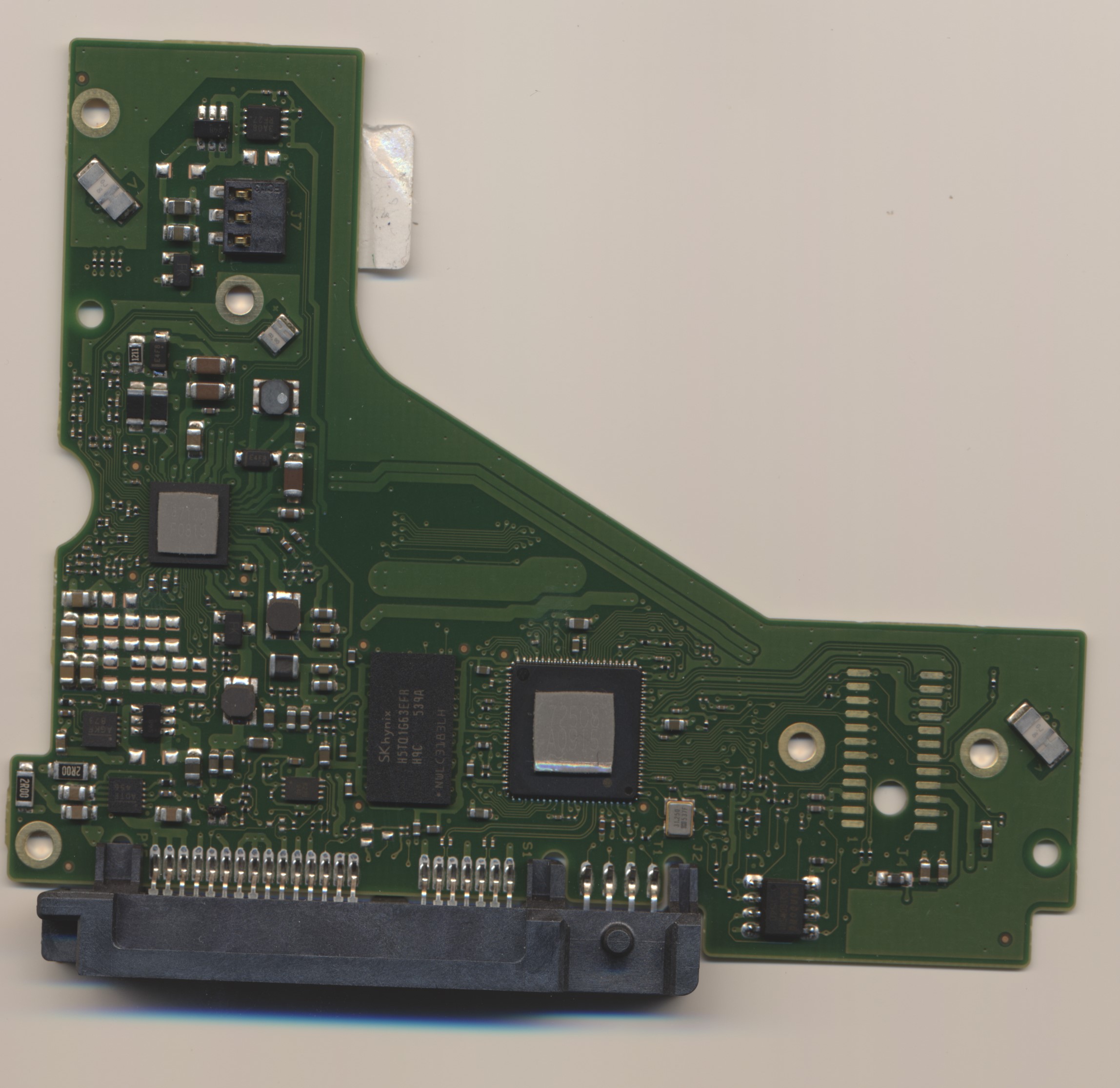

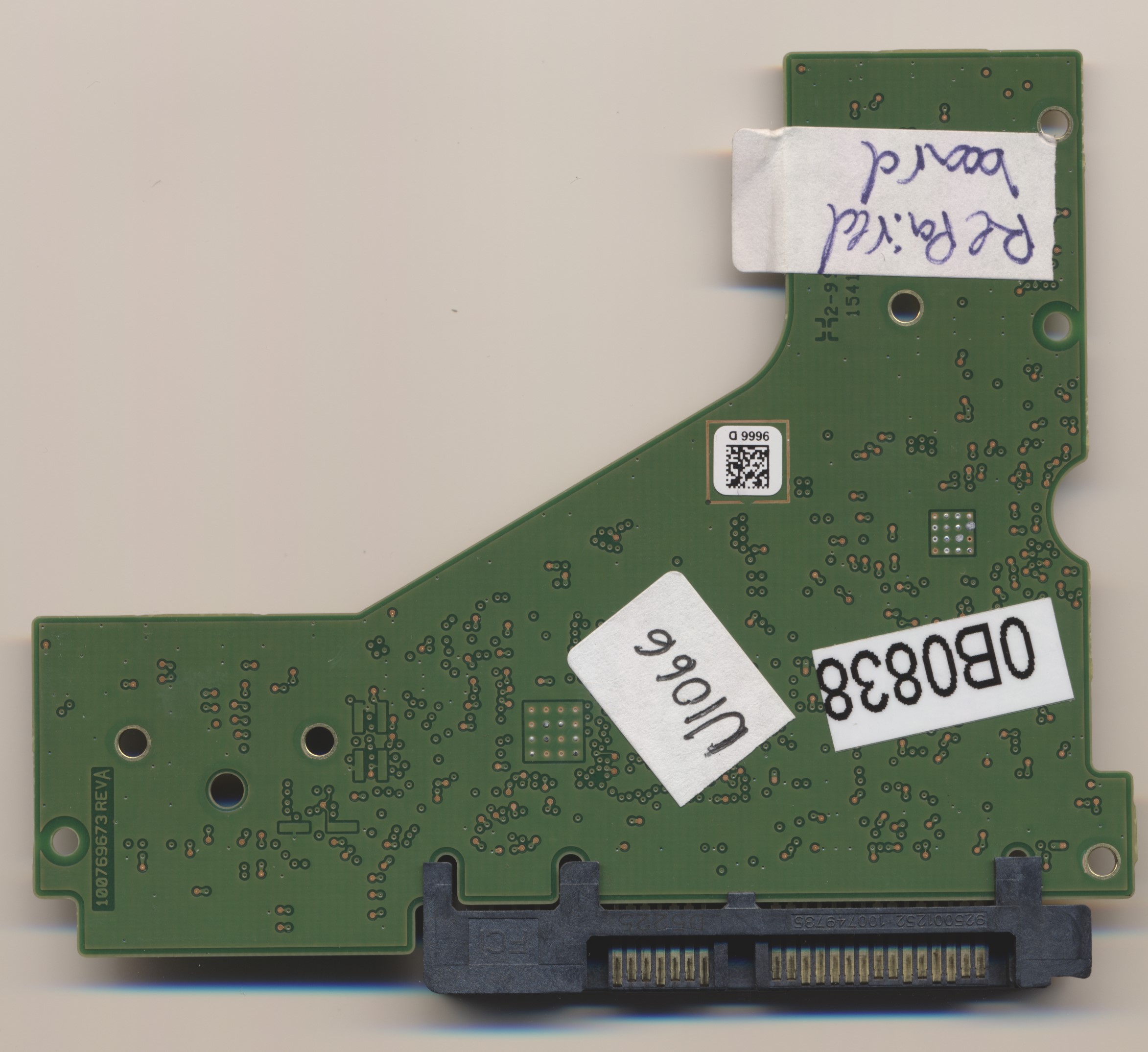

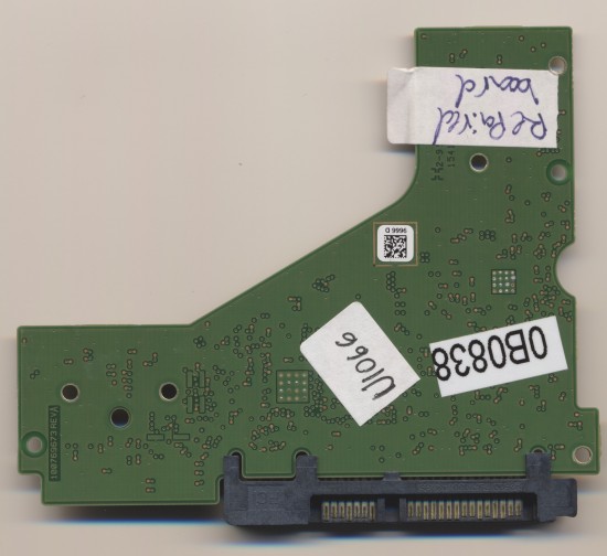

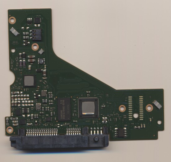

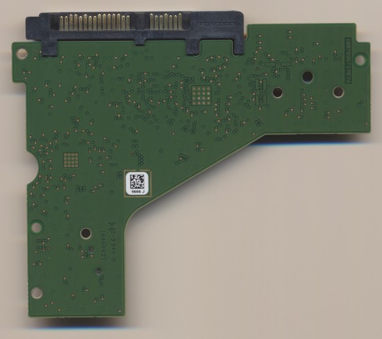

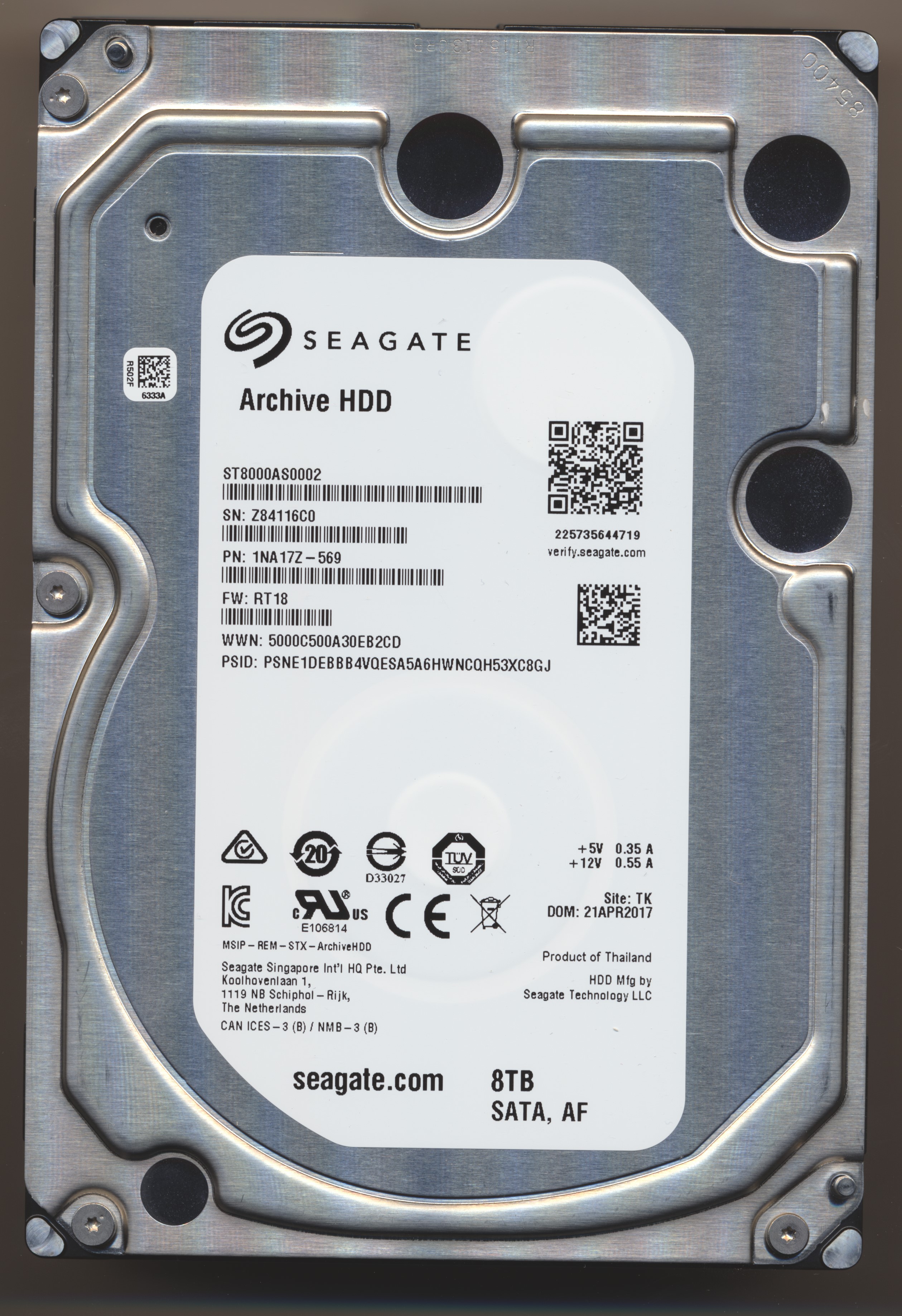

PostPosted: May 7th, 2021, 10:28
Posts: 82
Location: America

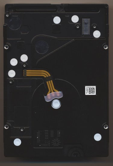

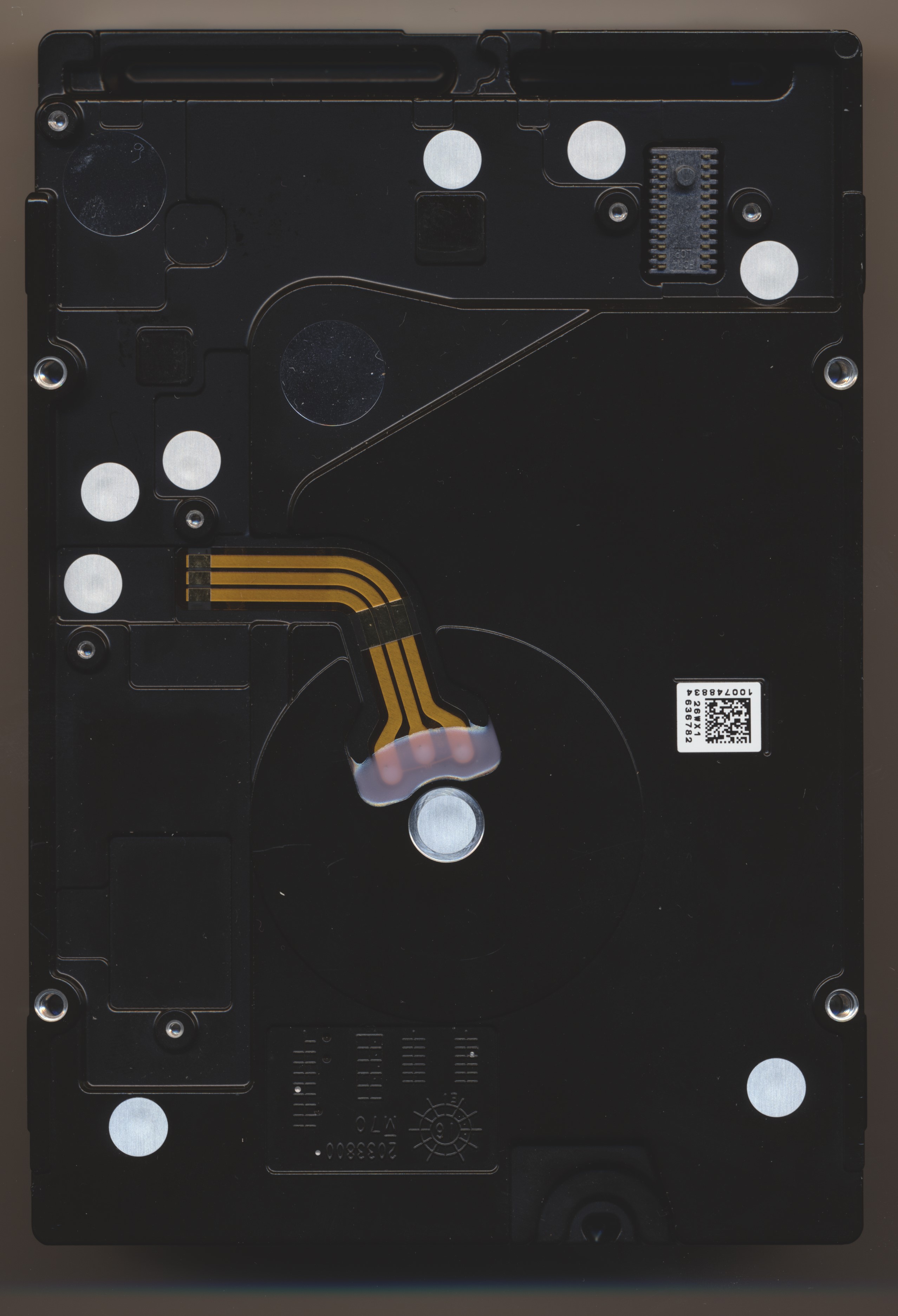

Hard Drive
Original Board and Bios before any repairs
New PCB Donor Board with BIOS transferred over to New Rom
Sound and Picture of Random Donor Board - 01
https://ufile.io/elb2l658
Sound and Picture of Random Donor Board - 02
https://ufile.io/04n9ku2q
State of original BIOS on Random Donor Board not Working

I didn't know how to upload .mp3 on here so I used that one site. Sorry. Also here are the windows errors I am getting with: Sound and Picture of Random Donor Board - 01

How do I find this out for you? I have a multi meter but I don't really know how to use it. Give me some general information and maybe I can get this info for you.

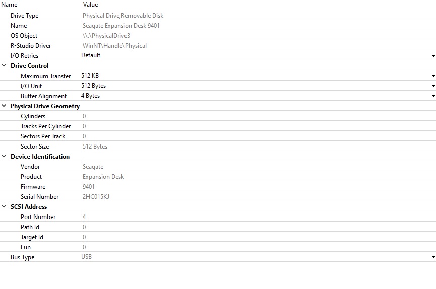

PostPosted: May 7th, 2021, 12:52
Posts: 1312

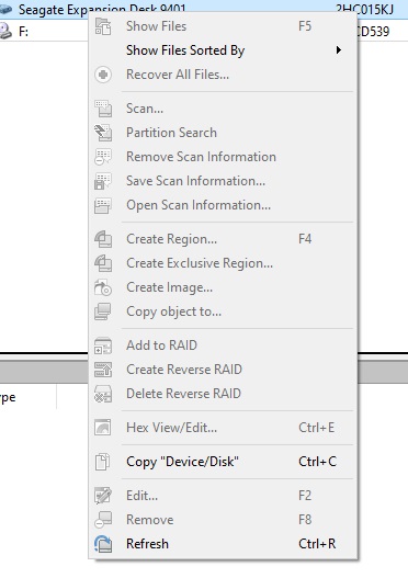

The windows screenshots suggest you have physical access to the drive. It's spinning and initialised you just can't see the logical data.
Download and run the r-studio demo and see if that finds anything.

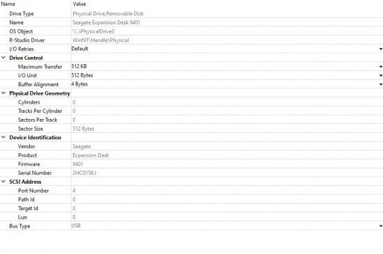

PostPosted: May 7th, 2021, 13:08
Posts: 82
Location: America

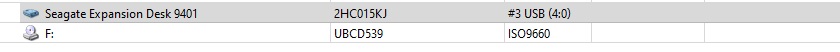

Just did as you requested and this is what I got:

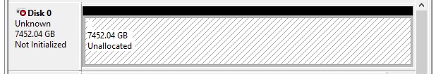

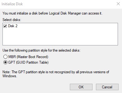

However, I can't do anything. Whenever I tried to convert to GPT disk before I always got i/o error can't communicate with disk. I don't think windows is properly communicating with the hard drive. This is a random pcb board and bios. However, seeing this drive listed properly in R-Studio is refreshing.
I haven't haven't recently tried to Initialize the Disk by creating a GPT - GUID Partition Table because I know that will erase my data. However, I wonder if that would work now?
What does all this mean?
PostPosted: May 7th, 2021, 13:22
Posts: 82
Location: America
It spins up but it does not initialize. It pops up in disk management wanting me to initialize and create a GPT partition. When I have done this before in the past once I click on GPT partition to initialize it would say i/o communication error.
PostPosted: May 7th, 2021, 13:24
Posts: 1312
Do not initialize it or anything else in windows.
It is looking like firmware causing the problem are you absolutely sure the drive does not spin with the original rom using either the donor or original pcb. You really need the right tools to fix the firmware if that is the case or a potential pcb hot-swap after but at the risk of shorting....
Just check connect it up with the new donor and check in rstudio.
