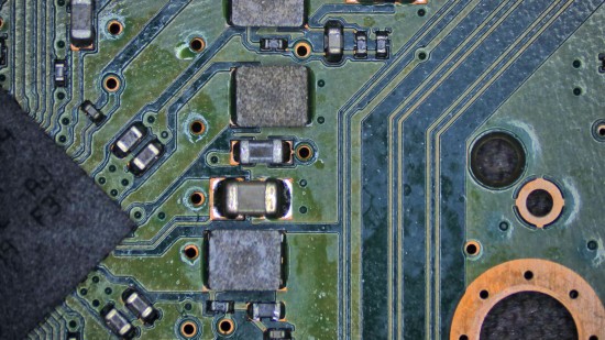

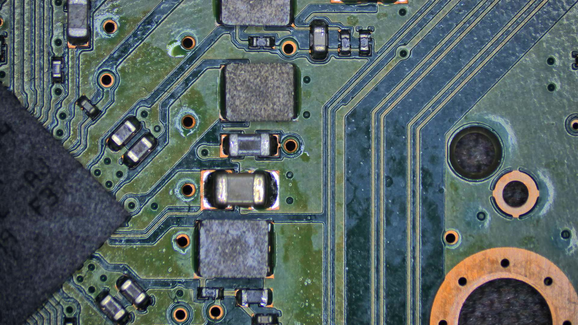

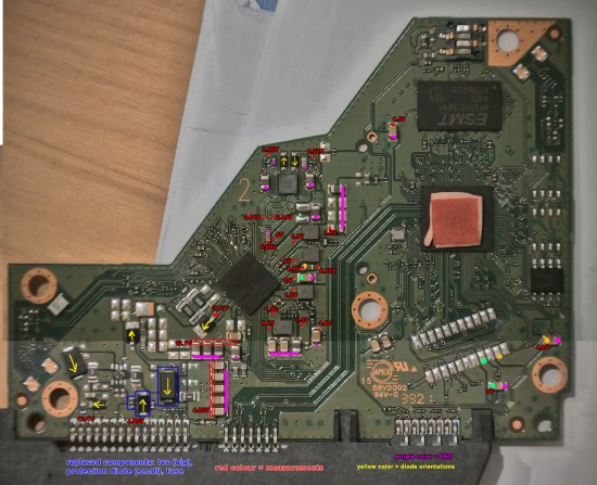

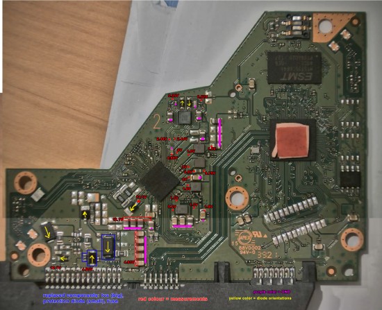

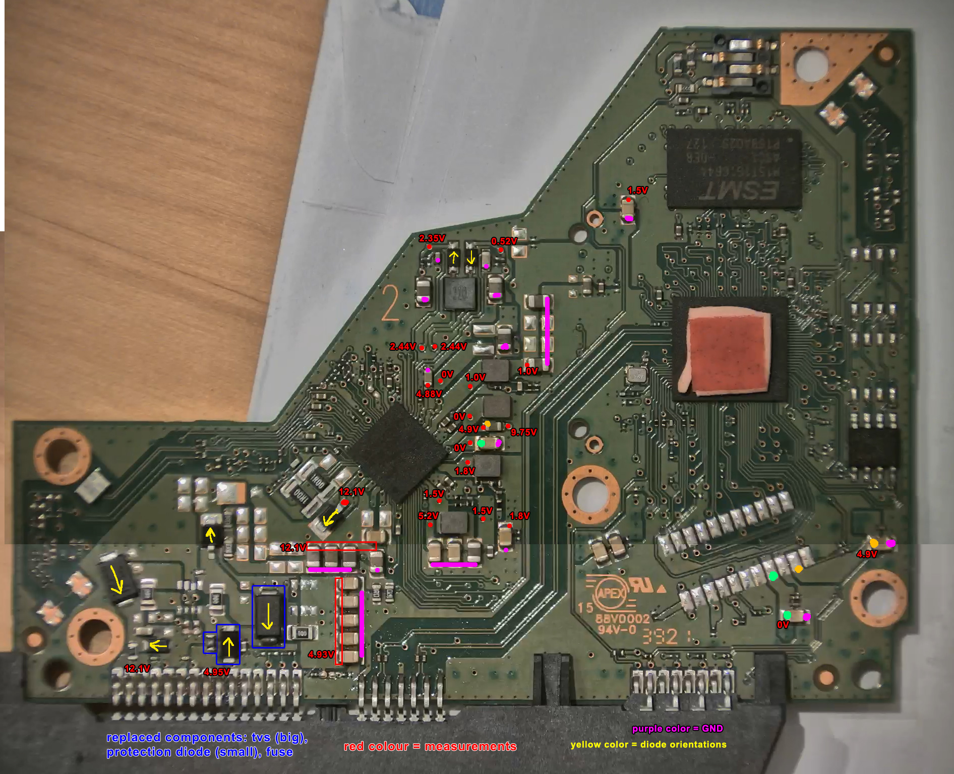

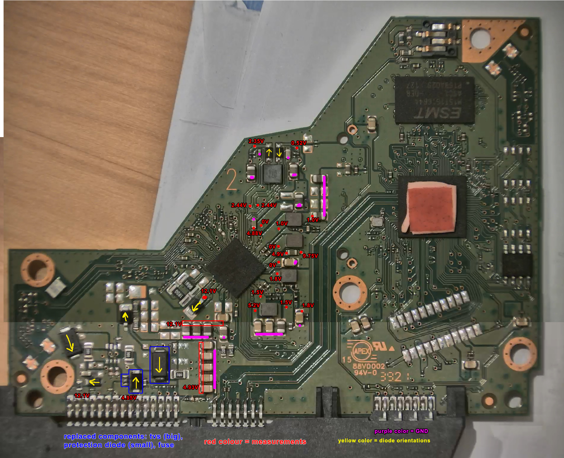

I have a similar issue as OP on the same board, though with different components (eg. I dont have electronic fusem, only have 1 ROM IC and all my inductors look like inductors -- ie. have uniform casing).
In my case the fault was most likely caused by multiple failures -- first a voltage spike, followed by a short and 12V supplied to the 5V rail (don't ask how, don't ask why ;-)).
The 5V fuse was fried and the TVS was shorting the 5V rail to GND. I've replaced the fuse, TVS, and protection diode (it looked fine on the DMM, but I figured I might as well replace it anyway).
Still, the motor won't spin and the head won't move, but I see 200 mA being drawn on the 5V rail (constantly). I don't know if any current is drawn from the 12V rail because I have only one bench supply, and thus 12V is coming from a non-digital power supply (genuine MeanWell, so I hope it doesn't botch the results). I don't see any components heating up more than the motor IC itself (alongside the other "main" IC), to around 40°C.
I took some measurements (perhaps more than I should), but I figured it's better to take more than too few.
At this moment, I've reached a ceiling and I don't know how to move further.
I won't buy a replacement board because I don't care about the data on this drive -- I'm doing this purely for curiosity and the potential satisfaction of not having to throw this drive into a landfill!
 Post subject: Re: WRONG VOLTAGE - WDC 2060-810011-001 P1
PostPosted: April 16th, 2026, 13:25
Posts: 17327

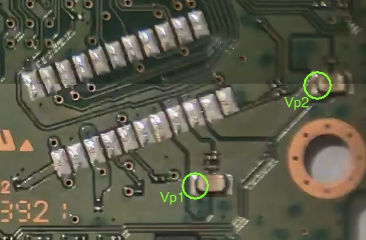

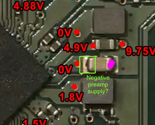

Can you tell us whether the preamp supplies are present? Many designs will switch on the negative supply briefly after power-up and then switch it off if the preamp is not detected. If this doesn't happen, then this would suggest that the MCU and motor controller are not communicating.
Can you verify whether the test point at the MCU is connected to either Vp1 or Vp2?
Edit:
I'm not sure which side of the Vp1 capacitor is grounded, so you might test both ends.
PostPosted: April 16th, 2026, 15:06
Joined: April 19th, 2011, 3:39
Posts: 17
So vp2 is ~5V and vp1 is ~0V. Can't tell if these values are expected so I'm just posting numbers and an updated image. I've also took the liberty of marking them with separate colours and an zoomed in section around these components.
1) The part between 4.9V and 9.75V is an inductor? I wonder what account sfor this voltage split in half on both ends, while all other inductors show output voltage on both ends. I assume this may have sth to do with me measuring it with DMM instead of scope?
2) You asked to test endpoints between MCU (I guess you meant the IC in the middle - motor controller?), not the IC on the right (with thermal pad)?
in any case I couldn't find path from either vp1 or vp2 to the IC with thermal pad test points. The ones I've found were close to the IC in the middle, however I'm not sure if they are connected to the IC itself or only in close vicinity.
Sorry if I missed something
