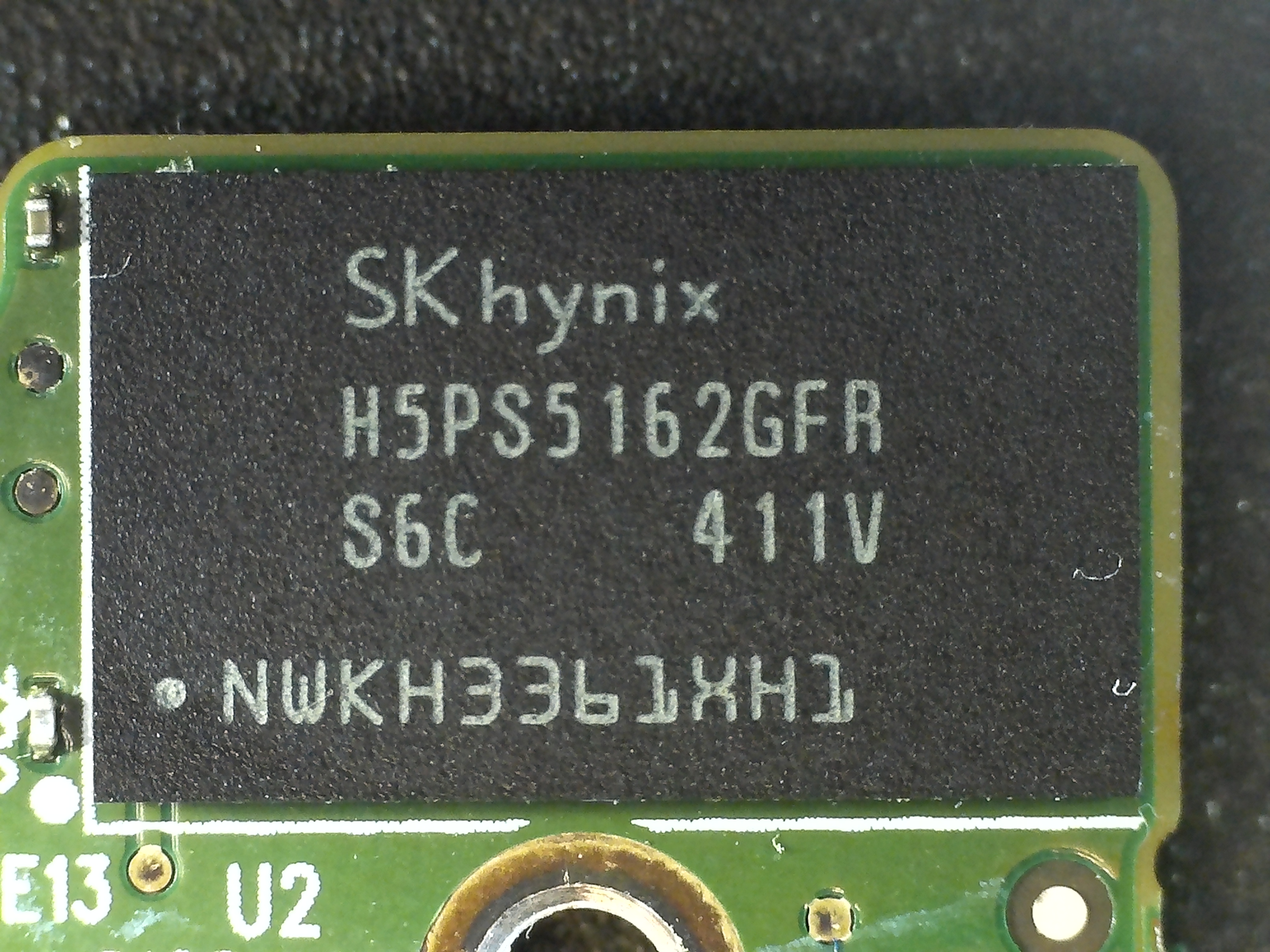

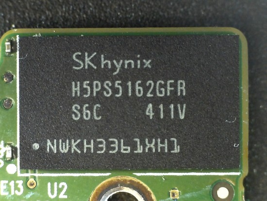

What is under the 771980 sticker on the main PCB?
Hynix H5PS5162GFR-S6C - 512Mb DDR2 SDRAM

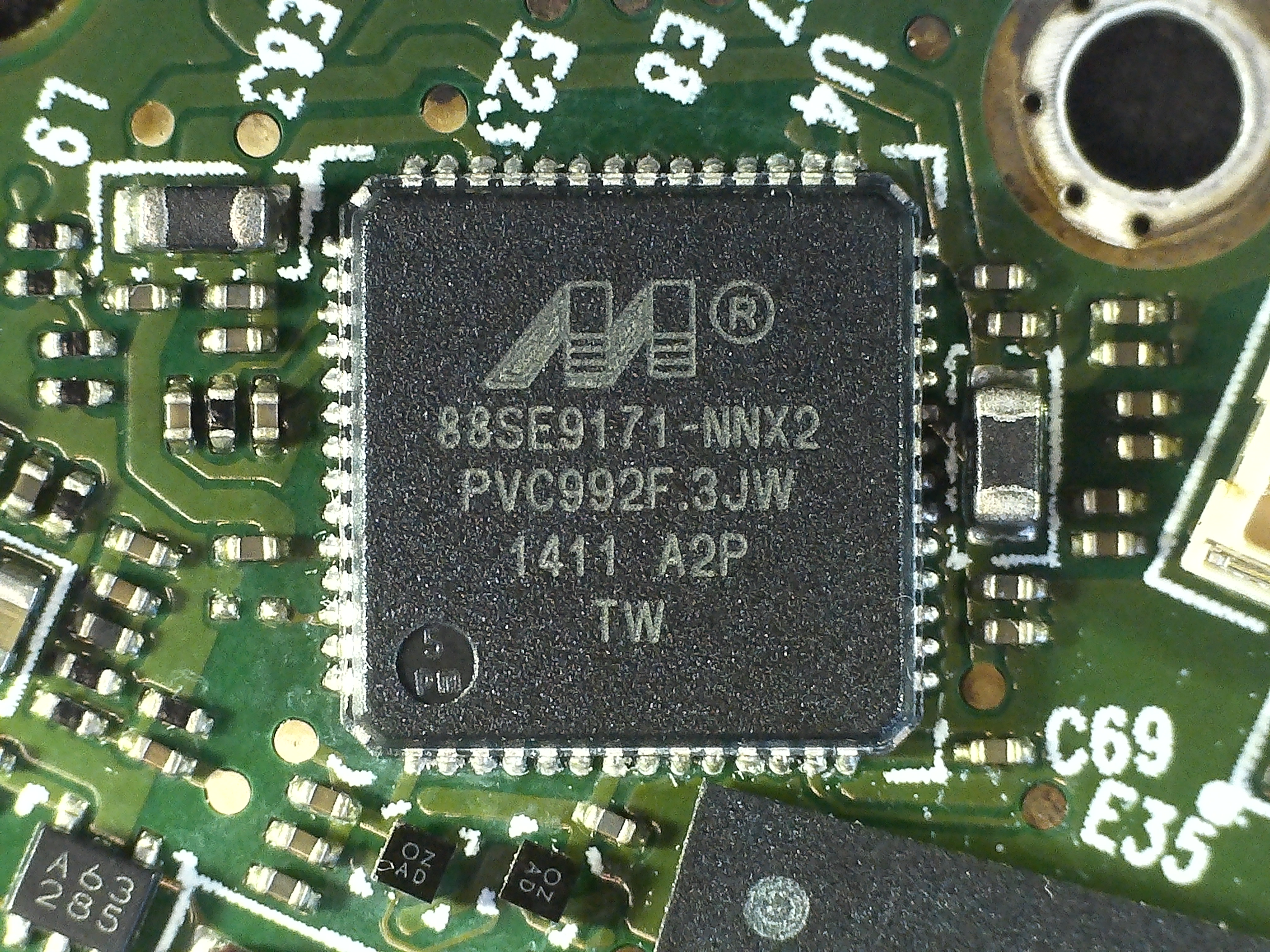

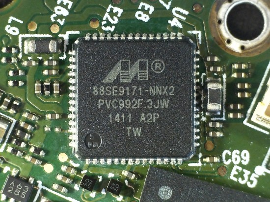

Marvell 88SE9171 - One-Lane PCIe 2.0 to One-Port 6 Gbps SATA I/O Controller

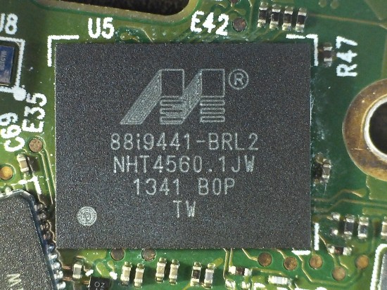

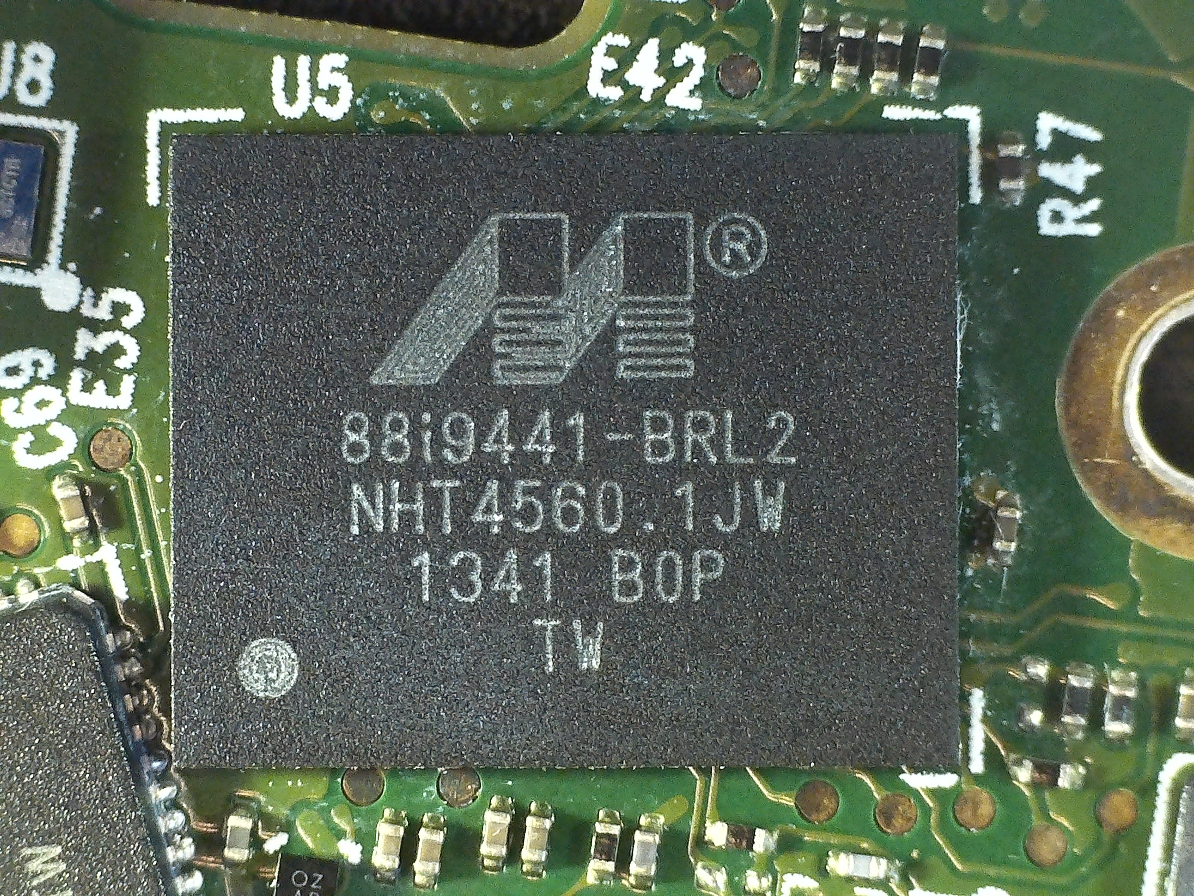

Marvell 88i9441 - Soleil-H SATA SSHD Controller 6Gb/s SATA, Dual ARM On-Chip Processors, Encryption

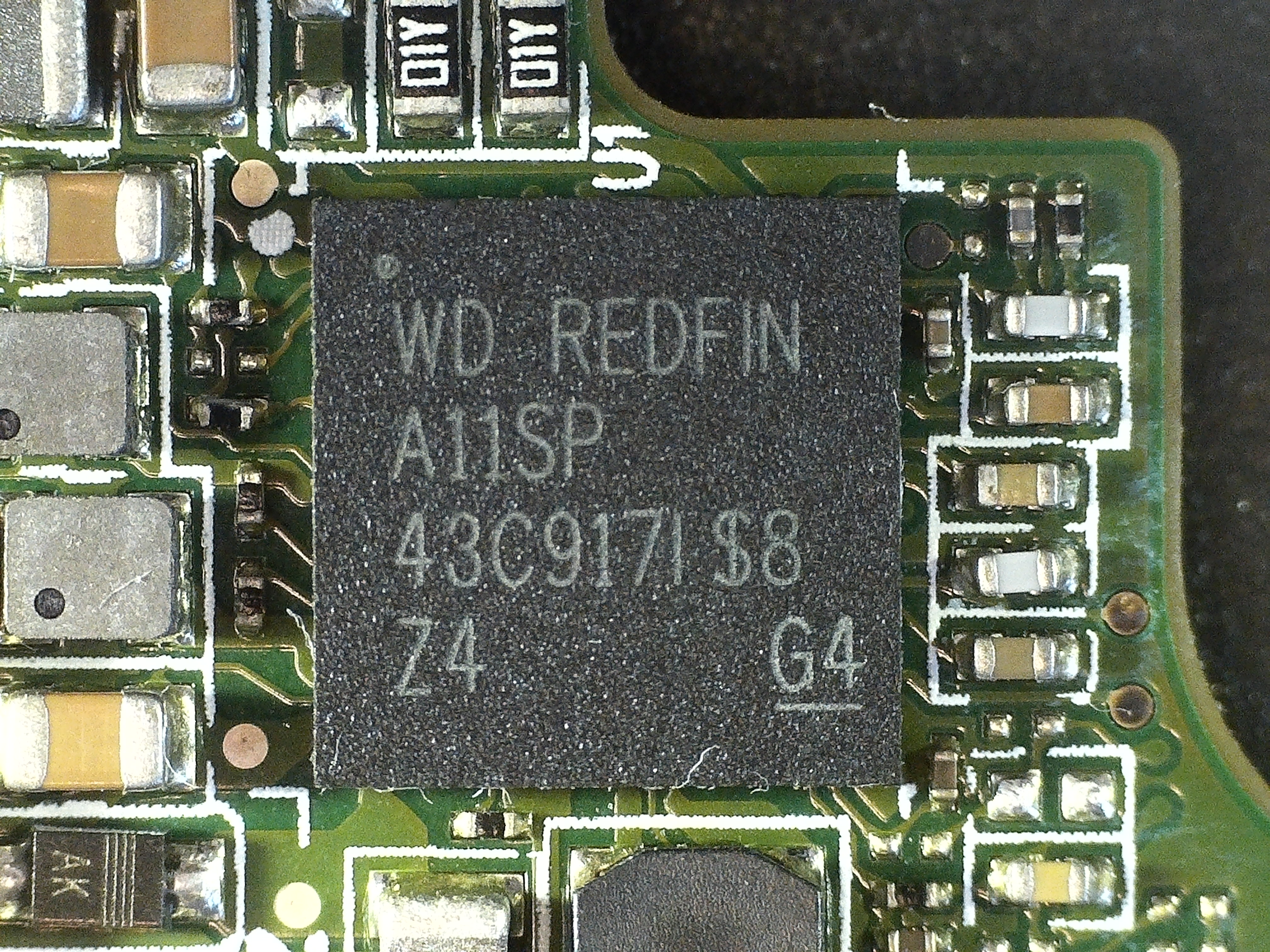

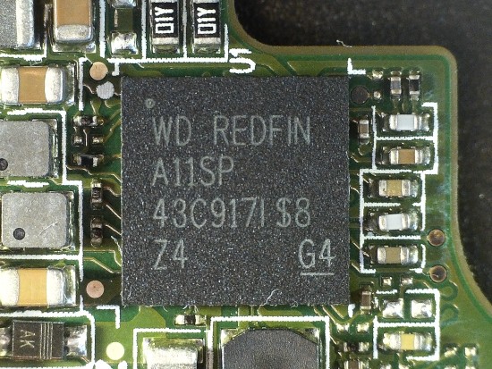

WD REDFIN A11SP - Motor Combo IC

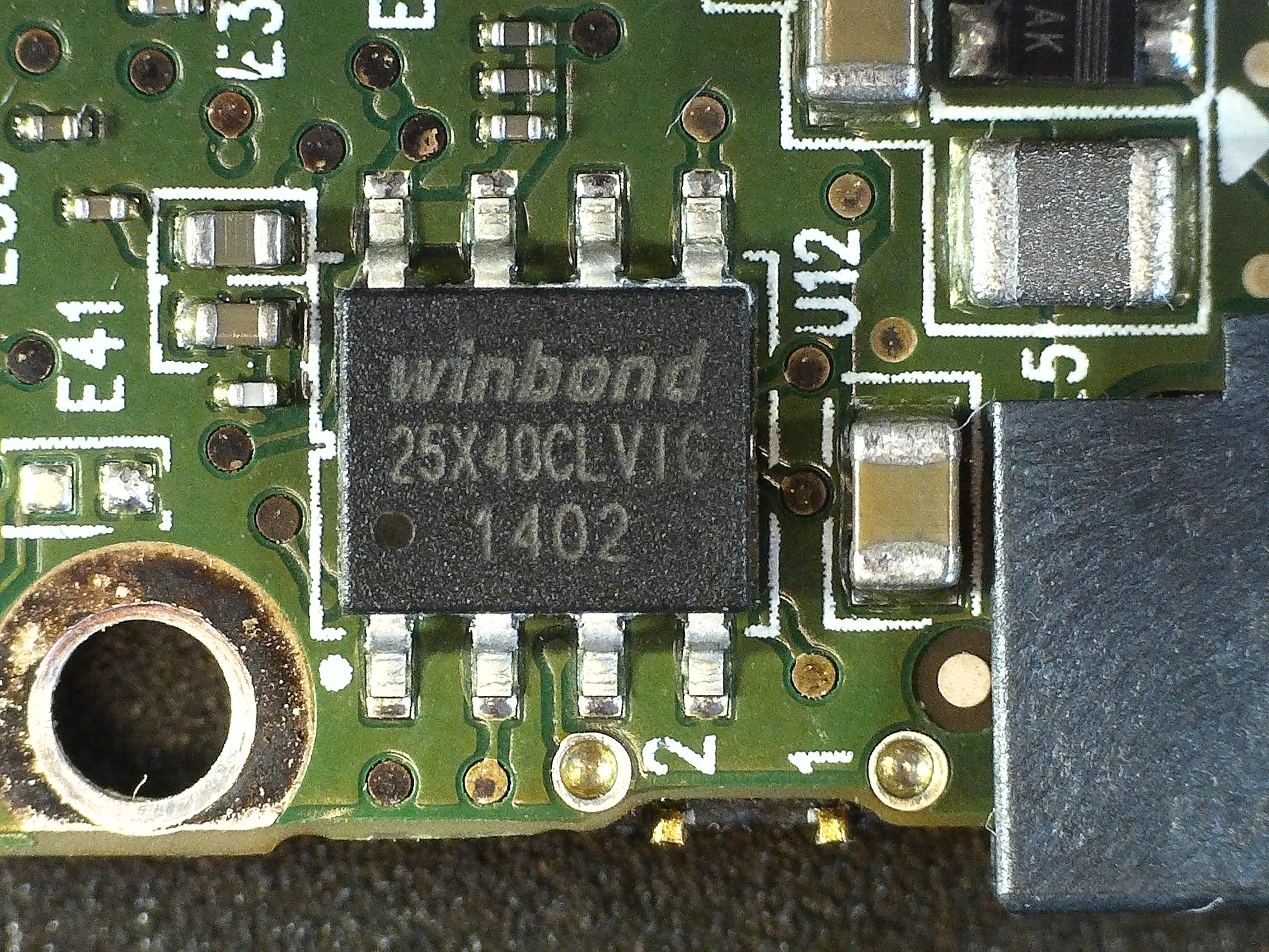

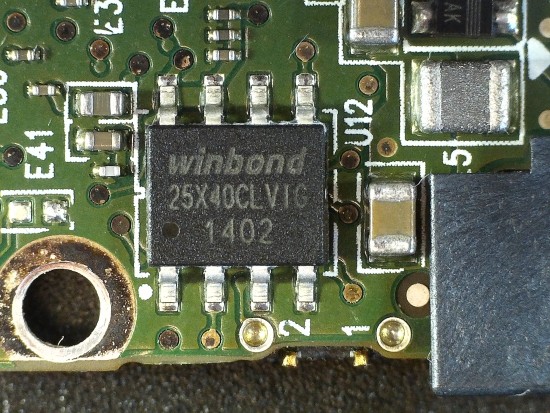

Winbond 25X40CLVIG - 4M-bit 2.5V Serial Flash Memory with uniform 4KB sectors and Dual SPI

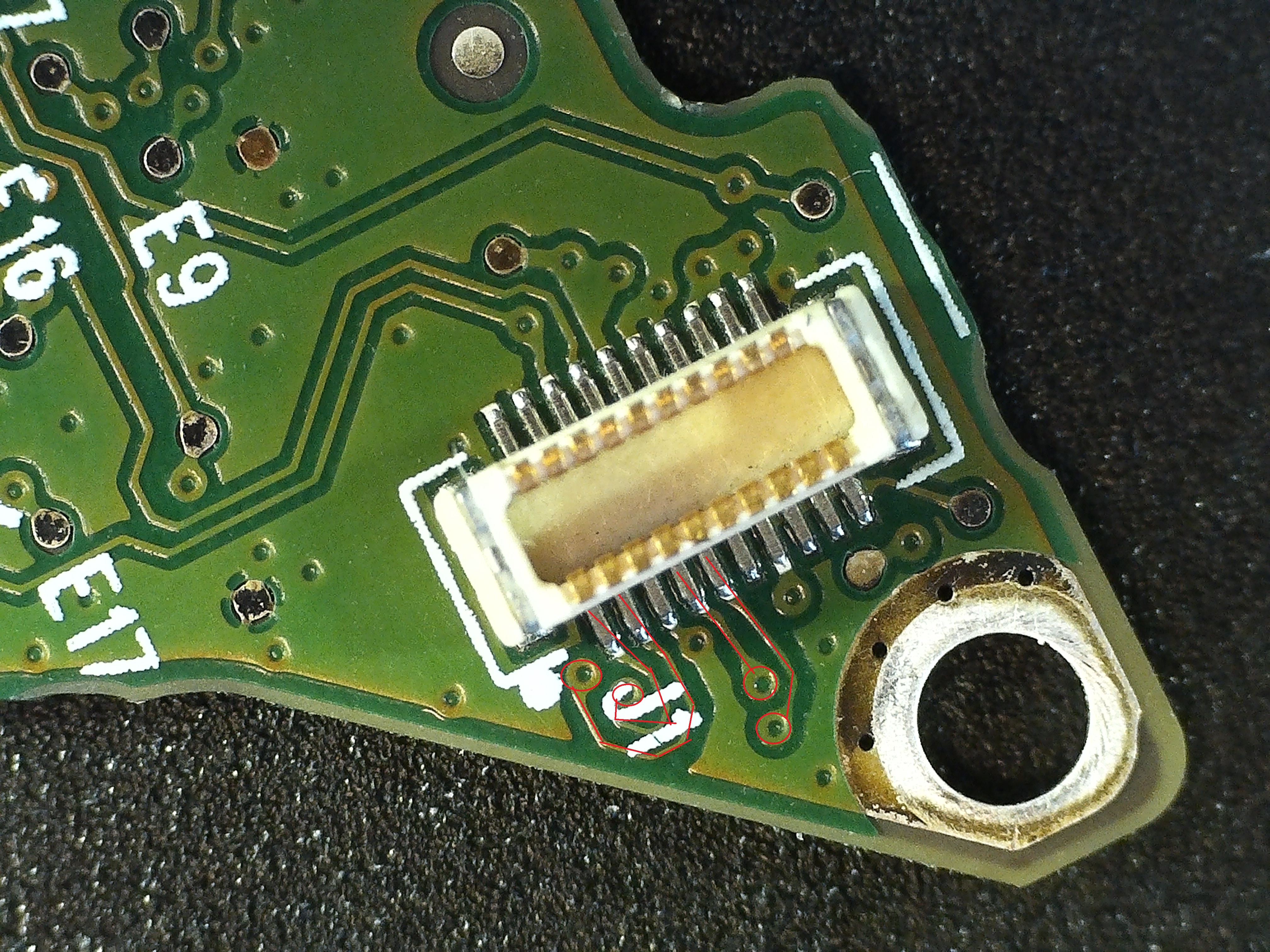

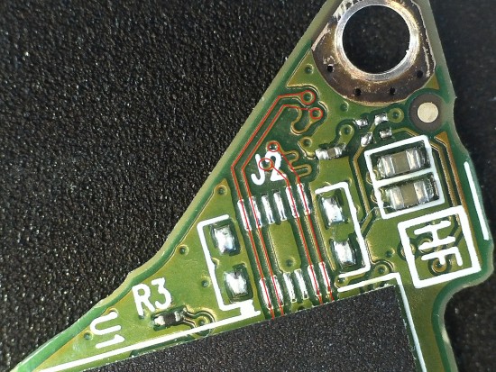

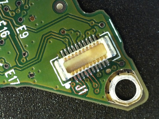

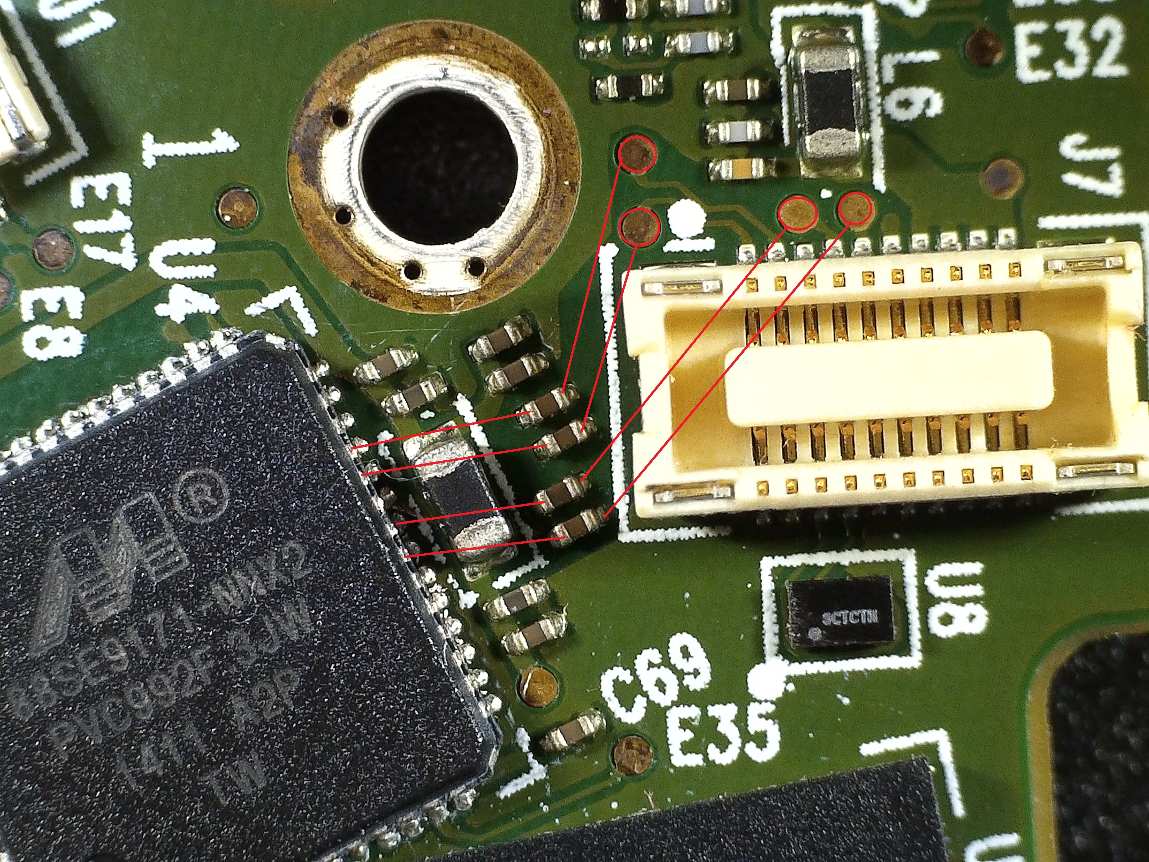

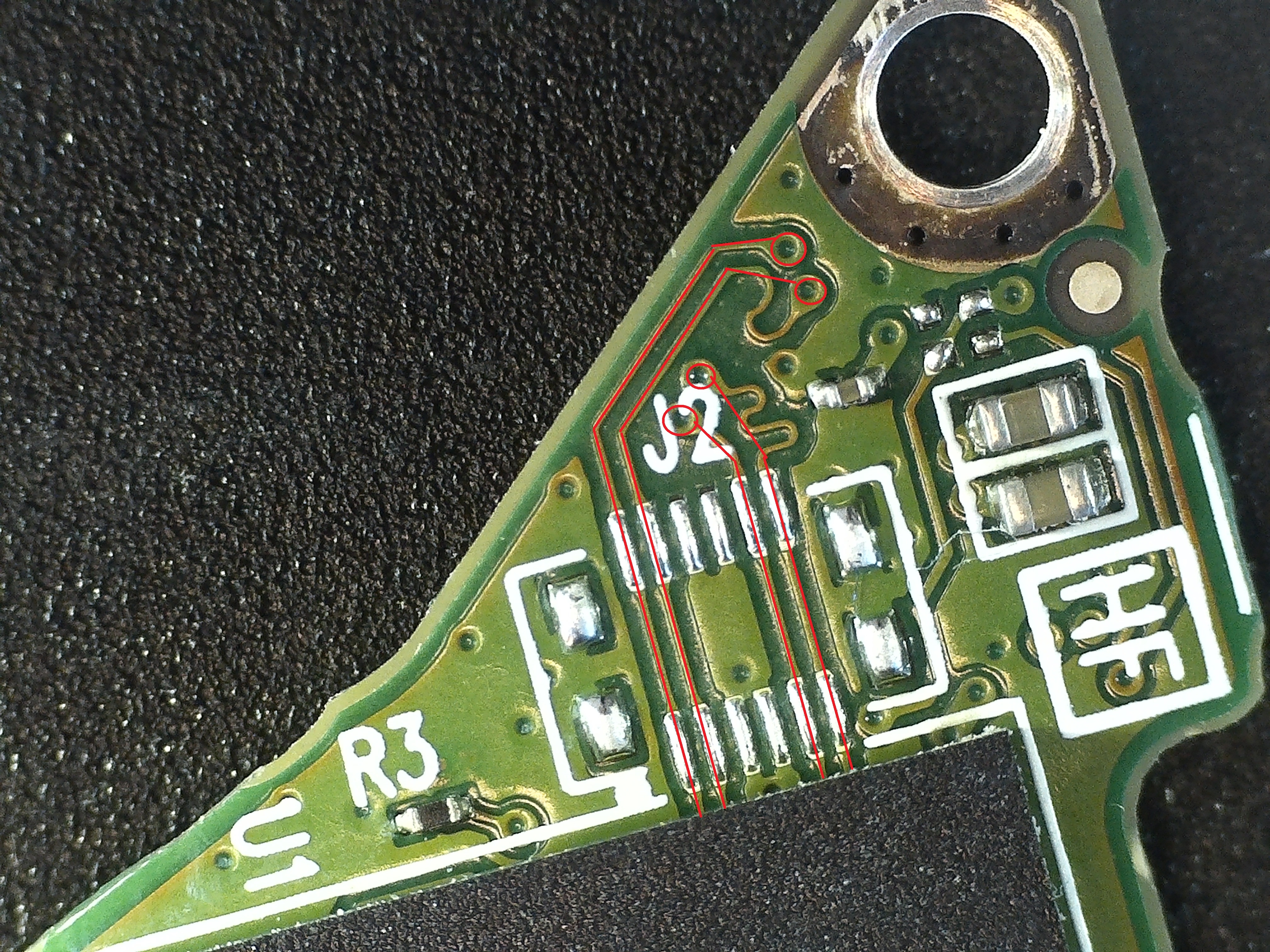

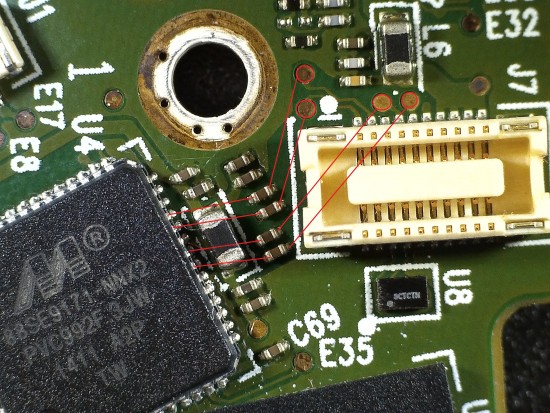

The SSD SATA lines come out of SSD
Than go to the other side of PCB into the connector
Than to the main PCB and into Marvell 88SE9171 chip.
I could not find where the main SATA port lines go even thou i beeped all the components and pads on the pcb.

In addition to the SATA Tx/Rx differential pairs, there appear to be two signals connecting U8 ("3CTCTN") to J7. I don't know how, or if, these extra signals would affect "cheating".
