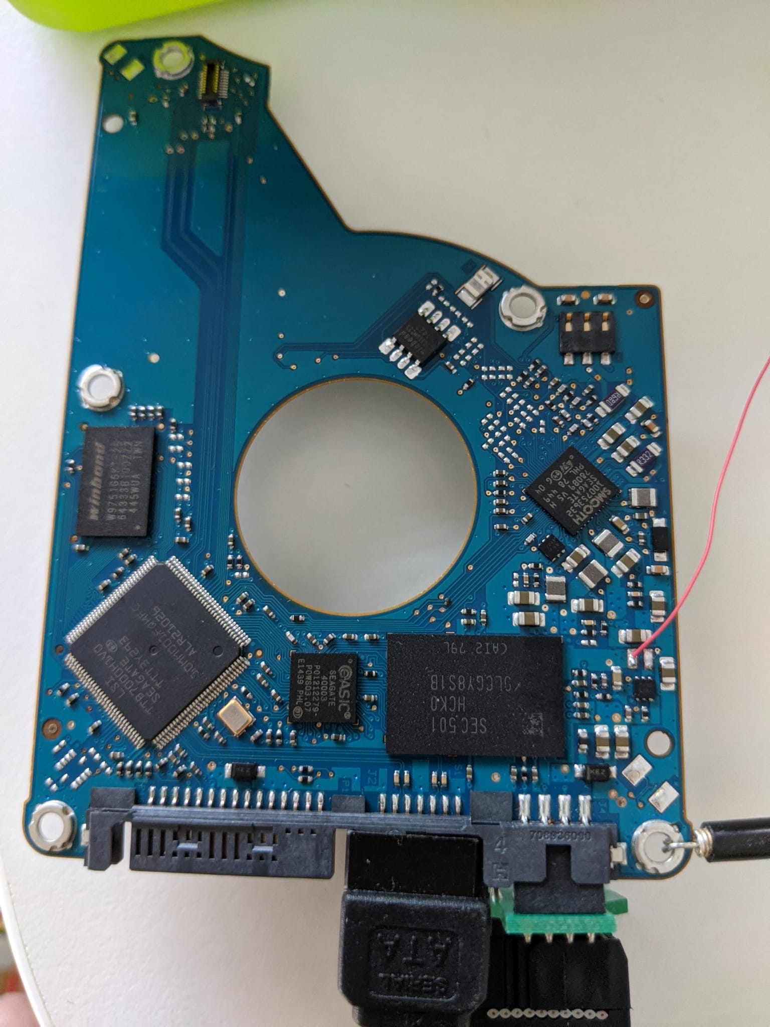

Injecting 3,3 V didn't help, still BSY and no terminal. I am looking for a donor PCB, yet haven't found one.

Just to check, you have removed the inductor and injected on the right hand side pad?
Did you measure the resistance to ground of the line before doing that, what was the value? this will show if the nand itself shorted to ground. Is anything on the pcb or the nand getting hot and what was the draw on the 3.3v you injected?

Line to ground = 210 Ohm.
When connected (PCB on HDD), PCB takes 0.045 from PSU.

I'm about out of ideas other than just blindly blaming the nand. I might bridge the 3.3 back to the other pad in case it's needed anywhere else but I doubt it. Needs the experience of a Senior member of Ace support I think, I be wary of just swapping PCB's :(

Would it worth using the ROM from an ST500LT032 to test the PCB? If the PCB then spins up the drive, we can be reasonably confident that the problem is with the NAND or ASIC. I'm assuming that both models have the same MCU and motor controller, otherwise this won't be a conclusive test.

I've found a cheap donor, I'll get it before end of the week, I'll keep you posted.

Drive works with donor. I'll compare voltage later.

You might like to measure the voltages on the tiny bypass capacitors surrounding the ASIC chip. To me it's not clear whether this chip needs a Vcore supply, or whether it runs solely off +3.3V.
