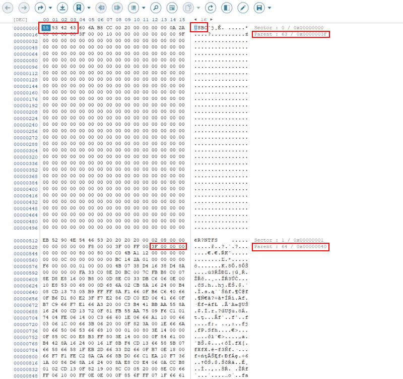

Arch Stanton wrote:
Speaking of which: Did you look at the PDF I linked to in Scott's group?
I made some observations in Scott's group. Basically I understand the non-deterministic sectors, but I don't understand why these would result in an offset.

Yeah, I initially assumed offset would continue on and on. However I still feel the offset is obvious in this example. NTFS BS itself tells us it's at LBA 63. It shifted by one sector.
I agree that an offset exists, I just don't understand the mechanism behind it. My understanding from the PDF is that a sector is replaced rather than inserted, but that is clearly not the case in your example.

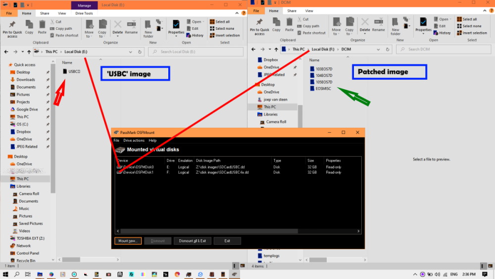

Yeah, nor in my new case in which case ROOT folder shifts.
Also note that the offset idea isn't mine, others mention it too. Example (translated) "Conclusion: The appearance of USBC sectors can indicate problems with the device, as well as cause biases in the data area. When recovering, it is recommended to conduct additional analysis and take into account the displacements (shifts) that they cause." - https://512byte.ua/articles/usbc-na-fleshke.html
