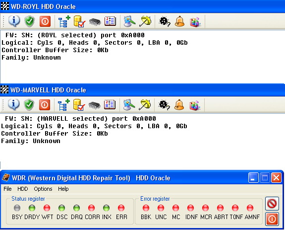

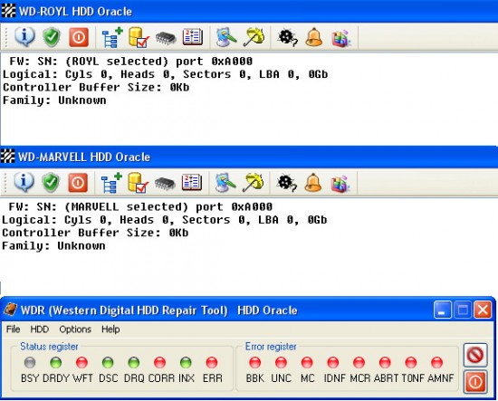

While I am waiting, I have tried to do a backup of the ROM which is embedded in the Marvell MCU of my damaged PCB.
I have used the WDR Demo v2.1 in order to this.
Of course, I have carefully followed the instructions given in the HDD Oracle Forum.
Here:
http://www.hddoracle.com/viewtopic.php?f=86&t=1127
http://www.hddoracle.com/viewtopic.php?f=32&t=33

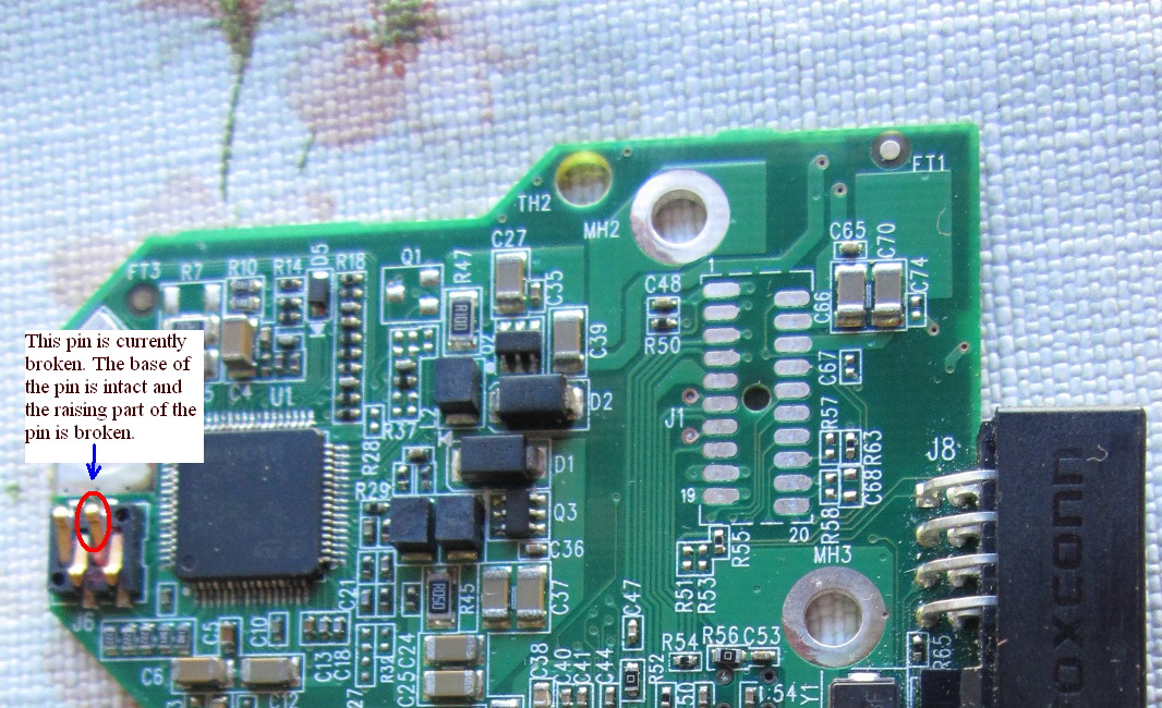

I have placed the damaged PCB (without the HDD) into a SATA power connector of the PSU. And also I have connected the SATA data cable between the SATA port of my motherboard and the SATA port of the PCB. But unfortunately, I have NOT been successful in doing the backup.
I have taken several screenshots in order for you to see the results.
Please, see "Picture #10 - Trying to backup ROM with WDR v2.1.jpg" that I am enclosing with this message.

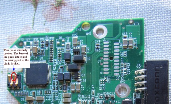

Again, I have accidentally broken a pin of the jumper plug J6 of the HDD PCB.
And now, when I try to measure the voltages on the four pins of J6. There is no voltages at all. (Of course, prior to this, I connected the PCB with the SATA power connector of the PSU).
I keep the broken part of the pin, but the problem is that it is very small and therefore it is very difficult to solder.
I have thought about glueing both pieces together. But I am afraid that if I do so, there will be no continuity in the fixed pin of J6.
Prior to this accident, there was a voltage in the 4 pins of J6 but only during the first minute. But now, there is no voltage at all in the pins of J6 (not even during the first minute).
In order to backup the ROM embedded in the Marvell MCU:
Is it really a problem that one of the pins of J6 is broken?
Thank you for your replies.
File comment: I have tried to backup the ROM embedded in the Marvell MCU with the WDR Demo v2.1.

Give another try with WDMarvel Demo, menu "ROM -> Read".
Looking at the LED and the empty drive ID, it's not sure that you have selected the right port in WDR.
Hoping that the PCB is not fall in a state that block you from reading the ROM...

Yesterday, I made several attempts and it is not recognized by the WDR Demo.
Therefore the PCB is failing.
Just in case the PCB gets totally damaged, I have not made more intents.

I have taken new measurements to the old PCB. I have measured the voltages after plugging the PCB into the SATA power connector of the PSU.
These are the current problems:
There is no voltage of 3.3 V (neither in transistor Q4 nor in transistor Q2).
Transistor Q4 gives a voltage of 0 V in its two pins (on the left and right) and a reading of 5 V in the middle pin.
Transistor Q2 gives a reading of 5 V in its two upper pins (on the left and right) and a reading of 0 V in its remaining 4 pins. (A few days ago, these mentioned 4 pins were giving a reading of 3.20 V. Now, all of them are 0 V).
There is also no voltage in pins #1 to #3 of the SATA power connector of the PCB. (Although this was already happening before now).
Pins #1 to #3: 0 V (it should be 3.3 V as far as I know).
The voltages from the other pins of the SATA power connector on the PCB are right:
Pins #4 to #6: 0 V (ground)
Pins #7 to #9: 5 V
Pins #10 to #12: 0 V (ground)
Pins #13 to #15: 12 V
I get 5 V in catode of diode D3 and 12 V in catode of diode D4.
Also I have noticed the following differences in comparison with the measurements I took a few days ago:
Transistor Q3 gives a reading of 5 V in its upper two pins (on the left and right). But it gives a reading of 0 V in the remaining 4 pins. (A few days ago, I had gotten a reading of 1.35 V at those 4 pins. But now, all of them read 0 V).
The voltage before and after resistor R45 is 0 V (a few days ago I had gotten readings from 1.20 to 1.30 V). But now, I get 0 V.
[Note: I have also measured the resistance of resistor R45 (selecting the scale of 200 ohms) and I got a reading of 0.7 ohms. (By the way, it is necessary to take into account that the multimeter resistance is 0.5 ohms. Therefore the real resistance of R45 is 0.2 ohms)].
Also I get no voltage before and after inductor L2. (A few days ago, I got readings of 3.20 V).
[Note: By the way, I have mesured the resistance of inductor L2 and I got 0.5 ohms and since the the multimeter resistance is also 0.5 ohms. Therefore, I suspect that inductor L2 is shorted].
I also get a voltage of 0 V (both in the anode and catode of diode D2). [Note: A few days ago, I got readings of 3.20 V in catode and anode of diode D2].
When measuring the resistance of diode D2, I get the following results (selecting the scale of 200 k-ohms):
61.8 k-ohms (i.e. 61,800 ohms): red probe to its catode and red probe to its anode.

Again, I have measured the voltages of the 4 pin legs of J6 (i.e, the motor connectors of the PCB).
Because, as stated in my last message but one, I accidentally broke a pin leg of J6.
The base of such a pin is intact but its raising part is broken,
[Note: I am enclosing a picture where the broken pin leg is circled in red. See picture #11].
I got the following results when measuring the pin legs of J6:
There is no voltage at all in any of the pin legs (not even during the first minute just after powering up the PCB).
Currently, 0 V at all the 4 pin legs (all the time).

File comment: The base of the pin is intact but the raising part is broken. I have circled the damaged pin in red.
