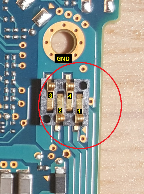

What resistance do you measure between the common motor terminal and ground on your PCBs (with motor disconnected)?

What a shame that that older thread about those Ultrastar A7K2000 drives never got resolved. :shock: The symptoms sounded very similar to what I'm experiencing with these two A7K3000 drives now (one of which should've still been in excellent condition and had very low mileage).

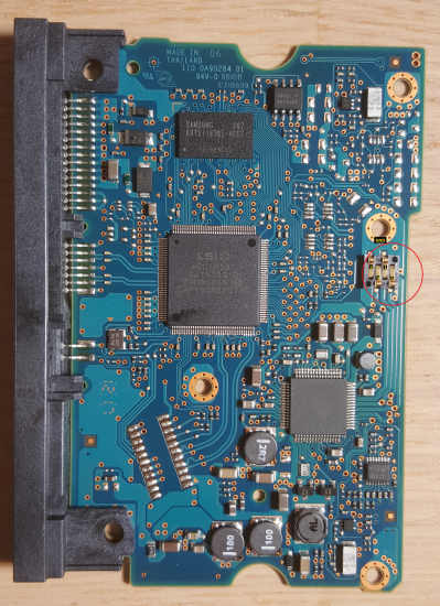

In other words, check the PCBs of the two non-working drives and the PCB of one working drive, by removing the PCBs from the drives and measuring between pin 1 and GND (see the pic), while not applying power?

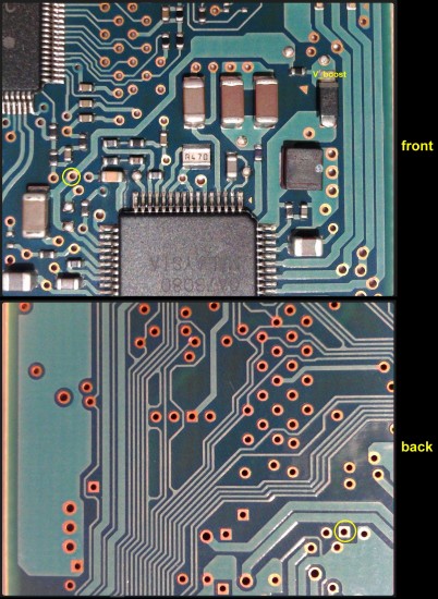

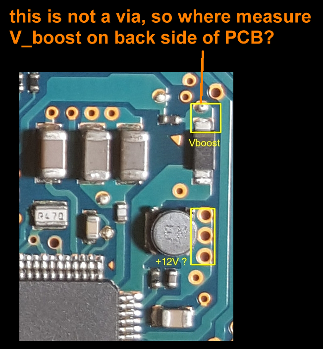

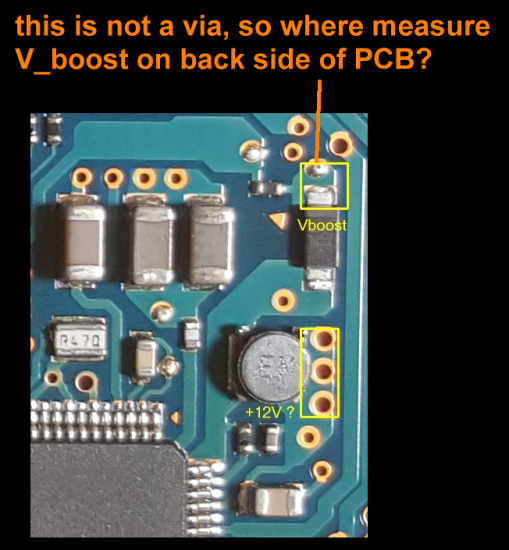

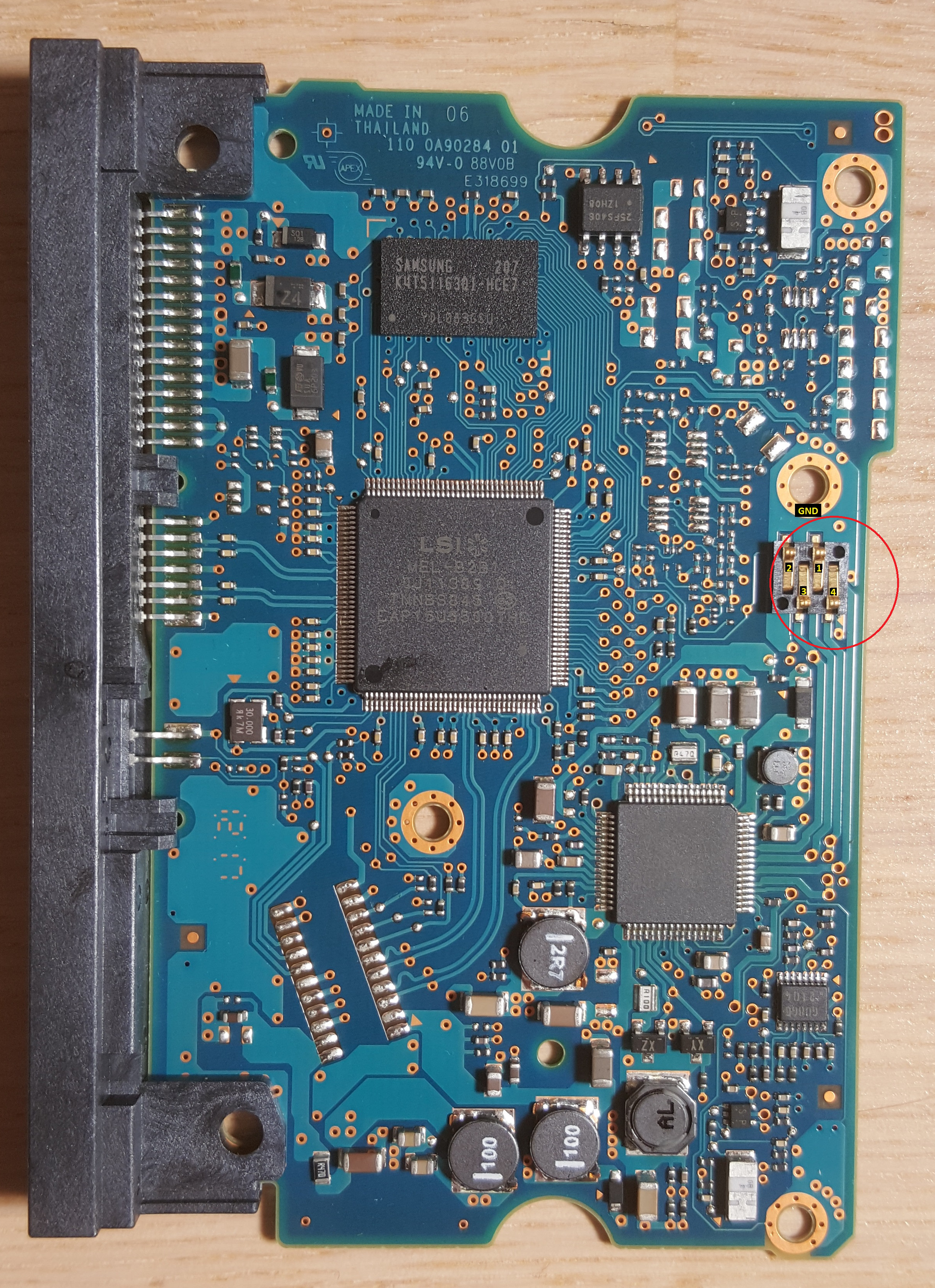

What would be the best place to measure V_boost? There doesn't seem to be any vias right where you wrote V_boost with yellow letters in this picture:

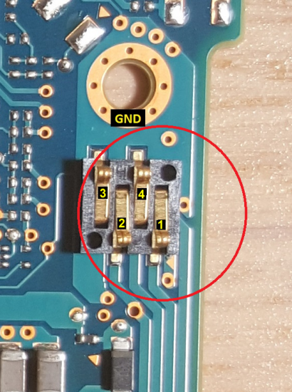

Btw, I got the pin numbering wrong in the pic in my previous post. This is the correct numbering:
 Post subject: Re: Dead Hitachi HUA723020ALA641 2TB 3.5" 7200rpm (Jun-2012)
PostPosted: September 28th, 2023, 15:25
Posts: 17335
The boost voltage must connect to a filter capacitor, so I expect that the small component to the left may be an inductor (for filtering), in which case there is a filter capacitor at the top left of the motor controller.
As for the motor terminal, just measure them all.

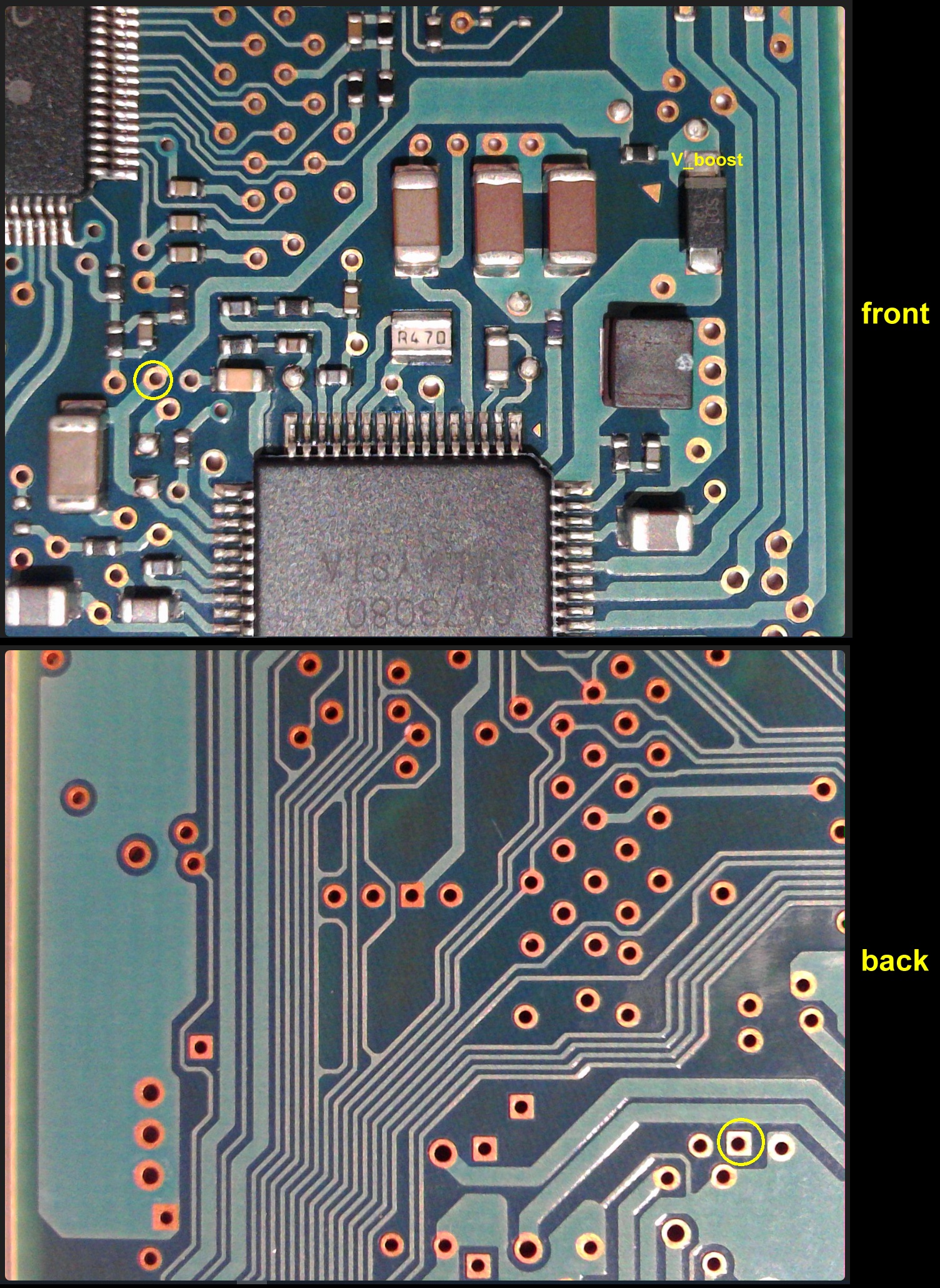

So e.g. here should be good?
PostPosted: September 28th, 2023, 15:45
Posts: 17335
Yes, I expect so. You can confirm that 12V is present when the PCB is not connected.

** Motor terminals on PCB, PCB loose, no power;
* JUL-2012 eBay drive that should've been good, but isn't:
pin 1 to GND: 38.6 kOhm
pin 2 to GND: 0.3 Ohm
pin 3 to GND: 0.3 Ohm
pin 4 to GND: 0.3 Ohm
* SEP-2011 eBay drive that is working perfectly:
pin 1 to GND: 37.9 kOhm

It looks like the boost voltage is only used when the drive is seeking. That is, it is required by the VCM circuit, not the spindle. This is consistent with the L7250 datasheet.
The low resistances for the motor phases are the result of residual charge on the gates of each of the low-side MOSFET drivers, so that's normal.
