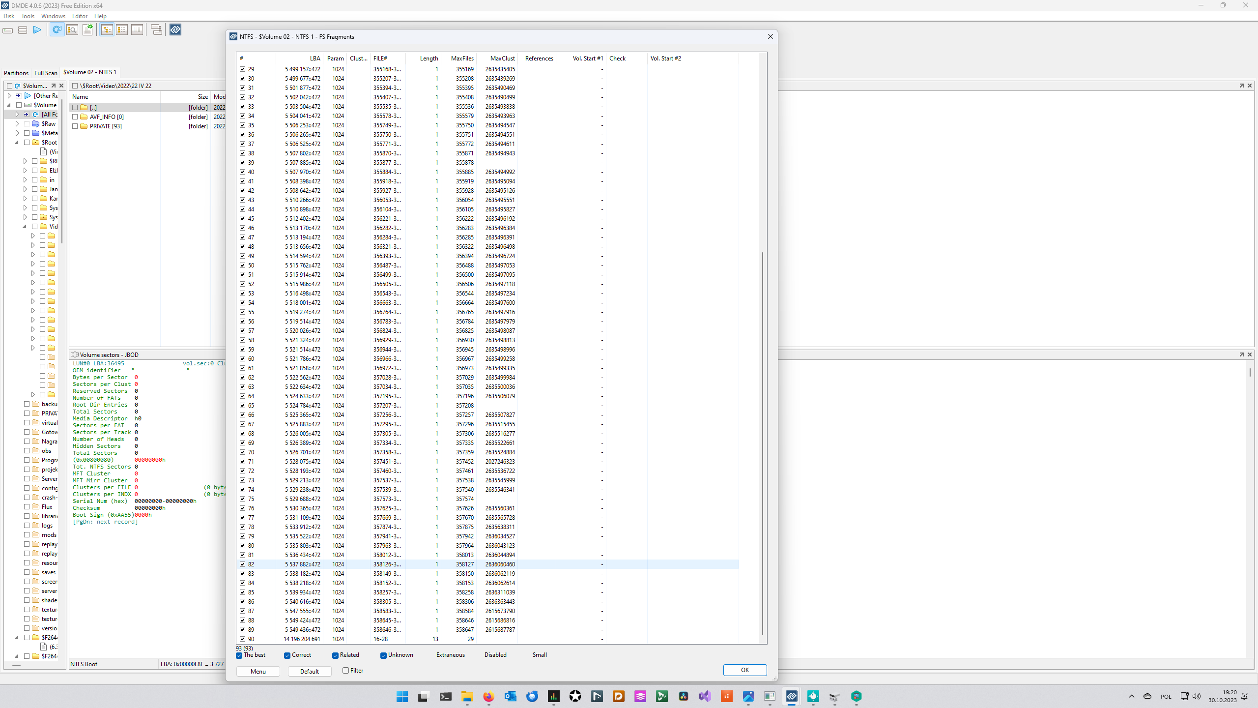

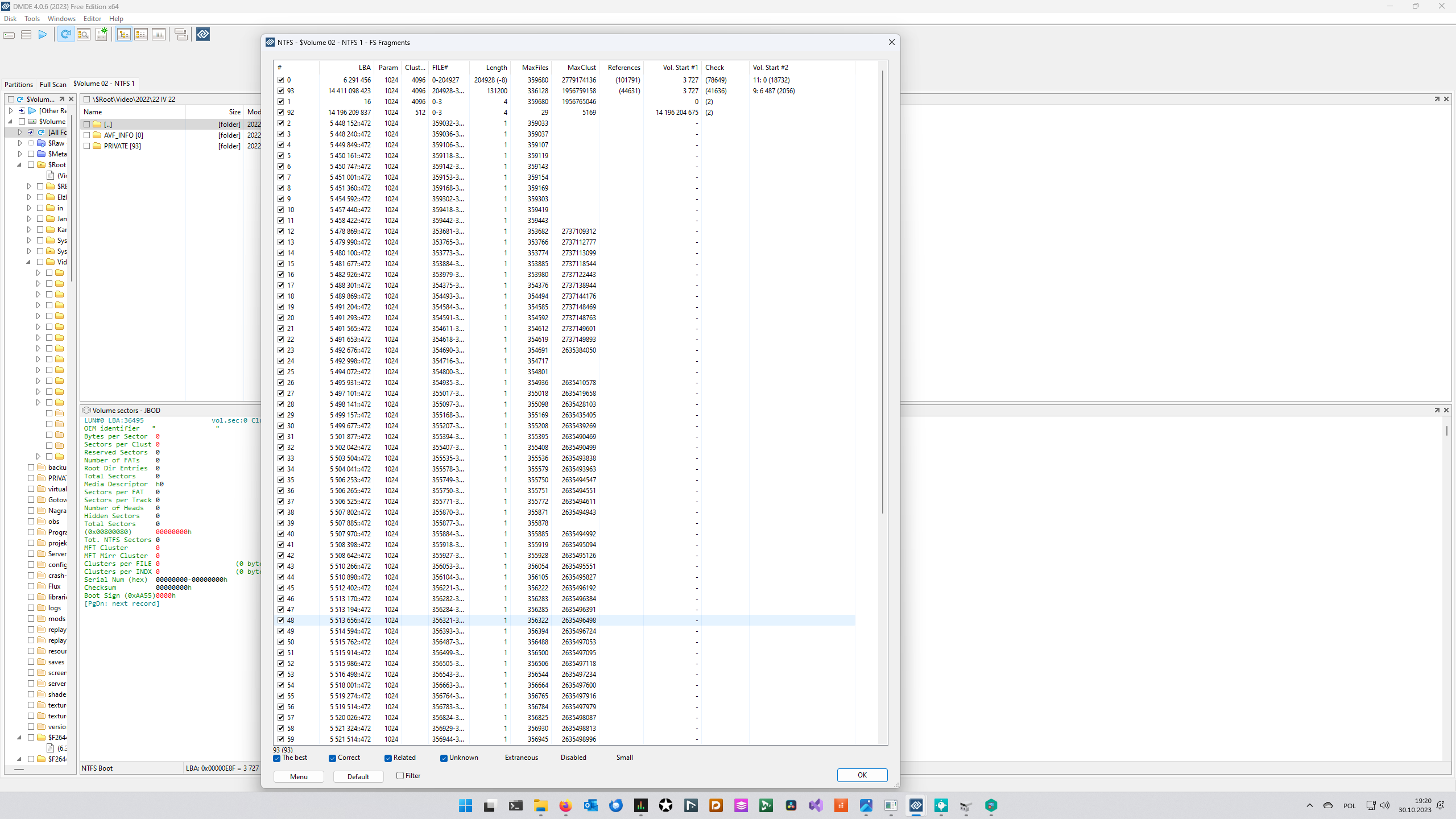

Posts: 23
Scan completed, now it doesn't show any errors building virtual fs.
I have some more files but many are still missing
Here is a new MFT record list:

Ah, bummer! Still same two MFT chunks. I can not explain weird (IMO) start location for file system.
You could try with something that interprets LDM (DMDE doesn't), Alexey's new file recovery tool for example: https://www.klennet.com/klennet-recover ... ities.aspx but also UFS probably. Try demos first, see if they detect more files. Perhaps files are unrecoverable, perhaps next chunk of MFT lives on 3rd drive.
Or send to someone, these things are always easier with drives in front of you, someone may even be able to recover remotely. You're in Poland? Some excellent, some of the best labs are found there.
