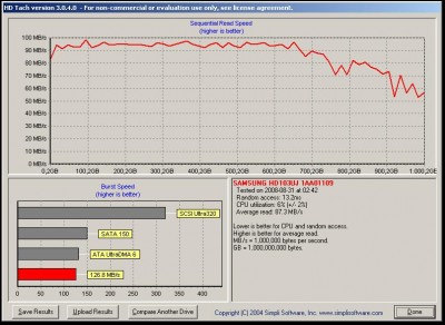

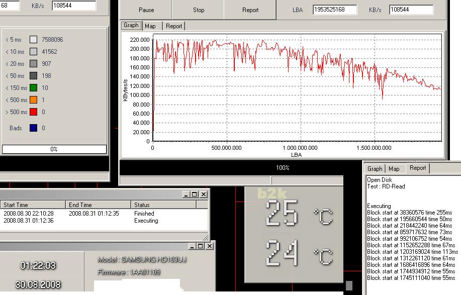

I own two of the same drives as yours one with Revision(firmware) 1AA01104 (half a year old) and the other one with 1AA01109 (2months old)
the 04 already had a hard time on lan partys switching between cases to move data from pc to pc
the 09 was placed on the bottom of my case while using it (1 month)
now both of them are mounted as they should be and air cooled to 24-25°C while operating
they are both used as data backup drives, no operating system is installed/used on them
what do u say to my first hddscan (of 09)? should i be worried? have you already tested your bad drive in every day use?
i hope the scan didnt harm the data on the drive ... (the drive is half full)
till 70% the drive had around 7000 over 5ms
from 70% to the end it climed up to 40000 sectors over 5ms .. hmmm
(with such numbers its hard for me to imagine that there are other drives with all sectors under 5ms; again correct me if im wrong)
around 98% i looked at the KB/s it was around 115000 KB/s (what did you have?)
did you tell the firmware of your drives already? sorry if i cant remember them...
bye b2k
oh btw hddscan shows the wrong date ;)
File comment: samsung 09

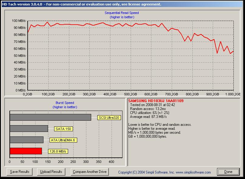

same drive (09) with hdtach
it looks like it stays very long at max speed ... maybe this are the 70% from above
maybe its just the fact that the drive got 3 patterns but normally single drives have a more logarithmic curve

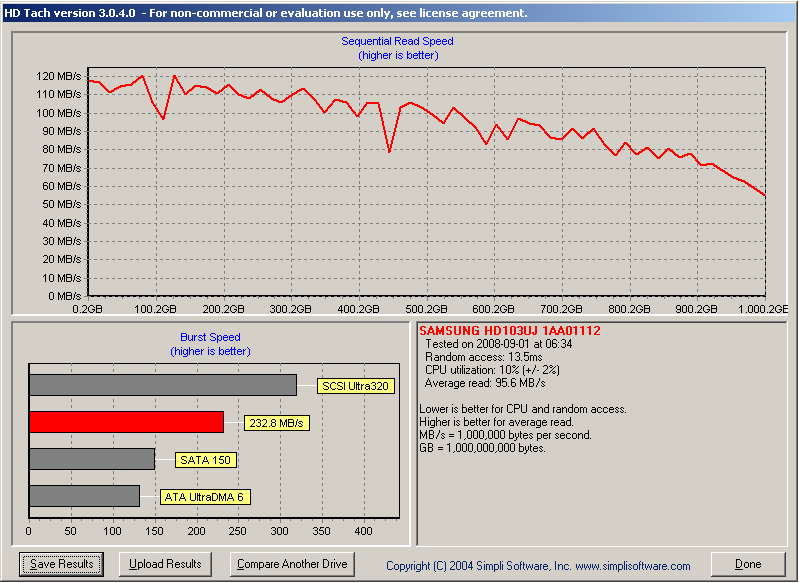

Hi b2k:
I am glad that someone else is posting real scans.
My Samsungs are both Firmware 1AA01112, manuf-Jun2008
although purchased 1 months appart (Jul,Aug), and in different shops.
Your disk only has 10 green blocks. Its pretty good. My "good one" has around 13.
Yours has one orange block, but this is usually due to Windows being busy, not the disk. Look at the log (if you saved it), and locate the position of the orange block. Then rescan from a bit earlier position, and look if the orange block appears again. Probably not.
Oh, I see the orange block is at the beginning. So just start the scan from the beginning and see
if it appears again.
Your transfer rate curve in HDDScan shows a very high speed. Maybe it is wrong.
Look at mines (for the bad disk, but the good one is very close):
I haven't tried HDTach.
bye

hi hddgorilla,
ah yours are working with a more recent firmware, good to know
would be interesting if the version does say somthing about the drive behavior here
thx for pointing out the too high transfer speed, of course much too high for a single drive .. no idea how i managed to get this result; hdtach shows normal speeds
oh and your drives curves are much more consistant than mine but thats maybe just because of the wrong speed measurments (just gussing)
i rescanned the beginning of 09 and you were right, now the orange is gone!
but i still got the to high speeds (between 120 and 200) hmm ...
lets check if we both are using the same version of hddscan (mine is the latest 3.1 and i deactivated the skin)
second i saw that you were using VR-Verify as scan mode while i was using RD-Read
(oh and yours if i remember right is without data while mine already has data on it)
cu

Here is the HDTACH of my drive (the one with many greens)
 Post subject: Re: Samsung F1 (1TB) HDDScan: >700 green blocks. do I return it?
PostPosted: August 31st, 2008, 23:35
Joined: August 27th, 2008, 13:51
Posts: 58
my burst rate is much higher than yours. Probably its the controller.
I am using SATA as IDE, so I don't need to install SATA drivers.
You are probably also as IDE.
I don't know when a bad sector is reallocated. I think a slow sector is not reallocated. Only the bad ones.
I know that, whenever a sector is reallocated, (mapped out), the SMART changes both "Reallocation Sector Count" and "Uncorrectable Sector Count" increasing them by 1 (the RAW value)
