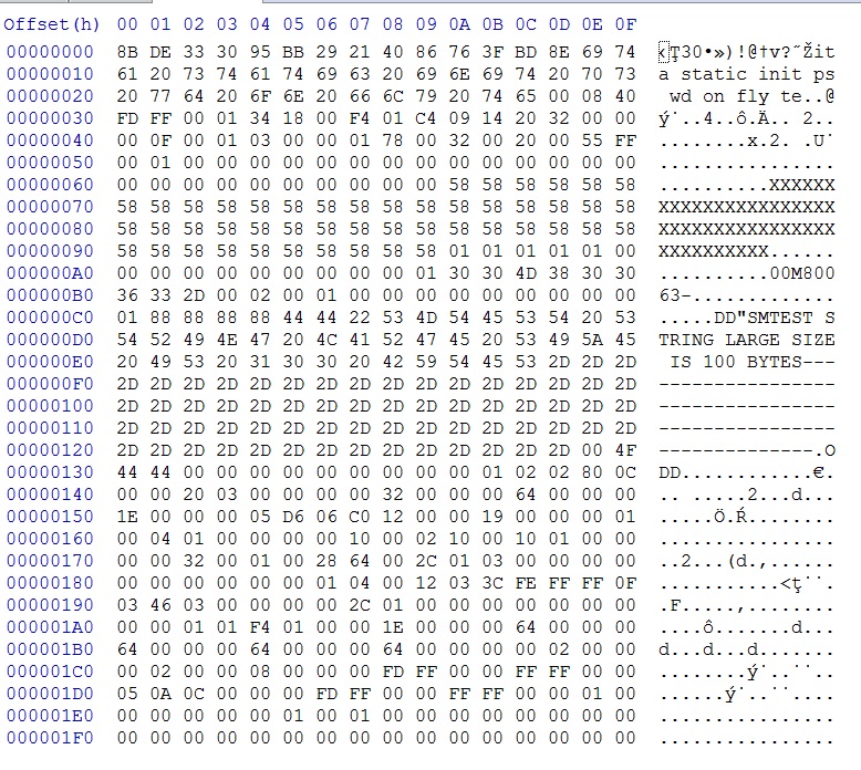

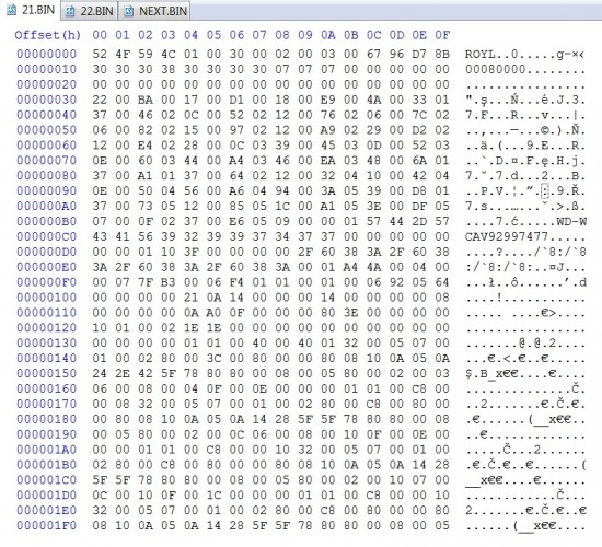

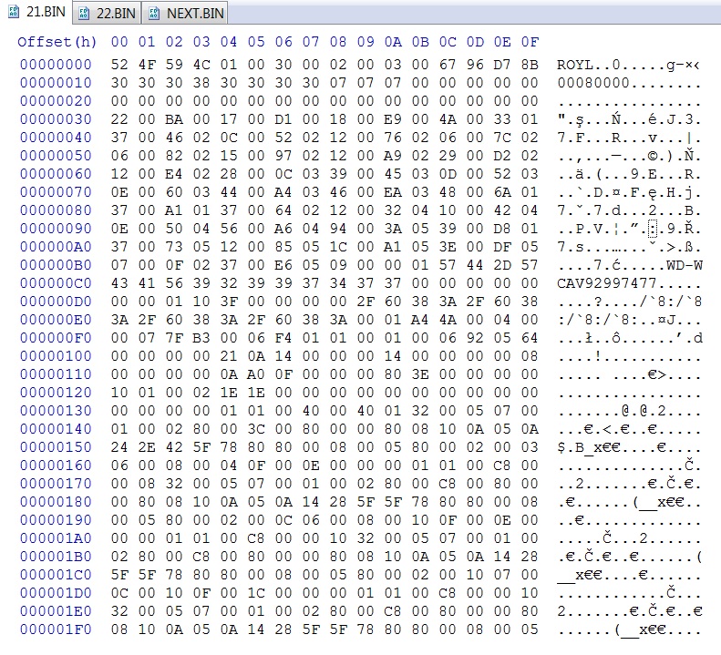

hello,
please help me find my master password
thx for help
NN

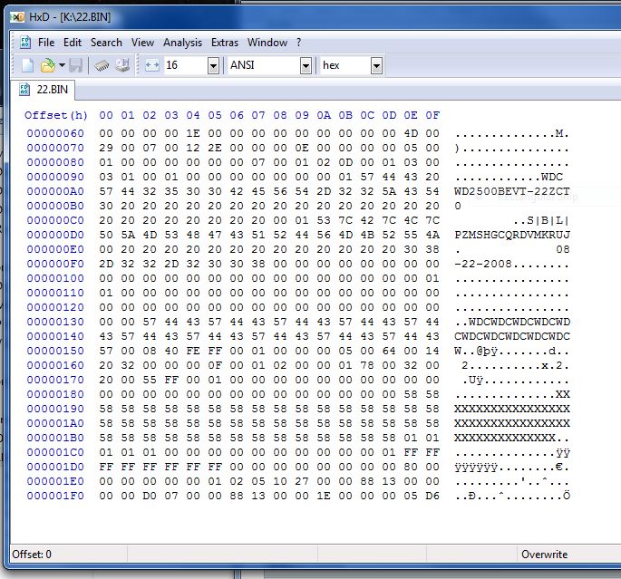

I've been reading this thread for two days now, and I THINK I've followed the instructions. Not a complete n00b, not by a long shot, but I must say I am impressed by the knowledge and experience some of you folks have. I'm a self-taught geek, and I pride myself in being able to find the solutions I need. But yes, I do need a hand with this one. I hope I've given enough information here, including the 22.bin file snip. Thanks SO much for any help!!
Chris

Did you try the WDCWDCWDC.... WDCW password ?
PostPosted: April 9th, 2012, 16:08
Joined: April 9th, 2012, 13:24
Posts: 11
Location: Wisconsin, USA
Yes, and several derivations of it, ending in a W, a D, and a C.

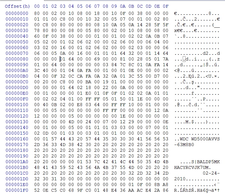

Hello
I have a hard drive that has ata wd5000avvs password
Czytałem side of this topic, but I do not know English so well that I understood that.
I read in the password file, you can check 22.bin
Could someone explain step by step to me as I do and run this script?
MHDD on a bootable USB drive I already have.
How to make a script and turn it on - then search for the same hex.
Thank you and sorry for the duplication topic
translated by google translator
Plsss.... help :|

Hello again. New to this forum, and to hardware manipulation in general. I made a post yesterday with a .bin snip, and another with the .bin file itself. Overnight I received a PM from an apparent regular to this board, so I am taking that advice in this subsequent post.
The drive I'm trying to unlock does not belong to me. It is a co-worker's drive, who had been having some blue screen issues with his Vista installation. Instead of seeking help right away, he tried to fix it himself (I'm sure we've all been there..). In the process he was poking around in the BIOS of his Dell, and proceeded to password both the BIOS and the hard drive. He's not too concerned about the laptop, but he needs some data from the drive itself, namely his 2009 taxes. He said that if he cannot get this information, the IRS is going to try and nail him for $53,000 in back taxes.
That's the background. Now to the present. After realizing that the most likely and safest way to bypass the BIOS password would entail replacing the motherboard, I decided I'd take the drive out and connect it as an external to my desktop. A hundred hours of scanning with ZAR produced nothing. I then removed the HDD from my laptop, and set his in its place. It was then that I realized the HDD itself was passworded as well. After three tries it locks the drive out.. Does this prevent MHDD from seeing it correctly? That lead me to this forum and this thread. It would appear that all the information I need is somewhere in the first four pages or so, and I have tried like everything to follow the instructions, but something is still eluding me. Here again is the .bin snip. I hope I've given enough information, and any and all help is greatly appreciated.
Thanks!!!
Chris
