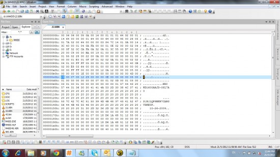

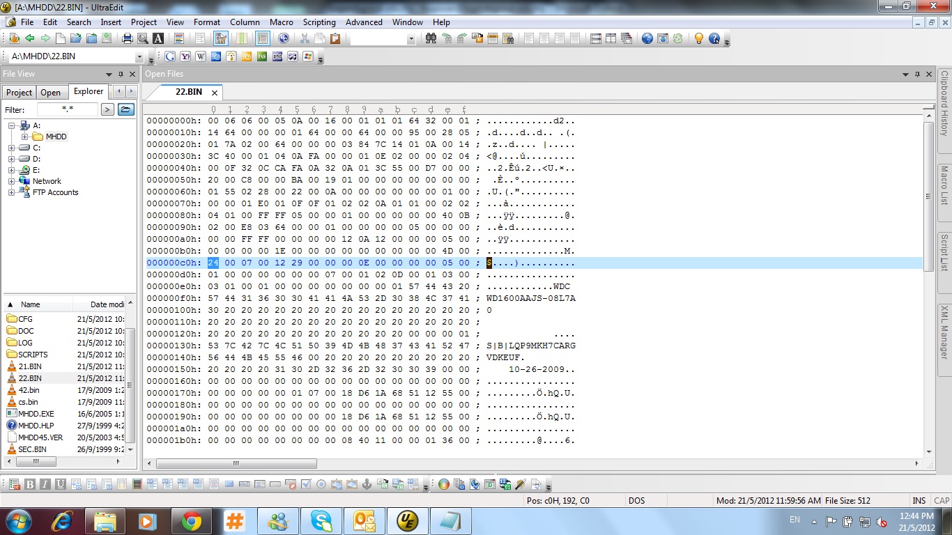

PostPosted: May 21st, 2012, 0:35
Joined: May 21st, 2012, 0:29
Location: Malaysia
i hv generated the 22.bin, but i really do not know how to retrieve the password... please help..

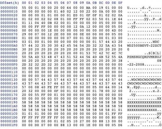

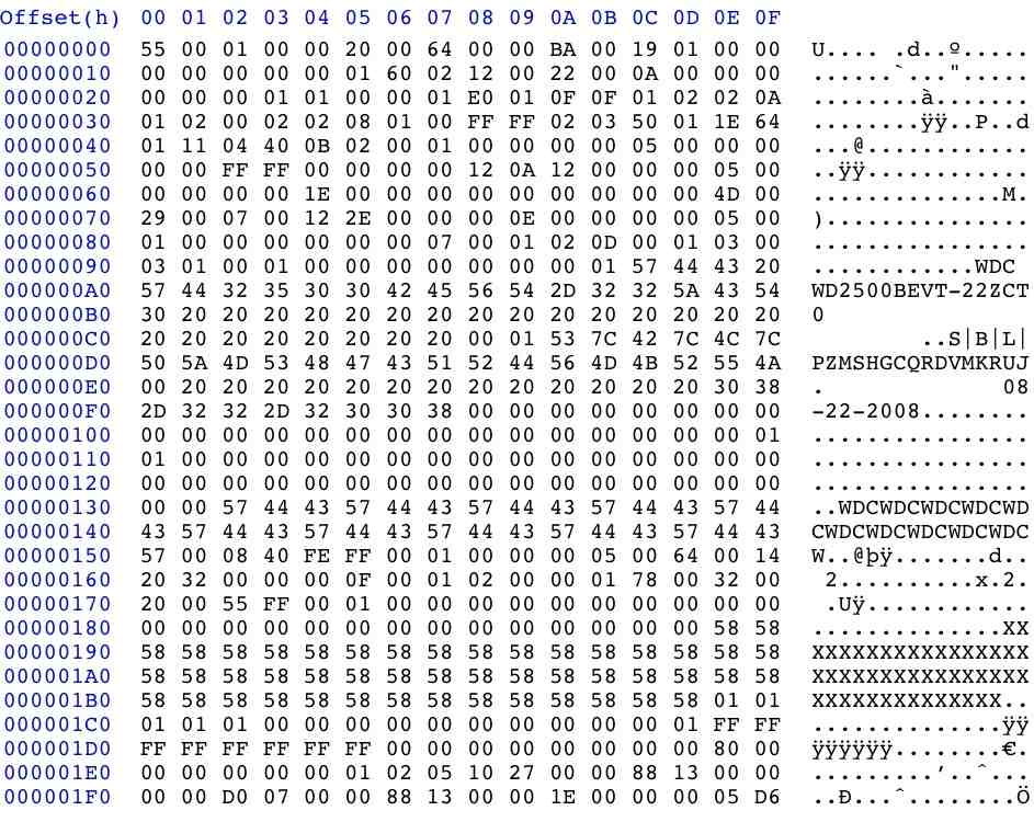

Hello 22.bin file help me get my passwords
I dont know what is my password. :shock:
55 00 01 00 00 20 00 64 00 00 BA 00 19 01 00 00 00 00 00 00 00 01 60 02 12 00 22 00 0A 00 00 00 00 00 00 01 01 00 00 01 E0 01 0F 0F 01 02 02 0A 01 02 00 02 02 08 01 00 FF FF 02 03 50 01 1E 64 01 11 04 40 0B 02 00 01 00 00 00 00 05 00 00 00 00 00 FF FF 00 00 00 00 12 0A 12 00 00 00 05 00 00 00 00 00 1E 00 00 00 00 00 00 00 00 00 4D 00 29 00 07 00 12 2E 00 00 00 0E 00 00 00 00 05 00 01 00 00 00 00 00 00 07 00 01 02 0D 00 01 03 00 03 01 00 01 00 00 00 00 00 00 00 01 57 44 43 20 57 44 32 35 30 30 42 45 56 54 2D 32 32 5A 43 54 30 20 20 20 20 20 20 20 20 20 20 20 20 20 20 20 20 20 20 20 20 20 20 20 00 01 53 7C 42 7C 4C 7C 50 5A 4D 53 48 47 43 51 52 44 56 4D 4B 52 55 4A 00 20 20 20 20 20 20 20 20 20 20 20 20 20 30 38 2D 32 32 2D 32 30 30 38 00 00 00 00 00 00 00 00 00 00 00 00 00 00 00 00 00 00 00 00 00 00 00 01 01 00 00 00 00 00 00 00 00 00 00 00 00 00 00 00 00 00 00 00 00 00 00 00 00 00 00 00 00 00 00 00 00 00 57 44 43 57 44 43 57 44 43 57 44 43 57 44 43 57 44 43 57 44 43 57 44 43 57 44 43 57 44 43 57 00 08 40 FE FF 00 01 00 00 00 05 00 64 00 14 20 32 00 00 00 0F 00 01 02 00 00 01 78 00 32 00 20 00 55 FF 00 01 00 00 00 00 00 00 00 00 00 00 00 00 00 00 00 00 00 00 00 00 00 00 00 00 58 58 58 58 58 58 58 58 58 58 58 58 58 58 58 58 58 58 58 58 58 58 58 58 58 58 58 58 58 58 58 58 58 58 58 58 58 58 58 58 58 58 58 58 58 58 58 58 01 01 01 01 01 00 00 00 00 00 00 00 00 00 00 01 FF FF FF FF FF FF FF FF 00 00 00 00 00 00 00 00 80 00 00 00 00 00 00 01 02 05 10 27 00 00 88 13 00 00 00 00 D0 07 00 00 88 13 00 00 1E 00 00 00 05 D6
PostPosted: June 20th, 2012, 10:55
Joined: June 20th, 2012, 10:27
Posts: 5
Location: help me with my password
PostPosted: June 20th, 2012, 11:05
Posts: 5
22.zip [389 Bytes]
Downloaded 1175 times
PostPosted: June 20th, 2012, 11:09
Joined: July 7th, 2010, 4:45
Posts: 924
Could try this:
1) Boot to the MHDD CD
2) You will see a list of harddisk, select a harddisk you want to unlock
3) Type "unlock" and reply "1" for master password
4) Enter the master password. “WDCWDCWDCWDCWDCWDCWDCWDCWDCWDCW”
(If it is wrong, ERR will turns red on the top of the screen, and You have 4 more tries before it powercycle the disk)
5) If it is correct, type "DISPWD" and reply "1"
(There will be a warning if your disk is still locked)
Retype the master password again and your disk is unlocked!
(ERR will turn red if the password wrong)
6) Type exit and press "ctrl + alt+ del" to reboot
Worth a try at least
Loki
