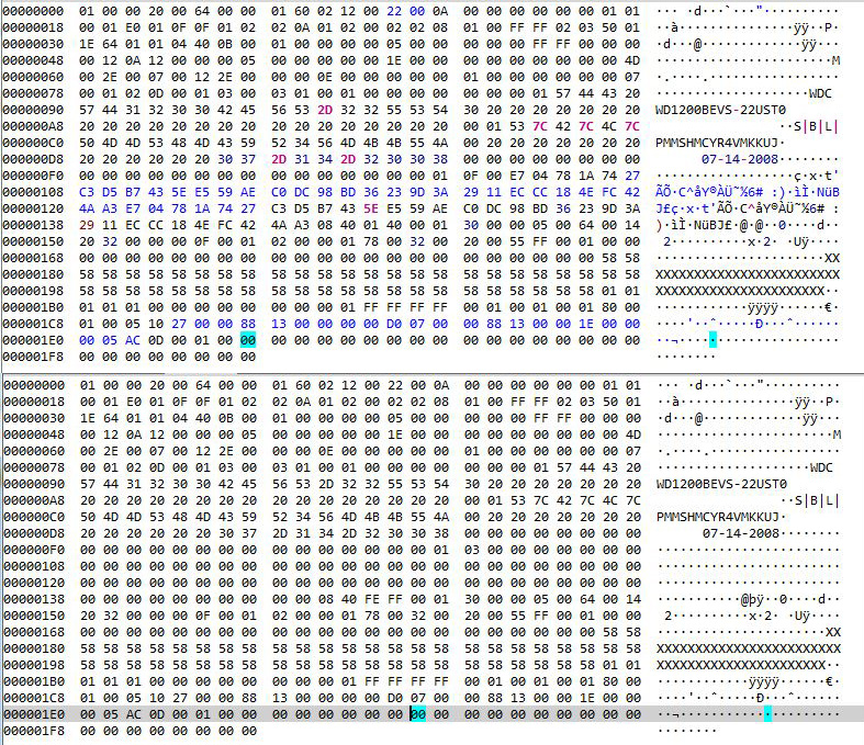

PostPosted: July 14th, 2012, 5:26
Joined: July 14th, 2012, 4:29
Location: Sussex, UK
I run my own repair shop in the UK, and thought this would be a useful service to offer to my customers. I have been messing with computers since my dad got me a ZX81 for my 15th birthday. :shock:
Anyway I have read through this entire thread about 6 times now, and experimented on several WD laptop drives I have here, with some success but there are still some unanswered questions...
1) The relationship between the cs.bin and the drive? Older drives seem to work ok, but newer drives give 'drive reports error' or 'no drq'. Is a different cs.bin file required for newer drives or does this method no longer work?
2) The relationship between the machine used to enter the password and the password. The attached pic shows a WD1200 with the password on and off. The differences are obvious but the password I set was only 4 chars long.
Hope someone can shed some light on this subject as I am finding it quite fascinating.

PostPosted: July 14th, 2012, 6:21
Posts: 339
I don't read this thread and can't comment on your case (and latest drives denerally), but can answer #2.
Yes, it depends on the BIOS. Some (particularly laptops) will do some hash function from your passsword and system ID's, so it won't be visible in plain ASCII form. If your motherboard is dead, you can't see your data on other one. It is one of the reason it is generally a bad idea to protect your data by system password. And false sence of security too.
PostPosted: July 16th, 2012, 4:09
Thanks for the reply,
This makes sense as the password was set on a laptop via the bios. It also explains why I couldn't unlock it using other tools, even though I knew the password. It's rather worrying that setting a simple password could cause all sorts of issues should the machine die!

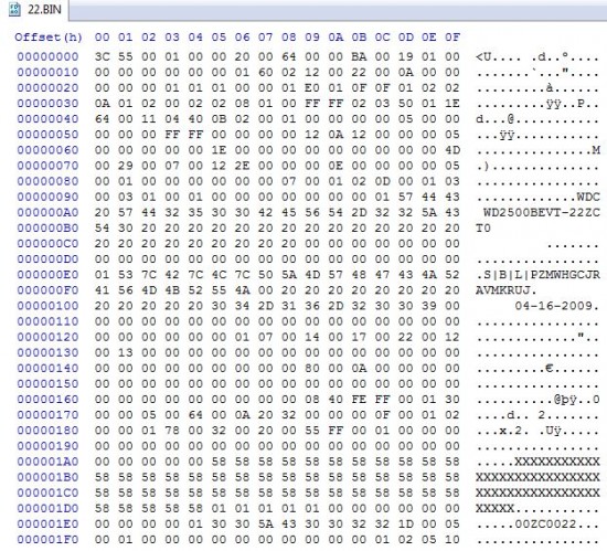

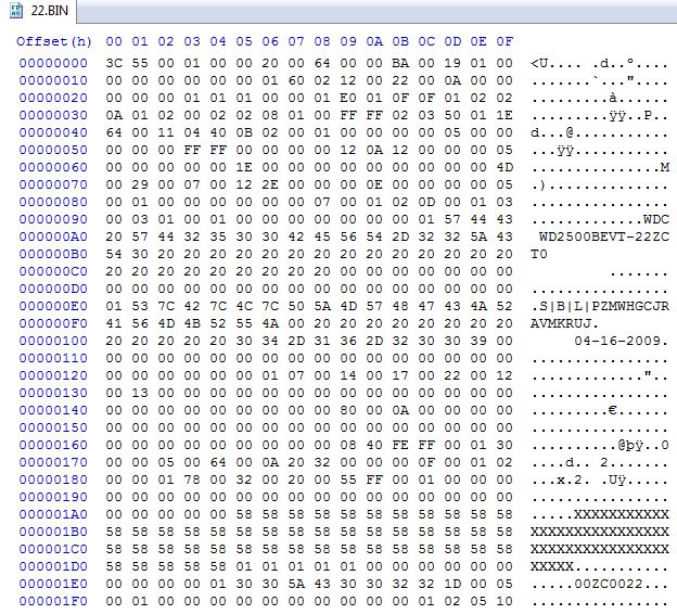

PostPosted: July 18th, 2012, 12:19
Joined: July 18th, 2012, 11:47
Hi everyone,
Hoping someone can help me unlock a WD2500BEVS hard drive. I have been through this thread umpteen times but I cannot get past the steps as shown below,
LINE 1: RESET
LINE 2: WAITNBSY
LINE 3: REGS = $57 $44 $43 $00 $00 $A0 $8A
LINE 4: WAITNBSY
LINE 5: REGS = $00 $02 $00 $00 $0F $E0 $21
LINE 6: WAITNBSY
LINE 7: CHECKDRQ
LINE 8: SECTORSTO = 42.BIN
ERROR: drive reports error
LINE 1: RESET
LINE 2: WAITNBSY
LINE 3: REGS = $45 $0B $00 $44 $57 $A0 $80
LINE 4: WAITNBSY
LINE 5: REGS = $D6 $01 $BE $4F $C2 $A0 $B0
LINE 6: WAITNBSY
LINE 7: CHECKDRQ
LINE 8: SECTORSFROM = CS.BIN
I'm obviously missing a bit of info but I can't figure out what, anyone help please?
