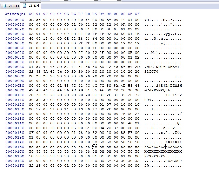

PostPosted: September 2nd, 2012, 15:21
Joined: September 2nd, 2012, 15:12
Hi folks !
I have some difficulties with decoding password from 22.BIN file.
I've read all 26 pages, but still nothing...
Maybe I'm doing something wrong...
Please help.
Greetings
22.txt [512 Bytes]
Downloaded 1003 times
