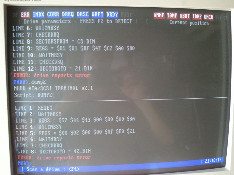

Hello
I made a mistake. I though the command "dump" ran correctly, but it didn't. I think the above screenshot is for a WD 250GB and my drive is a WD 160GB. But now here is my problem.
When booting MHDD, it asks to select HDD, which I do, then I type ".dump or .dump2". Both of them run a few lines of code but then it just stops with error "Error: Drive Reports Error". This means that I can't save the bin file to view the contents. Is it possible that the commands are trying to save the bin files onto the locked drive and not USB bootable MHDD drive?
Another question: Do I need to run the attached SATA WD 160GB drive in Native Sata or AHCI SATA. The reason I ask is that I am using another computer to do this and this computer's BIOS doesn't have any AHCI Mode settings in its BIOS.
Thank you.
PostPosted: November 5th, 2012, 6:23
Posts: 260
Location: TN
I would run the WD diagnostics on the drive sounds like the drive is having problems other than the password issue. What is the history on the drive make model what happened etc
No.
I can think of a couple of different possible reasons for the behaviour that you're seeing, but since you've explained that the data on the drive isn't yours, and since the drive was effectively unusable when you bought it (as part of the laptop), I suggest that the shop should be replacing that drive.

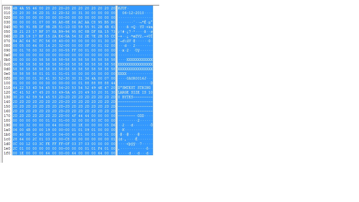

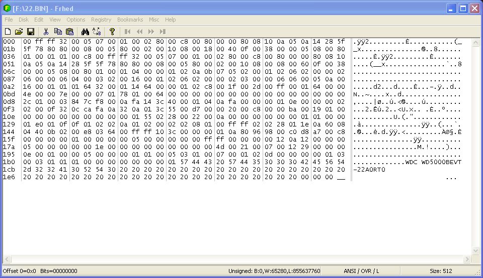

I need some assistance in decoding the password for the attached bin file. Tried using zu betta without luck, tried using HDAT2 with the 30 hex without luck.
95A88E86ACAAC895B5B09D90918BDF9B2B511D0D5955912B6B613B212317
Any pointers much appreciate.
The laptop is a fujitsu lifebook with locked WD5000BEVT HDD.
PostPosted: November 8th, 2012, 13:26
Joined: February 6th, 2010, 11:27
you should try 32 bytes: add BF37 to the end
PostPosted: November 8th, 2012, 15:49
Joined: November 8th, 2012, 5:45
Location: Sydney
Tried 95....bf37 as user and master.
Tried 8a....fc56 as user and master.
Both entries using HDAT2 v4.8.1 and not good.
Other pointers?
PostPosted: November 8th, 2012, 18:23
Joined: October 30th, 2012, 17:47
Posts: 11
Location: Michigan
What bin file is that 22 or 42? Either way, I don't see the appropriate header before what would be the user password?
PostPosted: November 8th, 2012, 18:42
Location: Sydney
Header is at 34 35 36 offset.
This is an extended 22 bin due to newer drives.
PostPosted: November 8th, 2012, 23:13
Posts: 11
Location: Michigan
I'm only familiar with user passwords after 00 01 07 headers, sorry. If the next 32 bytes after the header you describe do not work as the user password in hdat2 4.7 or higher, I have no idea.

PostPosted: December 24th, 2012, 3:57
Joined: December 21st, 2012, 17:21
Location: Germany
Hello everybody,

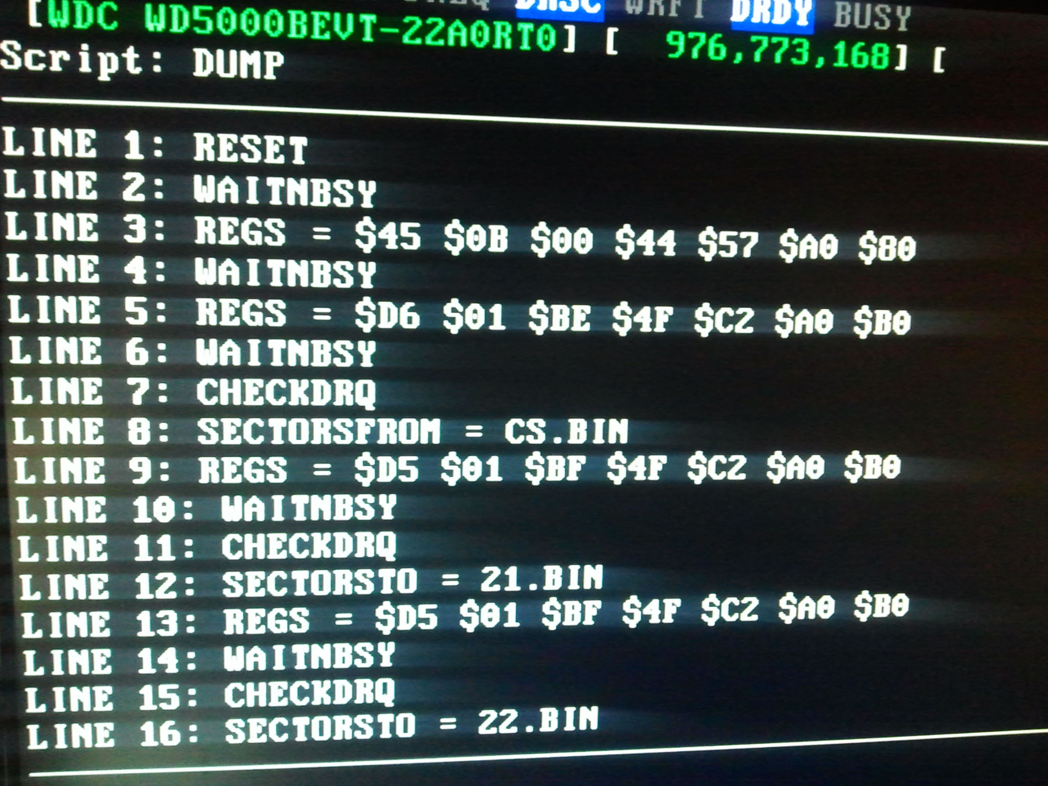

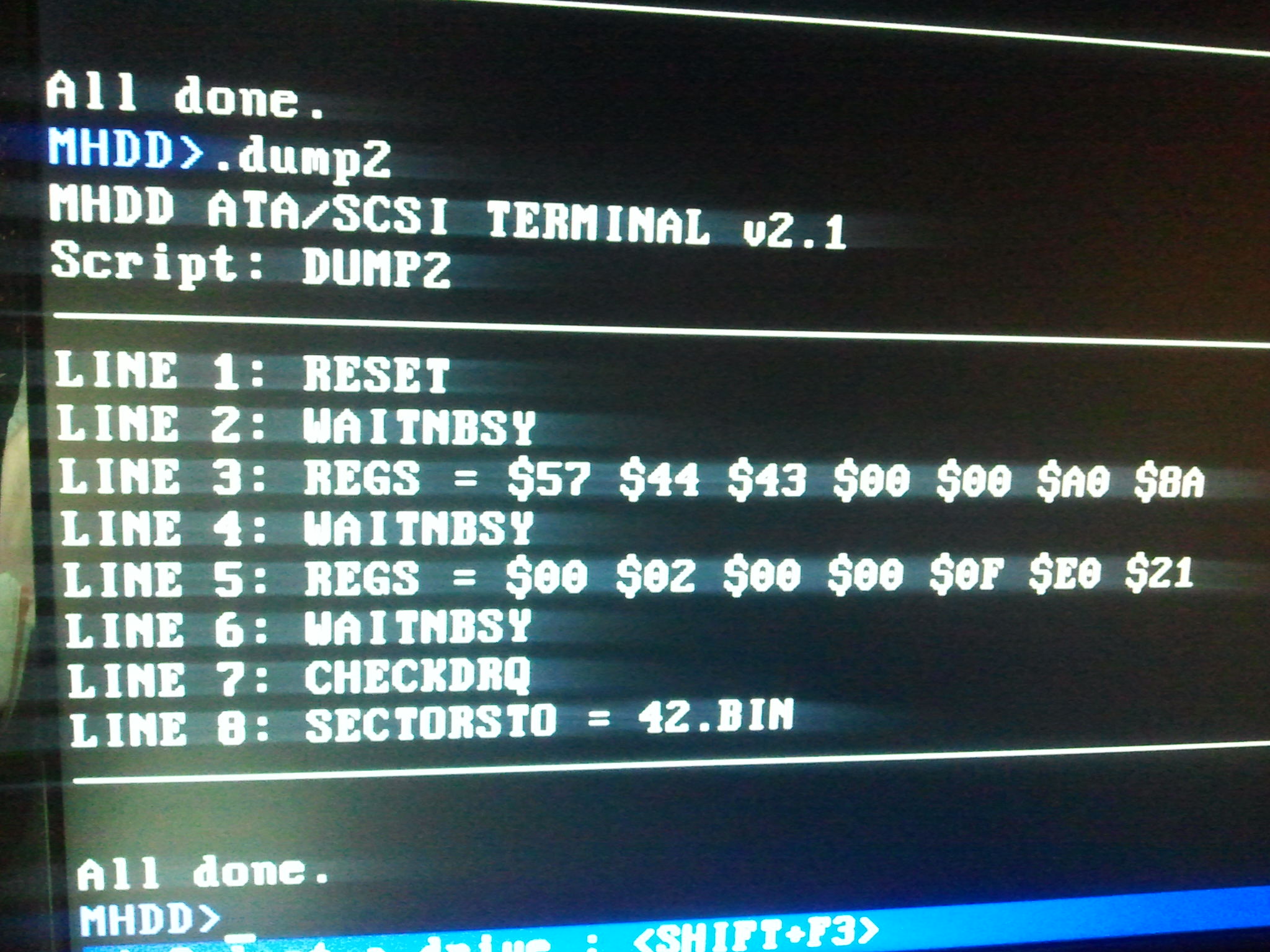

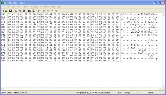

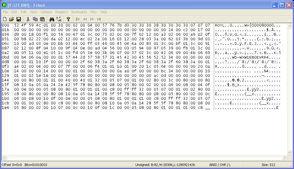

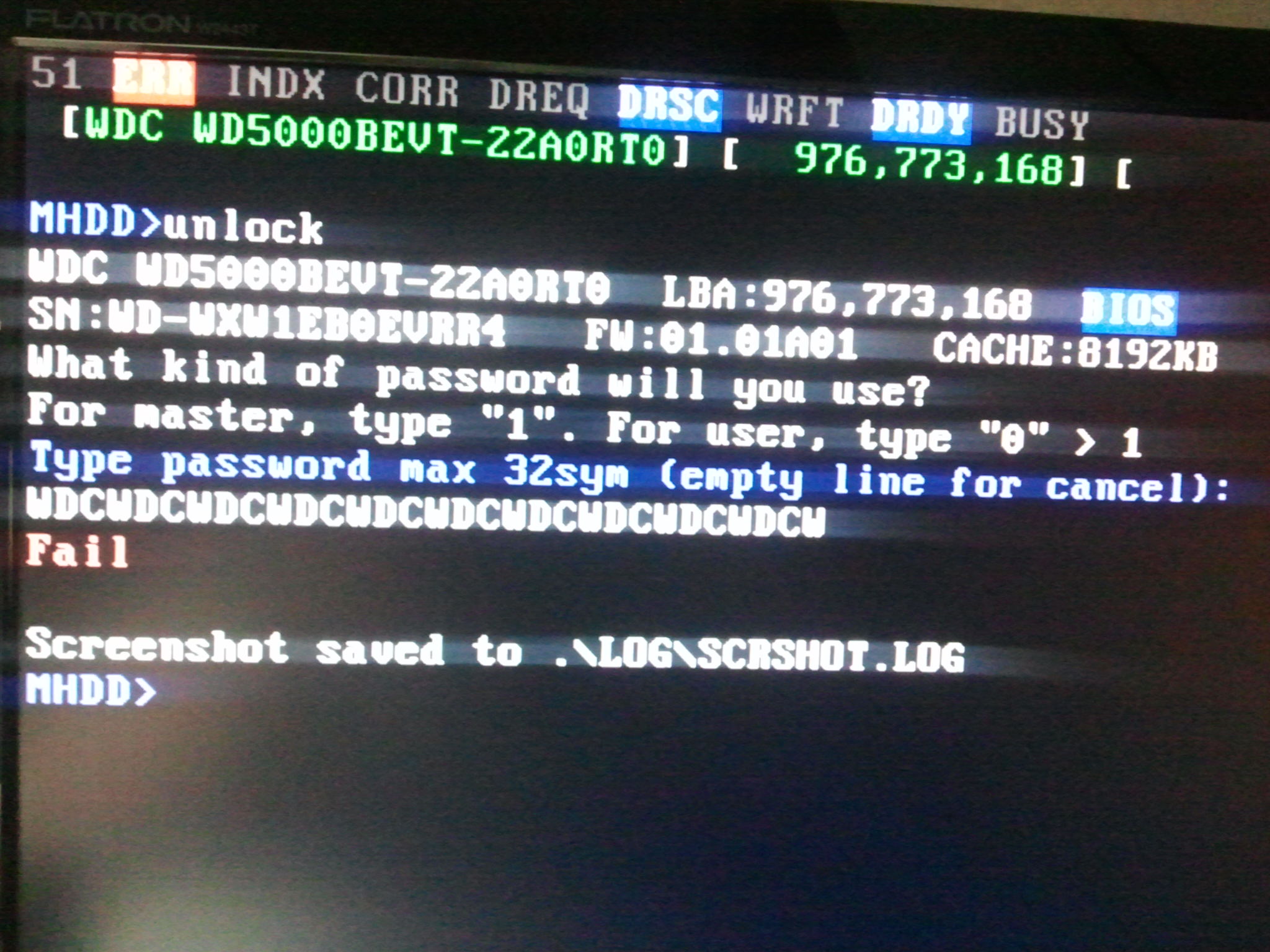

i try to research my ATA-password from my WD WD5000BEVT (Acer Notebook 5742G). At first i tried the unlock-command of MHDD with the master password "WDCWDCWDC...."-a.s.o.
Here you can see my screenshots of the result. It seemed to me, it didn't work. After this i tried the method to created a 22.bin file with .dump and .dump2.
On this BIN-Files i can't find any 01 07 00 combination (see attached files), to tell me my password. Could anybody help me with my problem?
