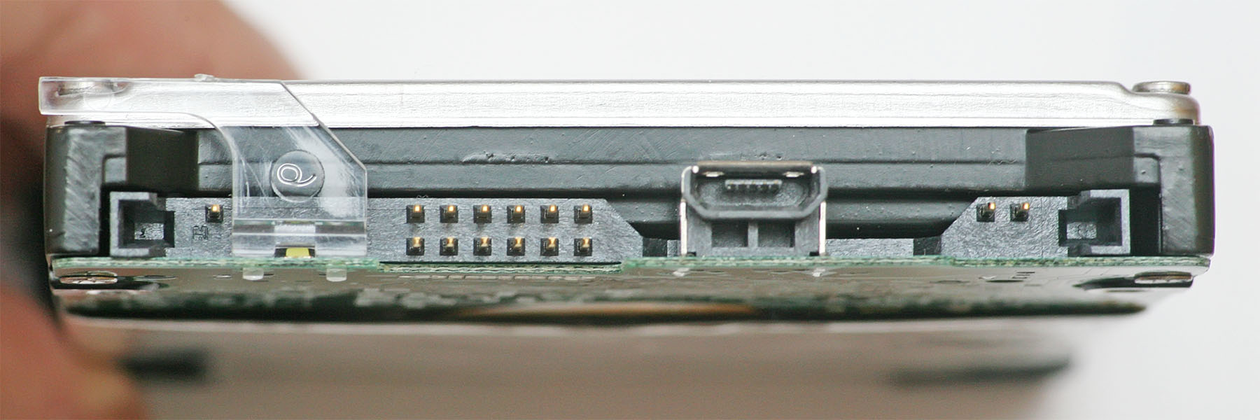

There is nothing wrong with your wiring job.
The extra pin is used as the ID pin for USB OTG (On The Go) devices. It is grounded at the host end, and open at the peripheral end.

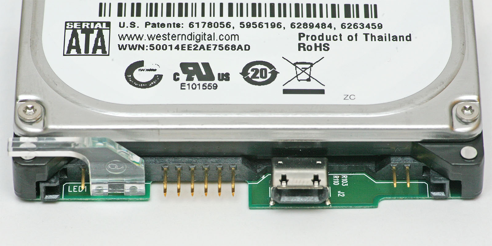

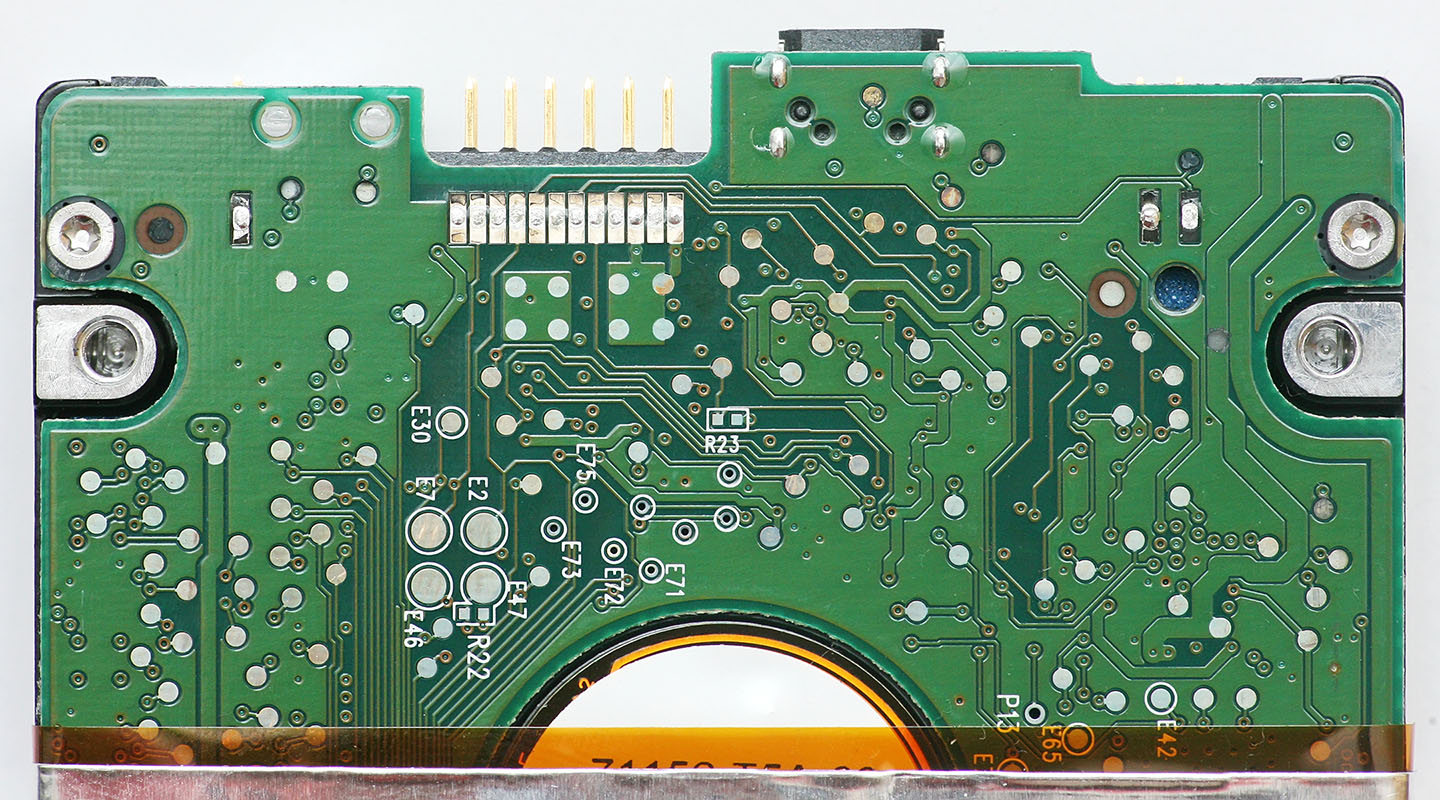

I have the same problem with the HDD: it spins, the white LED blinks, but it's not seen as an USB device. I have attached some photos of the PCB and of the connections. I can provide higher resolution pictures, if necessary.
In one of the previous posts, it is said that the problem has been, somehow, solved, but the used could not attach any picture of the repaired drive. Did anyone manage to fix a drive ?

Many users are reporting physical USB connection problems at WD's forums.
Otherwise, if the problem is with the Initio USB-SATA bridge chip, then try swapping the board. However, you will need to move at least one (U12), maybe two (U12 + U14) memory chips to your donor PCB.
U12 stores the "adaptive" data for the hard drive, while U14 is required by the Initio chip.
Your local TV/AV repair shop should be able to do the soldering work for you.
