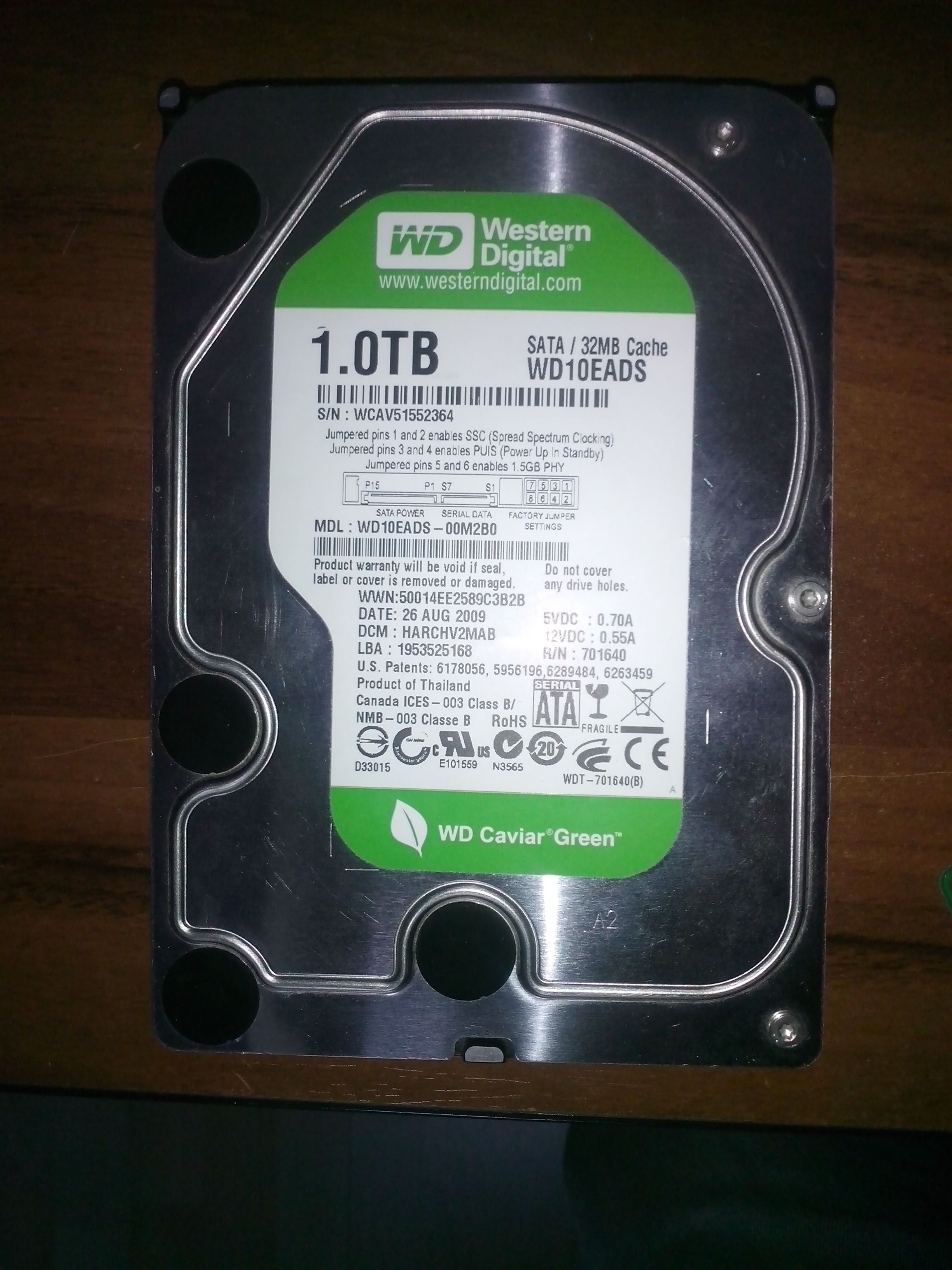

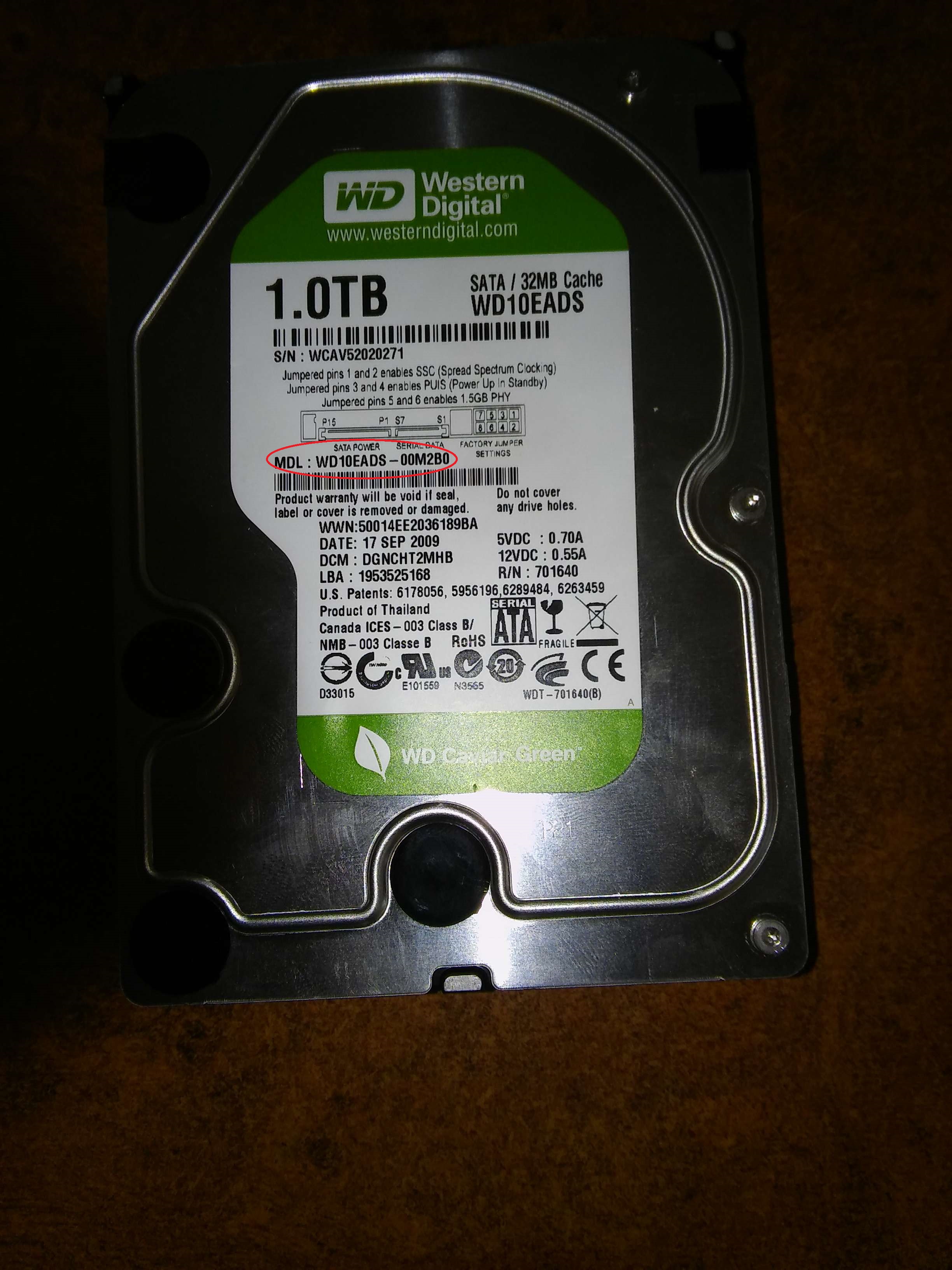

@fzabkar Recently (I don't give up because I have children's photos on it :-))
I found the same hdd with the same PCB but, my original hdd won't even start.
My question is if I need to transfer code from hdd platters where can it be stored if model don't have EPROM,
and MCU- Marvel 88I8945-TFJ2 is just a ROM ?
thank you

 Post subject: Re: Fried WD10EADS PCB : 2060-701640-001 REV A
PostPosted: September 12th, 2016, 20:58
Posts: 1388
Location: isreal
I don't know who is the patient and who is the donor
But they have different heads and head map not to mention different ROM ver. (And definitely different adaptive)
But they have same PCB no. though, that's why the ROM chip or its contents must to be transferred
PostPosted: September 13th, 2016, 3:48
Joined: November 30th, 2011, 17:50
Posts: 9
Location: Serbia
The same drive model WD10EADS-00M2B0
the same PCB number 2060-701640-001 REV A, same produce country, within 3months produced (Have pictures above), drive won't even spin.
Had spun years ago with another PCB, after I put my original MCU on that PCB it stopped spinning.
Could some wrong happend with preamp by repacing MCU?
