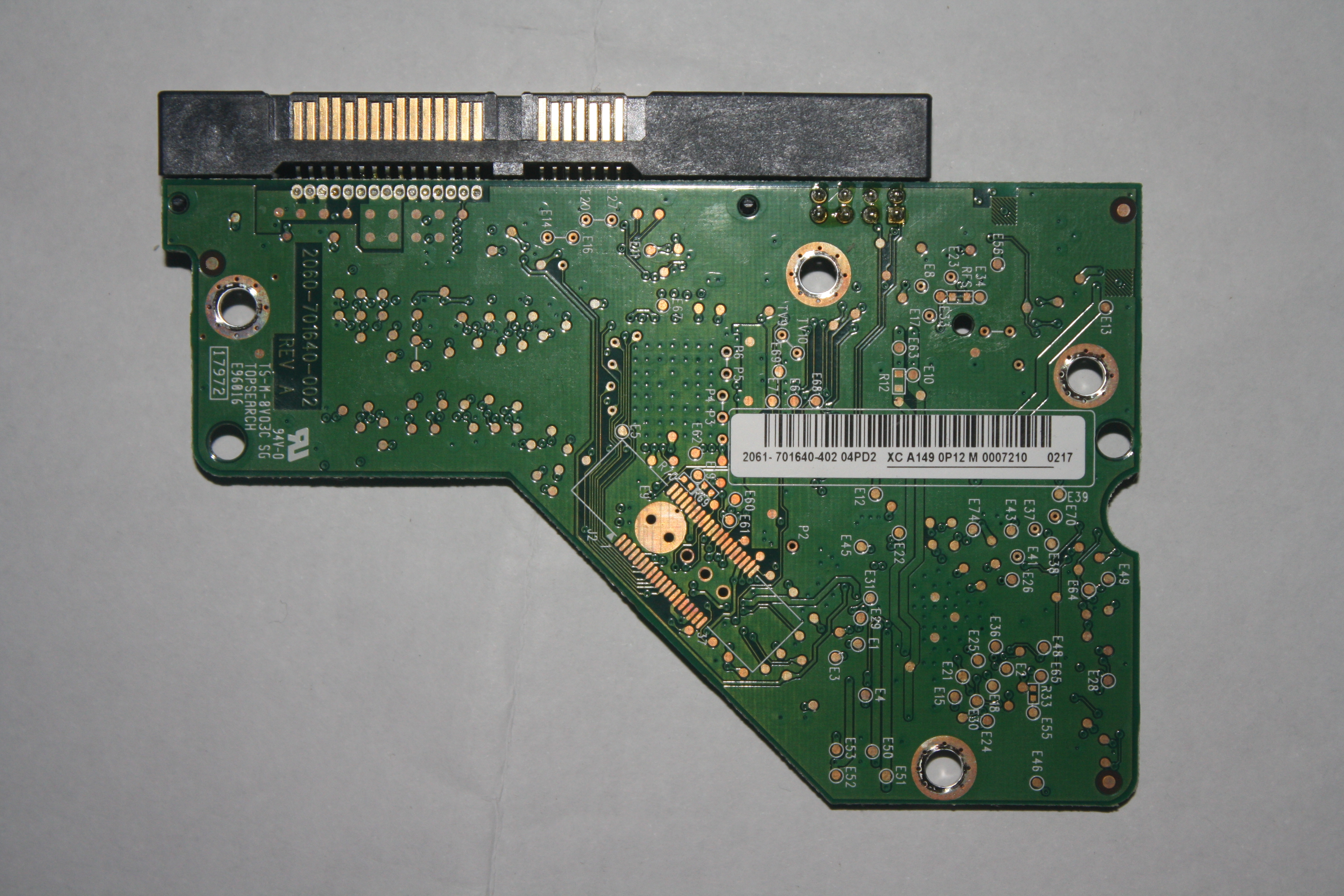

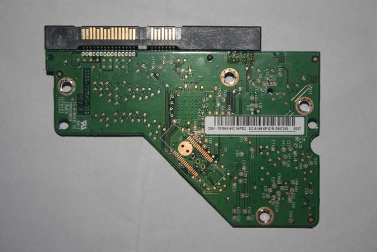

 Post subject: Re: Western Digital MyBook essential data recovery
PostPosted: November 25th, 2011, 9:23
Posts: 3549
OK I see your point, so if disk gets completely damaged then it's not a big deal, ok.
If you accept these risks of DIY, then you can go on and order a spare pcb and transfer the U12 from the patient board to the donor.
You can see the pcb number without taking it off the drive. Just look for a number printed that starts with 2060-. It should be 2060-701640-003 REV A (or something similar). If this is the case, then you need to match 2060-701640-003 (sometimes 2060-701640 is also enough). If you can match REV A then even better, but usually it doesn't matter.
To help you further, post here a clear picture of your pcb in both sides.

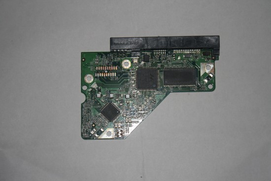

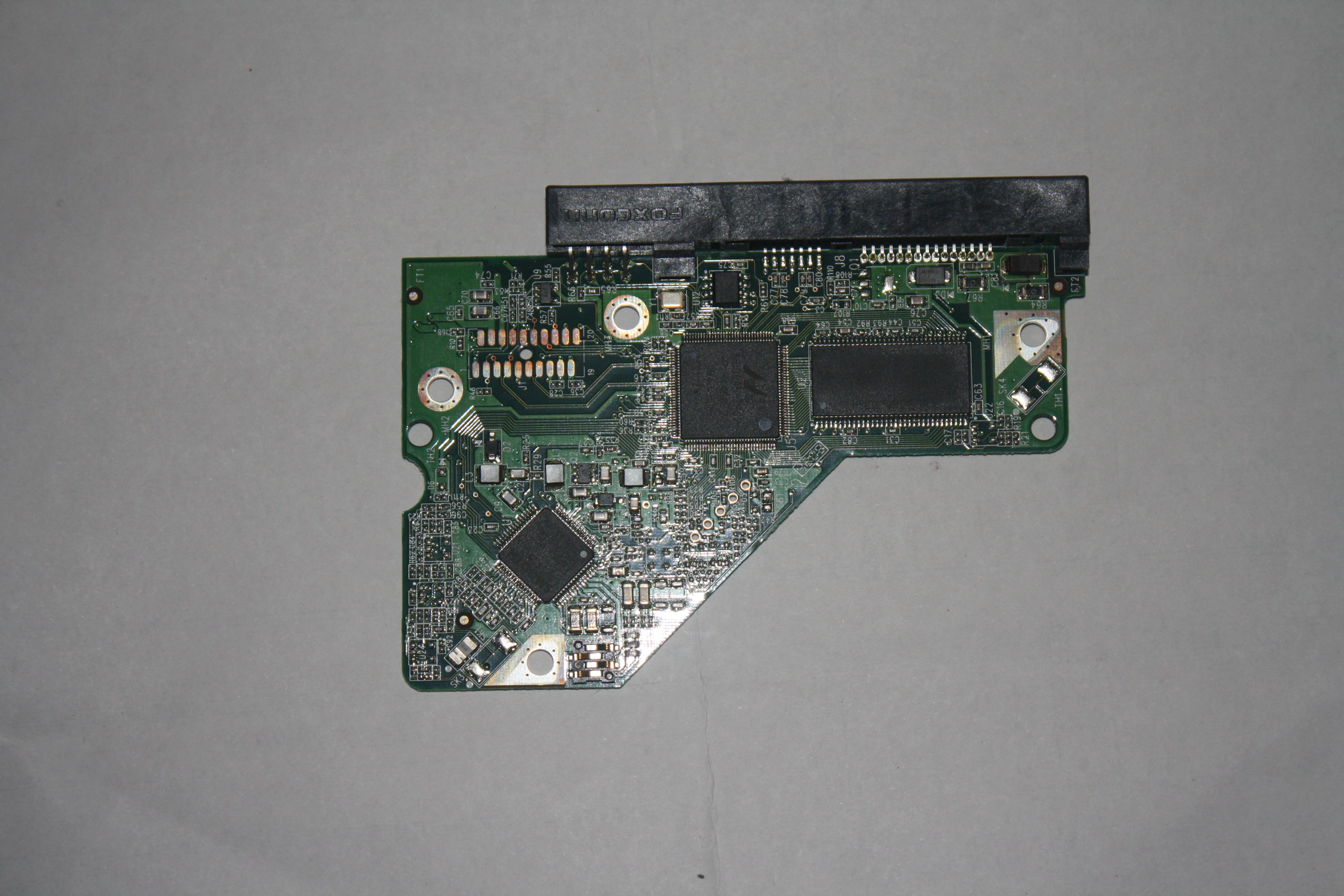

PostPosted: November 27th, 2011, 5:30
Joined: November 24th, 2011, 10:44
Location: Brisbane, Australia
Hey I have attached two images of either size PCB. I see on Image 1 the U12 (top centre) you refer to but I'm not sure what chip it's refering to if that makes sense? I also see that the numbers printed on the board are different to what is on the sticker so I'll see if I can locate a simliar board from the printed numbers.
If you need better images I'll try again tomorrow as I took these with flash cause I only just found some torx screw drivers to take it off and it's night time here in Brisbane.
PostPosted: November 27th, 2011, 9:22
Ok I am going to order 2 replacement PCB from here -> http://www.hddzone.com/wd-2060701640002 ... p-276.html
It seems to be exactly the same but the REV is not stated. Mine is REV A but I assume this does not matter?
Anyway I'll wait till next weekend to see if anyone spots anything but if not then I'll replace the board and remove the u12 chip from the patient board and replace on the donor as northwind suggested. I'm going to use this guide to solder it correctly -> http://www.diodes.com/pdfs/Ap02014_R1_Soldering.pdf
PostPosted: November 28th, 2011, 3:57
Posts: 3549
Yes the pcb on the link you provide would do for you.
You will need to transfer u12 from old pcb to new. Then keep fingers crossed and check your hdd.
If you see smoke again, and assuming everything was done right, then its game over.
PostPosted: November 28th, 2011, 8:01
Joined: May 6th, 2008, 22:53
Posts: 2138
@lillinz:
a) You haven't said (anywhere that I could find) what actually happened to cause the problem, but I expect you plugged-in the wrong power supply.
b) TVS diode D4 looks burned. If you're accepting the risks of DIY, then searching for TVS on this forum will give you lots of info, including some measurements you can make to confirm that diode has sacrificed itself.
c) "Biggest thing I have learned so far is that it's due time to get a sever and make backup with RAID."
Not all RAID is the same, and RAID is not the same as a backup! I suggest you do some more research so that you understand what (redundant) RAID does, and does not, do for you, and also what management you still need to do.
P.S. I strongly recommend that you take ESD (anti-static) precautions when handling the PCB and HDA, if you are doing DIY.
