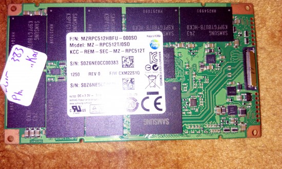

I have similar problem, can someone tell me how to change the SSD MZ-RPC2560 to sata. the connecter is 30 pins not 24

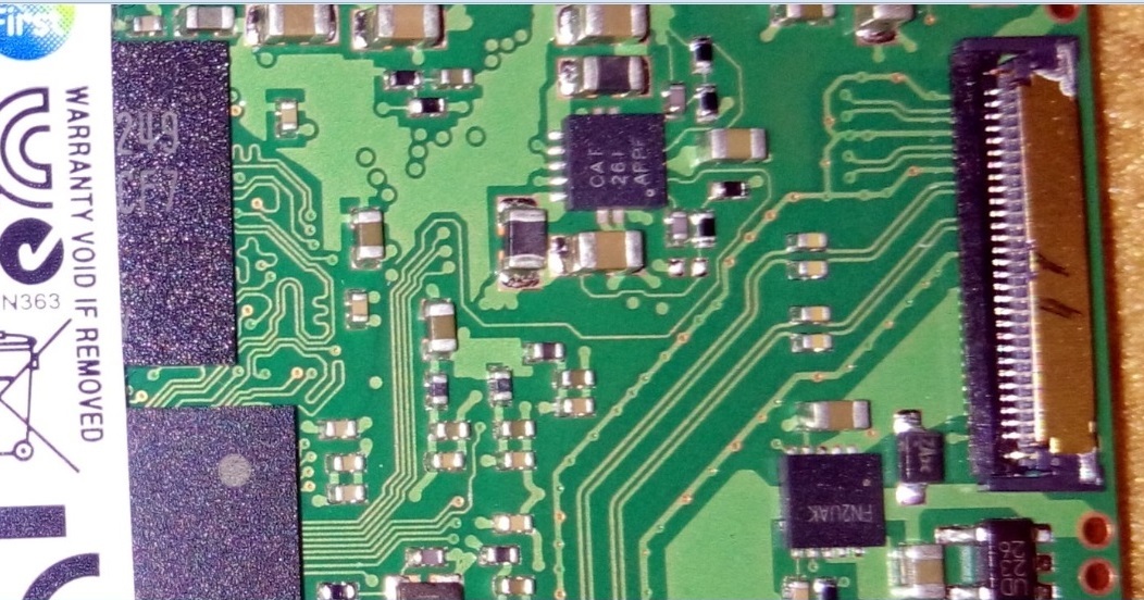

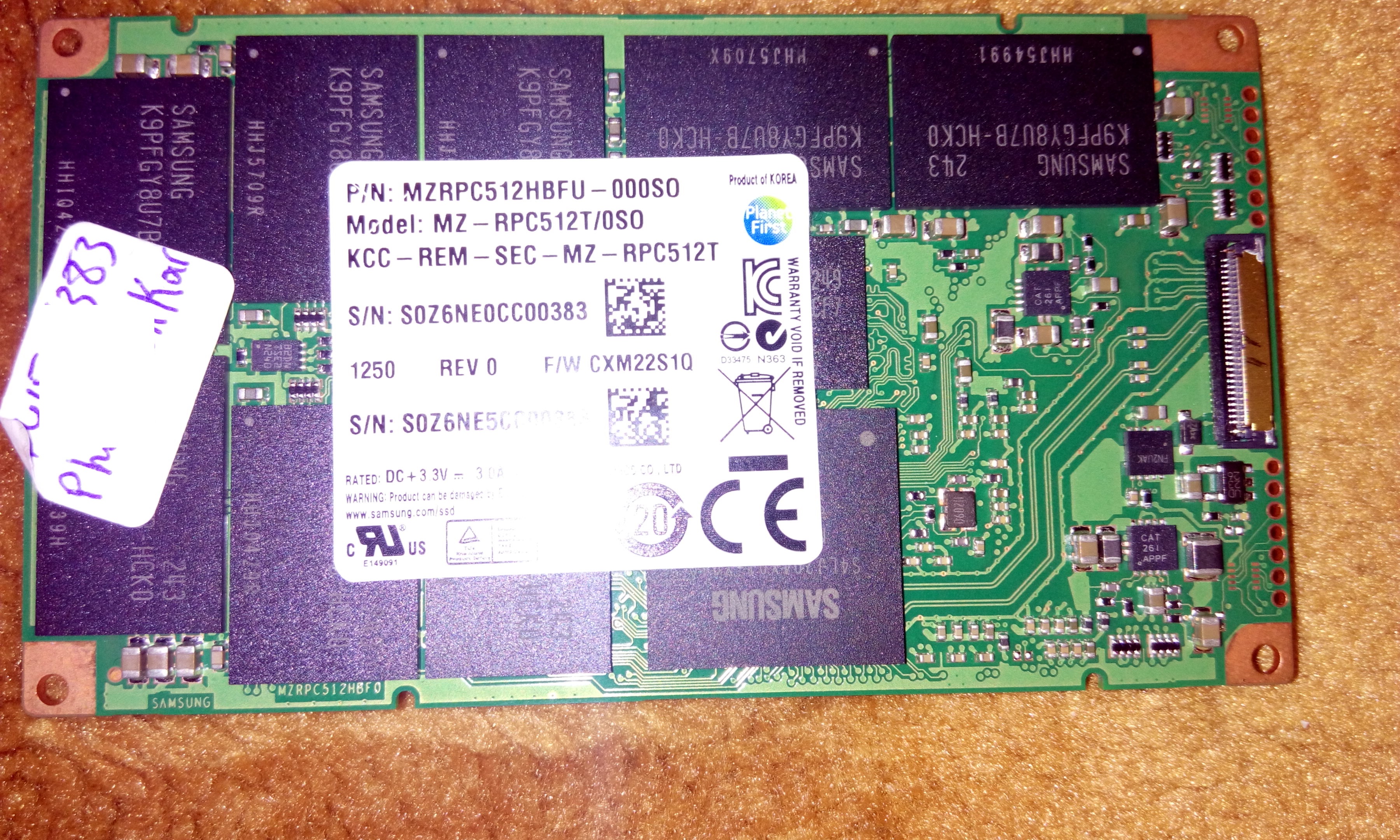

I have Samsung SSD MZ-RPC2560/0SO PN: MZRPC256HADR-000SO,The drive is okay, but i need to copy the data fro it, it has lif connector , 29 pins, NOT 24 pins,
I could not find an adapter, I need to change it to Sata.
The picture of the ssd is
http://i58.tinypic.com/22kxw4.jpg
I found some thing on the NET:
http://i61.tinypic.com/k9f2x3.jpg
 Post subject: Re: Samsung RAID LIF 128GB SSD, any adaptor for it?????
PostPosted: May 5th, 2015, 5:21
Posts: 17223

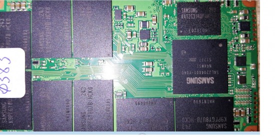

Obviously the card consists of two SATA devices, each with two SATA Tx/Rx differential pairs. You need to tap into each pair as you would for a normal SATA device, plus you need to supply +3.3V power to the card. There is no need to purchase an adapter.
BTW, here are direct links to your 2 images, without the images that "we might also enjoy":
http://oi58.tinypic.com/k9f2x3.jpg
http://oi58.tinypic.com/22kxw4.jpg

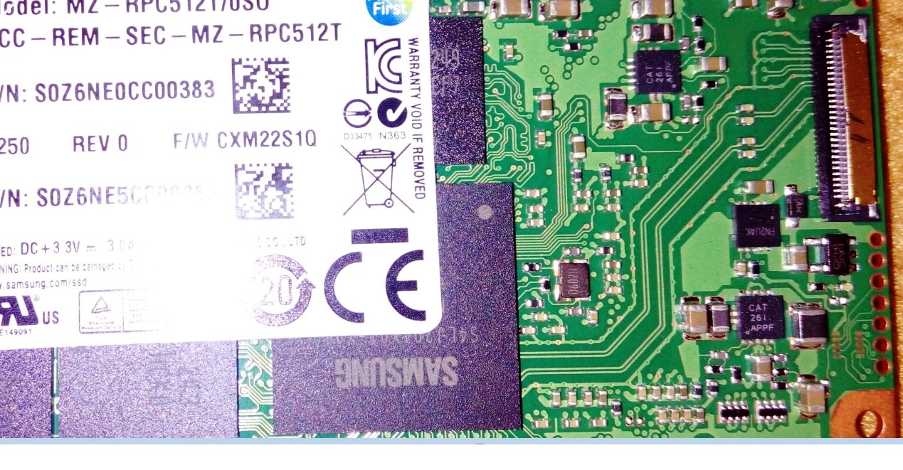

Thank you, can you guide me with the pinout of the connector

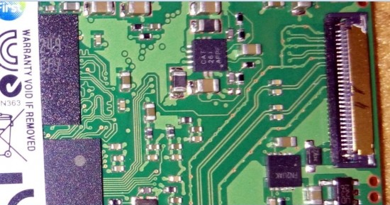

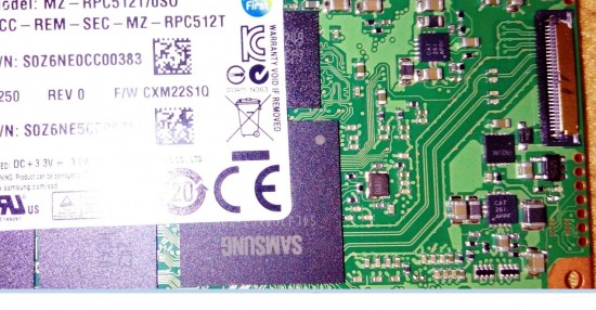

Can you upload detailed photos of both sides of your PCB?
What are the markings on the flash controller?
In which machine (model number of Apple, Sony, etc) was this SSD installed? Sometimes the service manual will have the pinout.

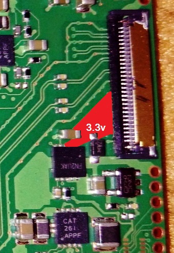

AISI, the PCB is powered from +3.3V according to the information on the label. There are two SSDs on the board, one on each side. Each SSD has its own SATA Tx/Rx differential pairs.
The photo you have provided has a 5V TVS diode across the 3.3V input. Using the markings on the diode as a reference, I have identified the +3.3V and ground points on the board. Please confirm this for yourself, as serious damage will result if I've got it wrong.
SD05-7, Diodes Inc, marking ZA, 5V, 350W, UNI-DIRECTIONAL SURFACE MOUNT TVS:
http://www.diodes.com/datasheets/ds31594.pdf
The SATA data pairs should correspond to the following pinout, either directly or reversed:
http://pinoutsguide.com/HD/serialATA_pinout.shtml

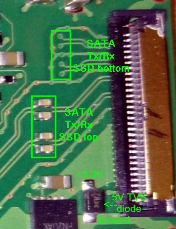

Thank you dear fzabkar, I need only 3.3 v, right?, I do not need the 5V

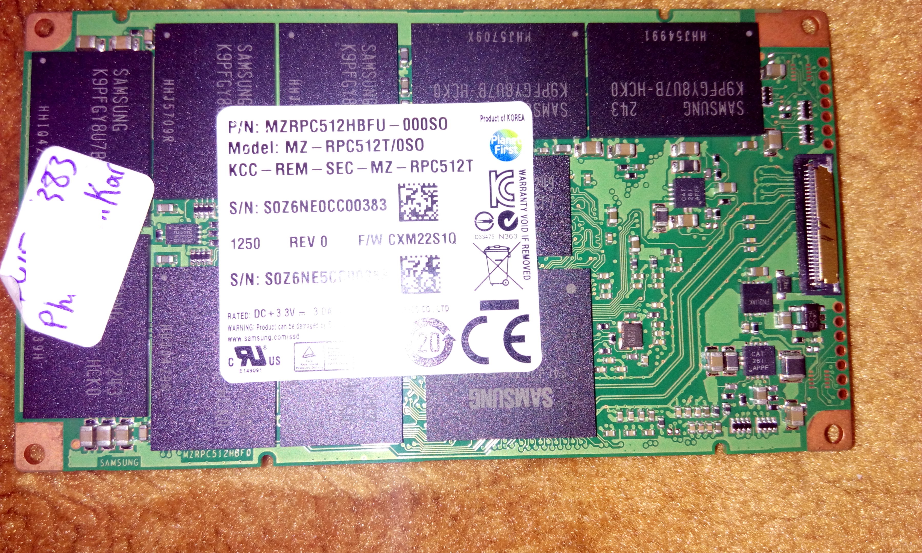

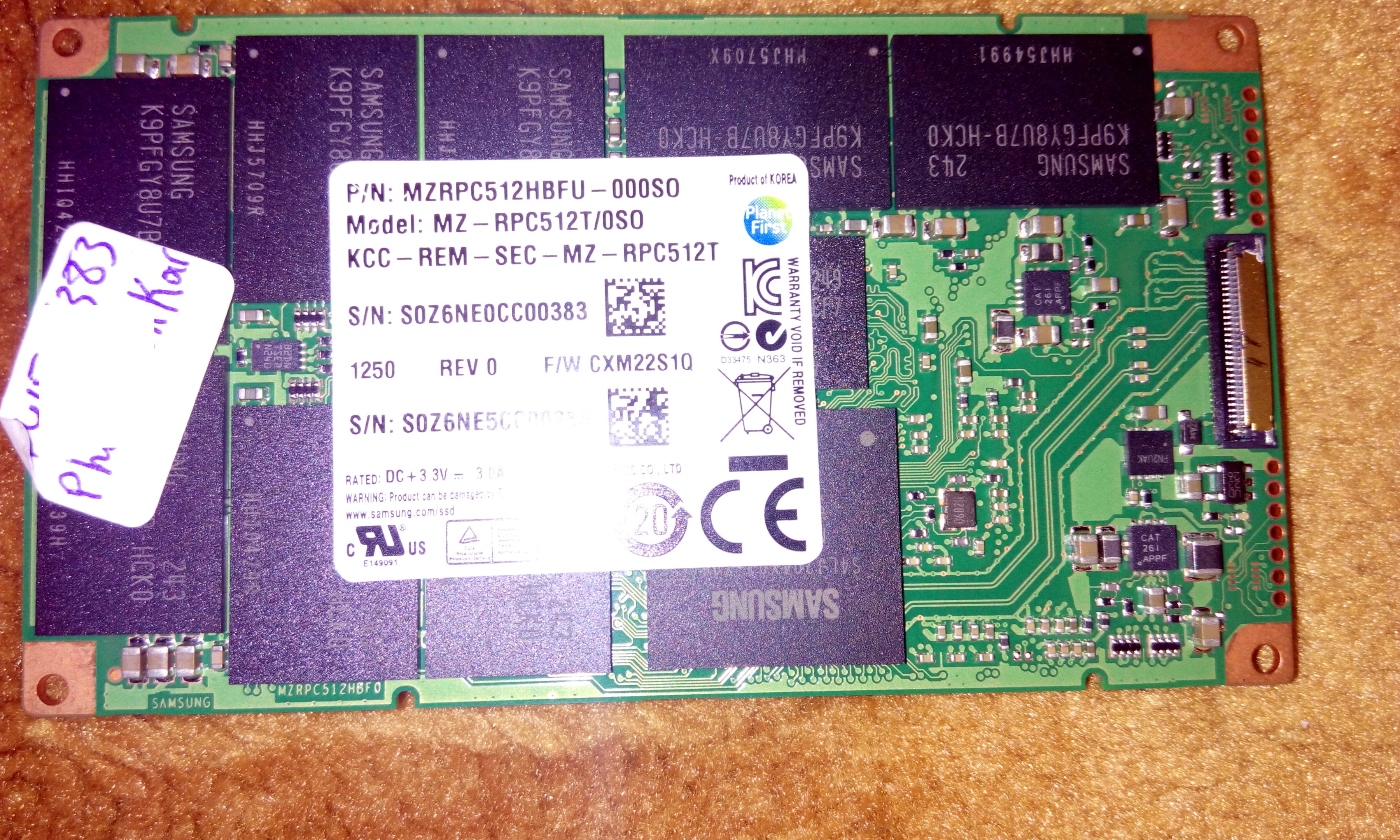

The Laptop is Sony , Model SVS13AB1GL pRODUCT NAME: SVS13A2APXS. I am posting the front and the back side, can you lablel mor clear the 3.3V. Thank you
PostPosted: May 5th, 2015, 21:43
Posts: 3971
it is pretty clear already, but here:

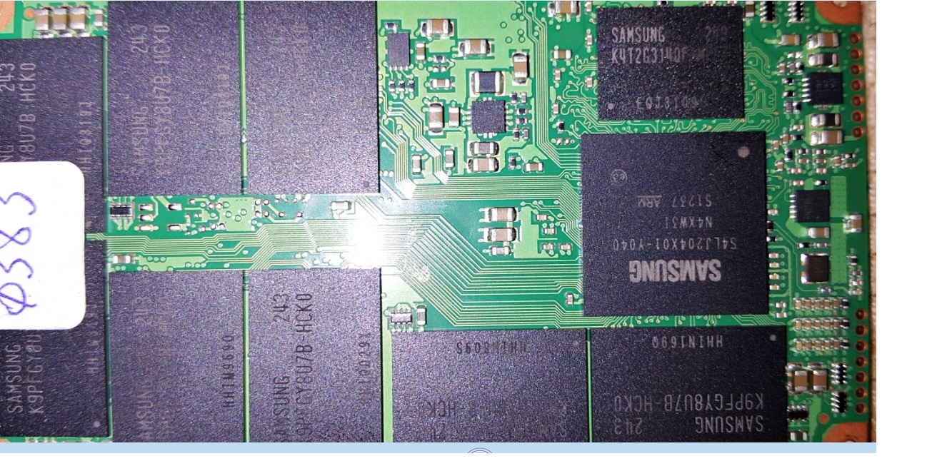

PostPosted: May 5th, 2015, 22:42
Posts: 17223
Here is a regular single SSD using the same flash controller (S4LJ204X01):
http://www.storagereview.com/images/Sam ... CB-Top.jpg
You can see how the SATA Tx/Rx pairs are wired to a regular SATA connector.
