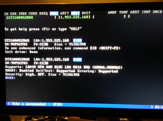

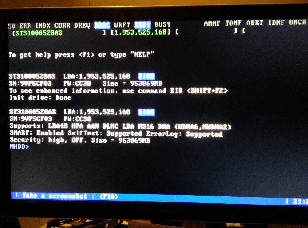

With MHDD have to modify BIOS setting to non-AHCI setting, skips my mind what the exact name of it is now.
But if the drive is not showing capacity in BIOS, then the issues are more advanced, firmware, mechanical, both, likely bad sectors to some degree.
Whatever you do, do not issue any random commands. You can brick your drive to no return. 7200.12 asa tricky drive.
 Post subject: Re: Seagate 7200.12 - need help with diagnosis and/or fix
PostPosted: August 15th, 2014, 1:25
Joined: February 8th, 2012, 15:34
Posts: 12
Location: California
You were absolutely right, I turned off AHCI and the capacity shows in BIOS as 1000GB
Also, I started MHDD and got the following screen shot after hitting F2 to get the drive information.

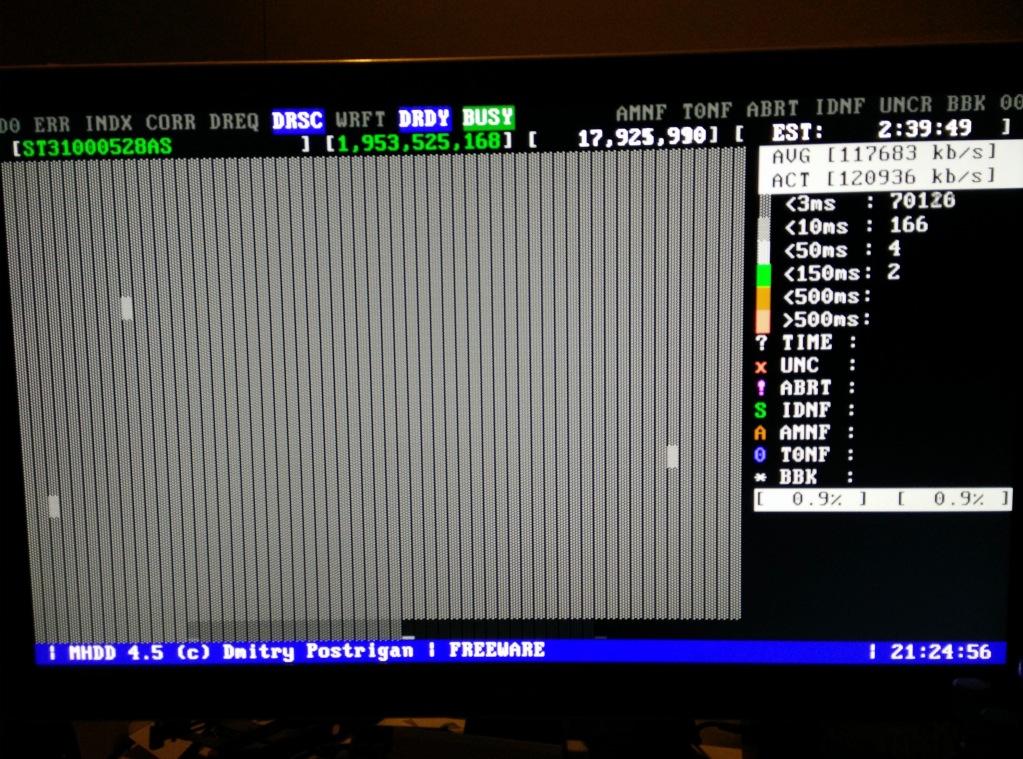

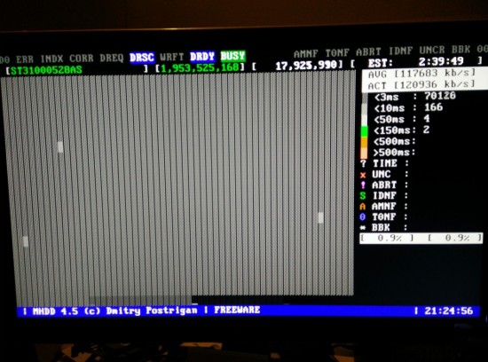

Also I tried the SCAN (F4) function, but I wasn't sure if I should do that, so I stopped it after a few minutes. It looks like the drive is recognized by MHDD now. With the above information what do you think is a good next step to try to recover the data?

So far so good.
The next step is to get a picture of the SMART values.
Then after is to use the F4 command, change the start to LBA to an LBA value close to the end, maybe like a million back from the end. Press enter and then F4 again. This will scan the end of the drive. The goal here is to determine if it reads LBAs at the end of the drive just like it has been doing in the beginning per your picture.
If it does read LBAs at the end, then try to clone per hddrec's suggestion. Take ample time and study what cloning software you are most comfortable with and more importantly the one that will not leave room for errors. Do not rush in choosing. Rather, I would even suggest you practice using another working drive to get a sense of how it works. Preferably something in DOS or Linux based.
Warning: A specialized hardware imager typically used by professionals will yield the best recovery results, therefore software based cloning applications are limited in their ability to deal with failing degraded drives, hence often increasing chances of further degradation on the drive.
