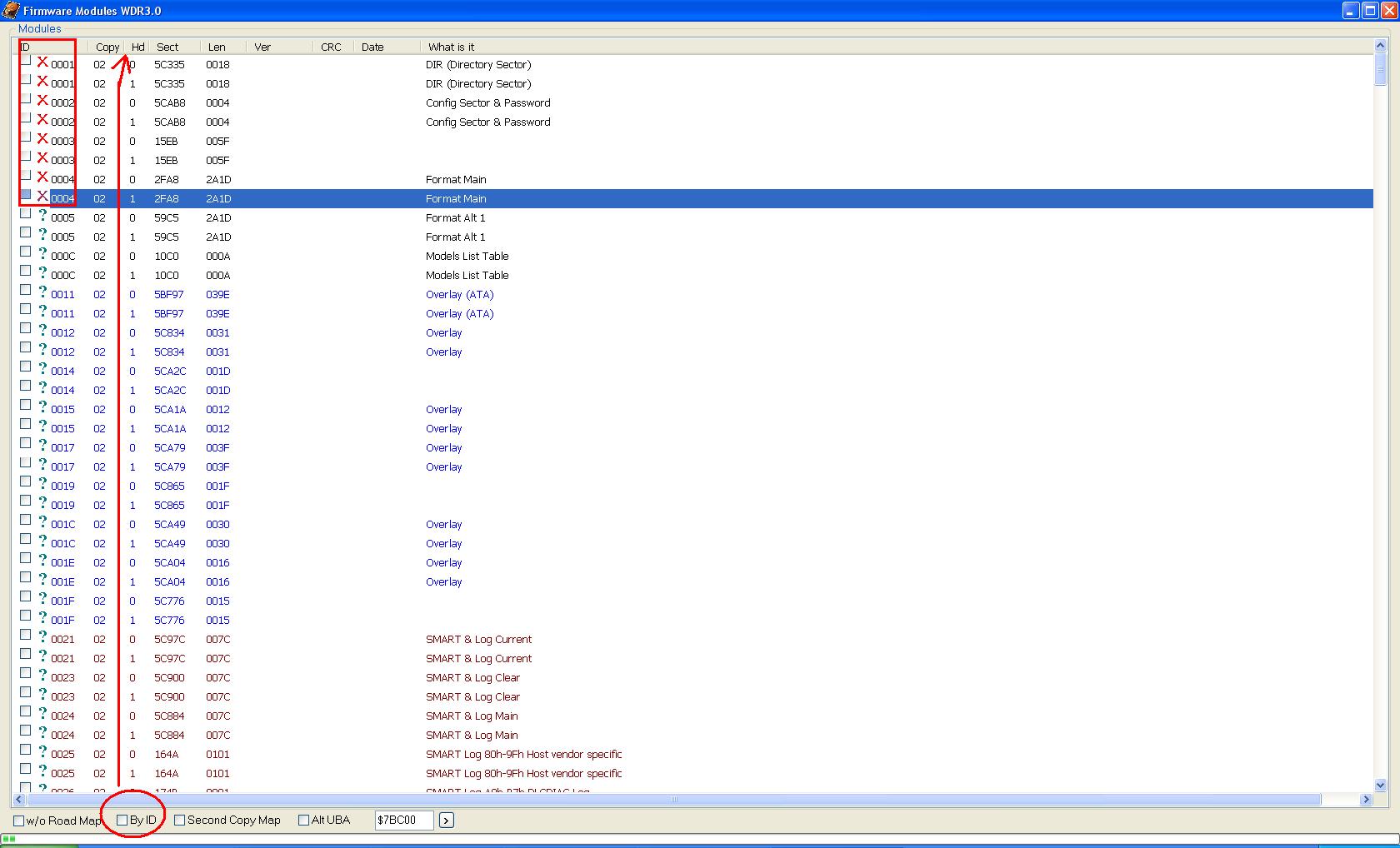

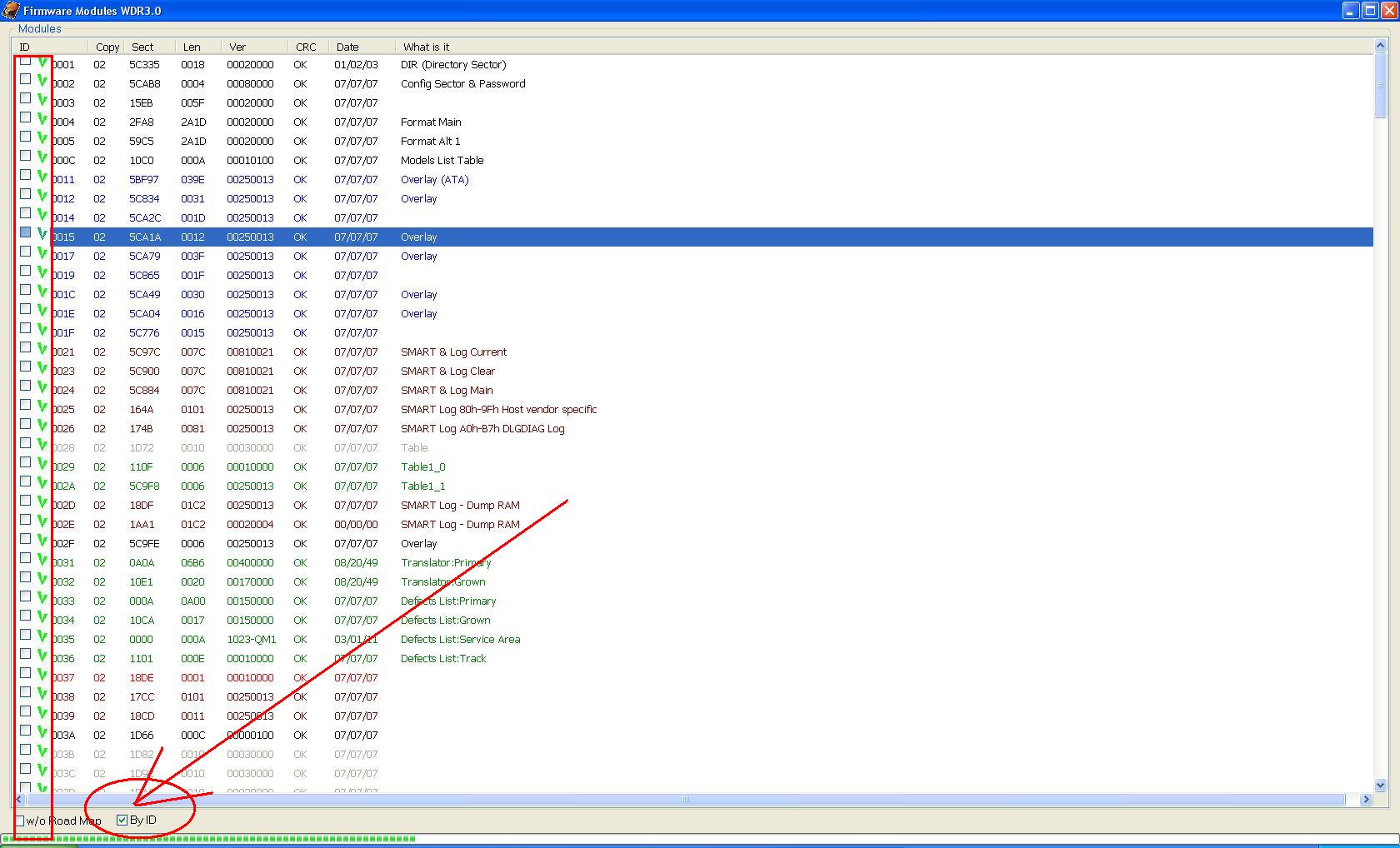

I tried 2 more MOD read with WDR.
1: Read with "by ID" ticked, which i already did few days ago, all module are checked as "good" with green mark.
2. Read with "by ID" unticked, all modules are checked ad "bad" with red mark.

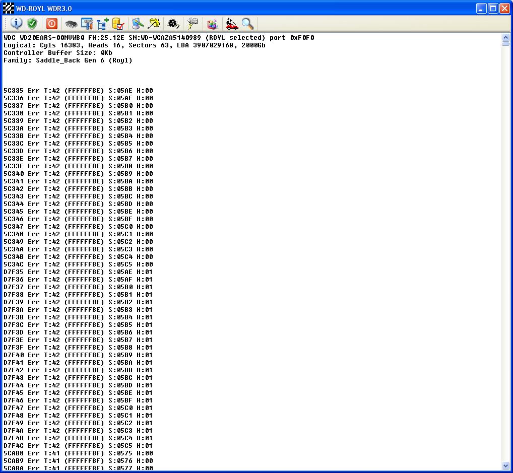

In WDR i get this errors log when i try to read with unticked "by ID".
Someone does know if this is due to software bug or to faulty drive?

SA 2nd copy is on head 1?
If i untick "by ID" i get error on head 0 and also head 1 :?

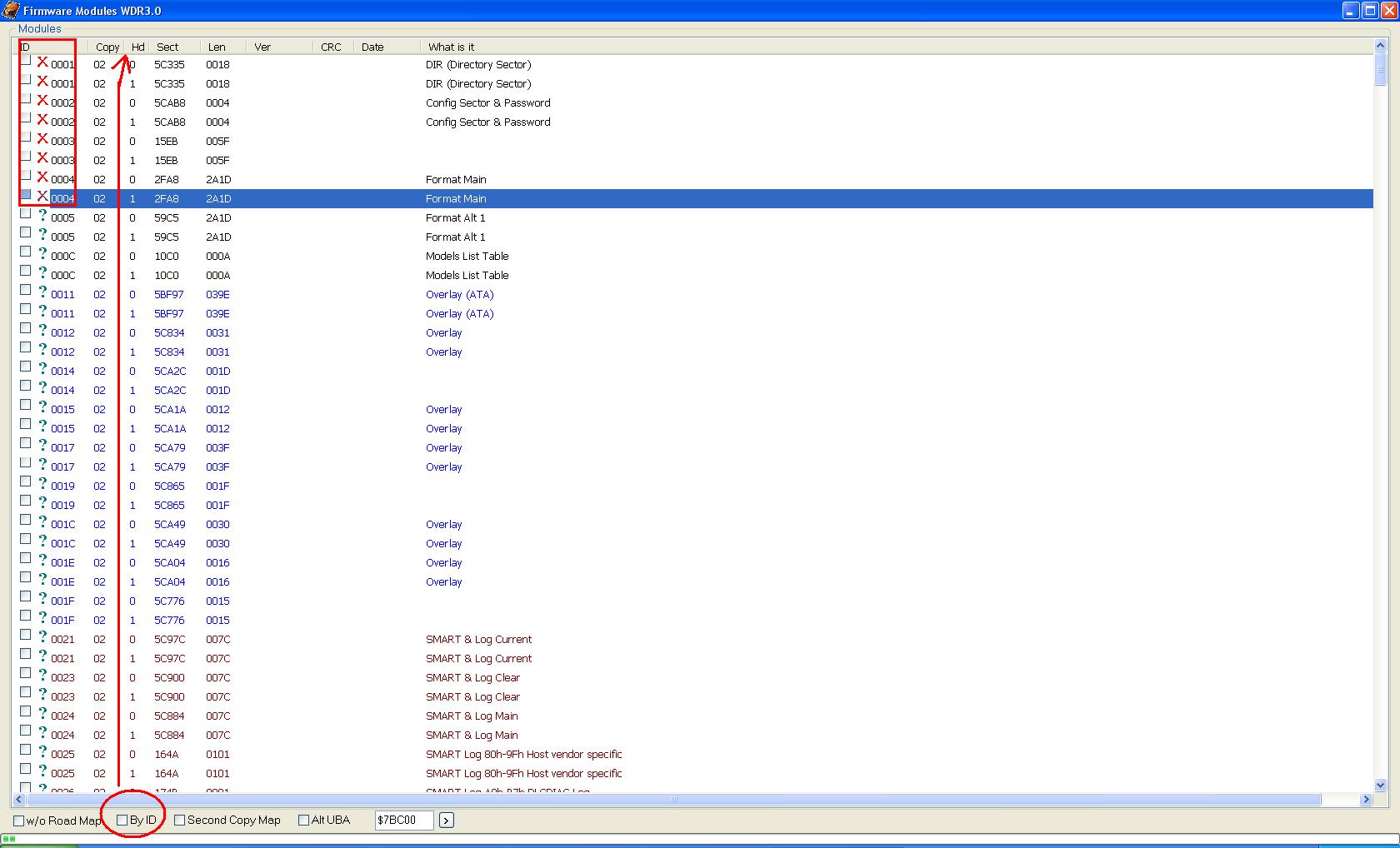

In the module window i see only "02" under copy, also with the good drive
i can't access to copy 01 even in the good drive, because it always show me only 02 :?
could be a software bug or i'm doing something wrong?

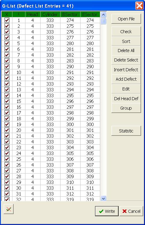

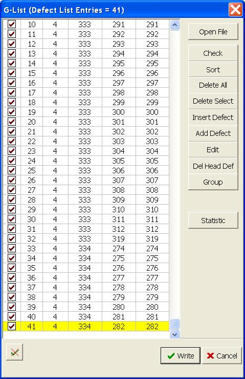

As you can see in one of my firt post, Sediv showed at the begin G-list report on head 4.

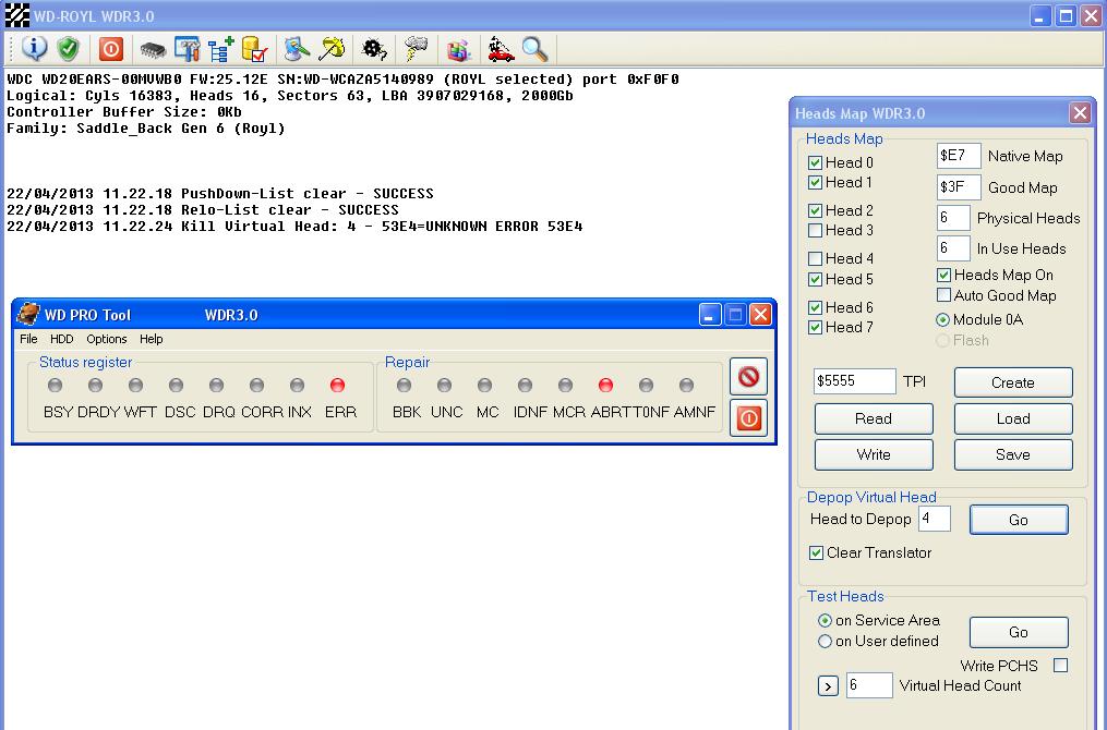

So I decided to depop head 4, but something went wrong, look to the pic on bottom:
I got "Unknown error 53E4"

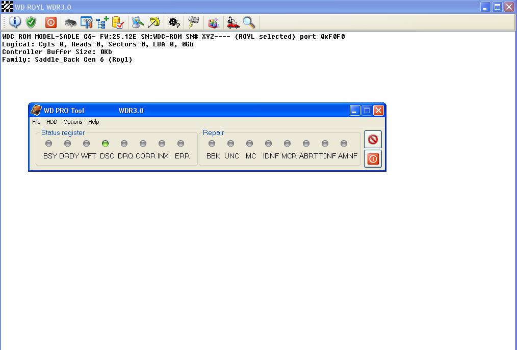

Now i'm not able to turn on the head, drives spins down and is shown in WDR as in the pic in bottom:
I guess problem is on head 4, but i don't understand why doesn't load SA now (SA gets read by head 0 and 1, am i right)?
It's game over?
My firmware database:

Neither of those did work!
P.S.
I'm able to keep motor running if i do "ATA soft reset" + "ATA Recalibrate"
If i do Road map via enumeration it shows modules but i'm not able to read or write them
