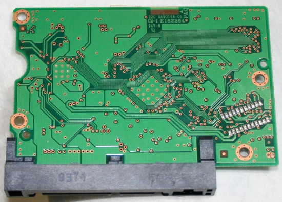

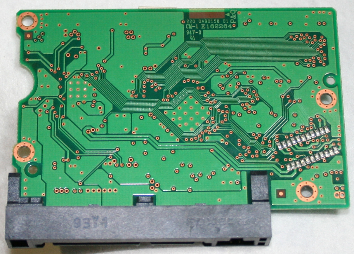

Perhaps jono-ats may be able to work with the little information you have given him, but I can't. I need to see the underside of the PCB.
13hm13 wrote:
I do have a pic of the other side of the PCB, and will upload later.
I'm still waiting. BTW, I've only recently been through this same procedure with someone else, so it shouldn't be too difficult. Unless of course jono-ats can save us all the trouble ...

fzabkar: per your request ... Rear of PCB...

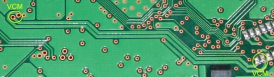

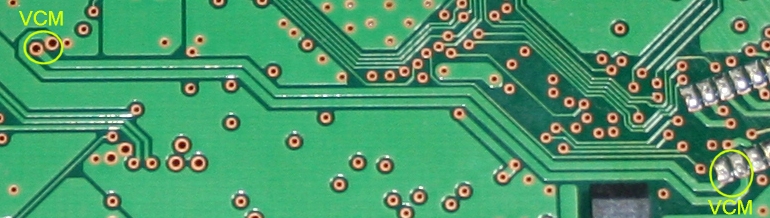

Your VCM pins match those of another Hitachi model that I have recently analysed.

I checked a head stack that was removed from a Hitachi, and assumed the lettering on the connector had the same orientation as yours on the . Sorry if I erred. Anyway, the two pins in question are adjacent towards an end, and should measure a low value as noted.

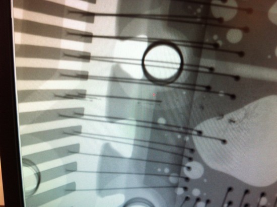

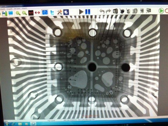

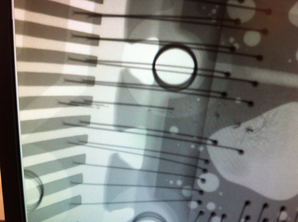

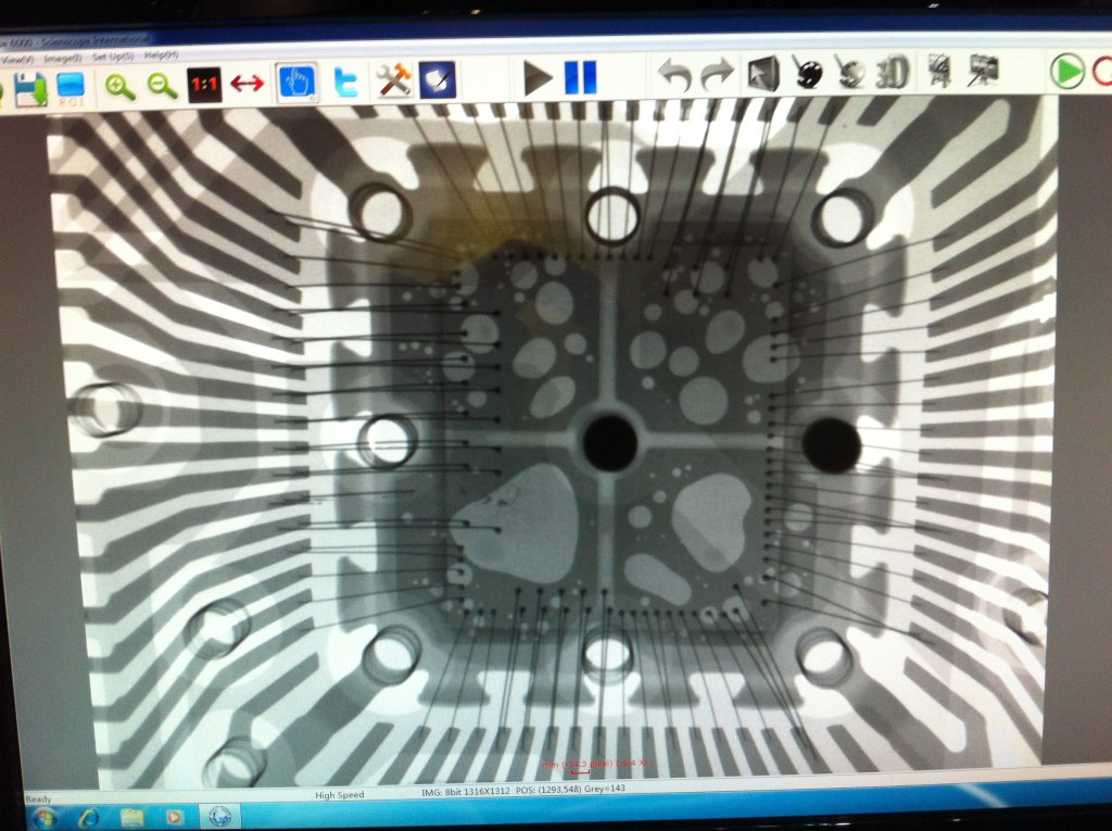

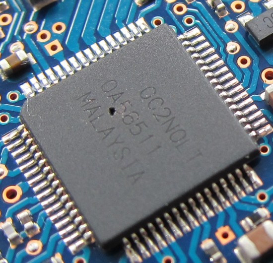

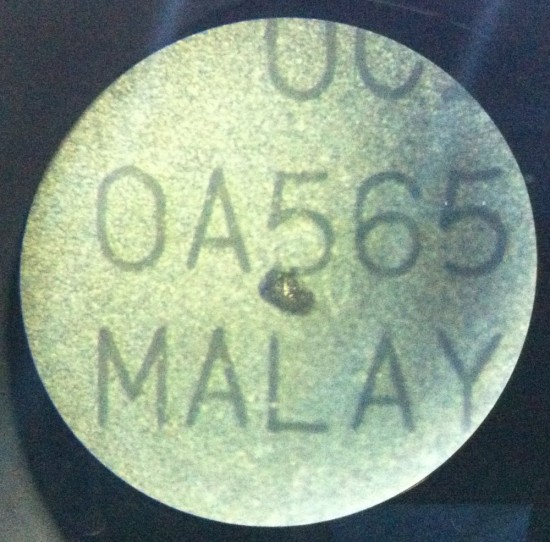

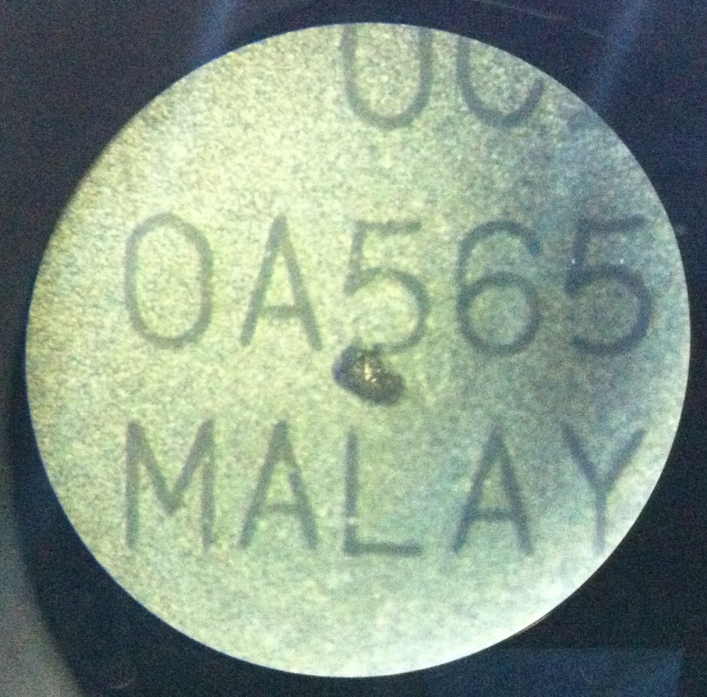

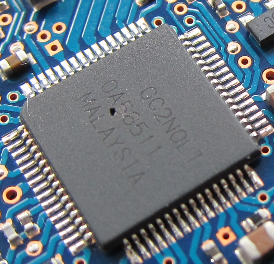

Ok, back to MY HDD for a moment.....
Eagle eyed user "fzabkar" spotted that black spot on the motor driver IC. And I thought, even though it's not helpful in my case, but it's still interesting to have a closer look. Unfortunately I had no SD card with me and had to take pictures from the screen.
Some notes to the pix:
• On the IC picture I could look down to the metallic chip. That hole is deep!
• Three of the gold bonding wires of the IC evaporated (overheated). The there wires go most likely to the same spot, there were used because of the higher power requirement.
• On the X-Ray picture, under defect is one big air bubble. That could be a assembly/soldering defect. Or the bubble was caused by overheating. It is most likely some heat conductive glue between the IC chip (we call them 'dice') and the metallic leadframe.

Thanks for posting the X-ray pics, very interesting indeed. It would be great to have that level of certainty with alot of other cases :-)

We have an X-Ray in one of the assembly factories we work with (to check BGA soldering), but I seldom go there nowadays.
I actually took them at an electronics exhibition (Nepcon) were the demo some X-Ray machinery. Keep that in mind if you want to visit the Productronica in Munich in November. And be smarter then me and bring a USB stick!
