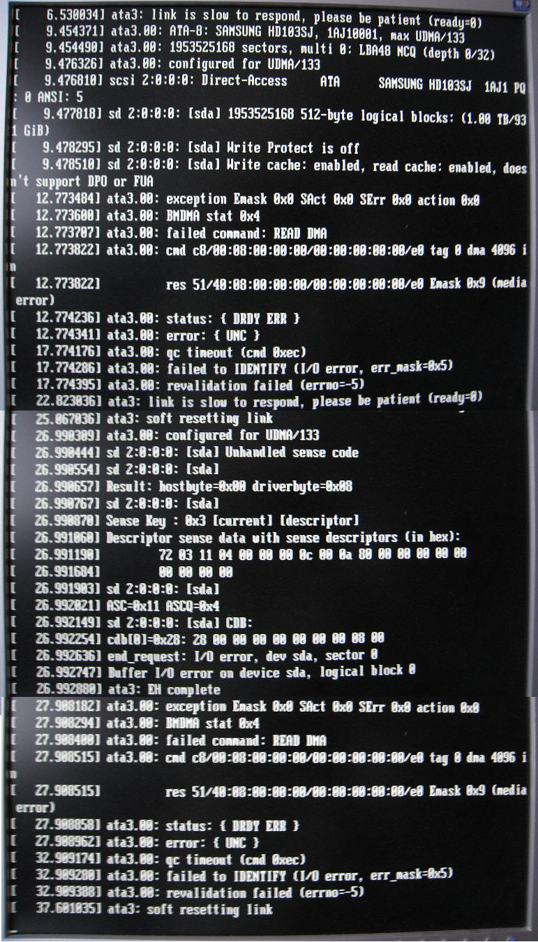

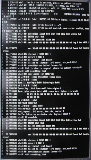

I tried starting linux from an USB boot stick, but the HD103SJ is not recognized by the BIOS (it hangs).
Then I disconnected the SATA cable, and connected it after the POST, just before linux started loading.
Linux tries to communicate with the drive, but without success - the HD103SJ is not shown. There are two cases:
a) within the first 2..3 minutes after power-up - while the terminal output takes place - the drive somehow responds (Linux_log.jpg)
b) if I delay the linux startup until the HD103SJ terminal output is finished, the drive does not respond in any way (Linux_log2.jpg)
I cleaned the HDA pads as they didn't look perfect.
The drive spins up very smoothly and doesn't make any unusual sounds. Can the heads or surface however be damaged, that it can't get ready?

 Post subject: Re: HD103SJ dead
PostPosted: December 19th, 2019, 12:20
Posts: 849
">>Flag=00000C8B BadHd=0000 dFod=003E 0026 0029 0024 (t=8773 c=24)"
It seems to me that Hd 0 is bad, but I could be wrong.....
The SMART is not initialized so the drive is rejected by the BIOS and the OS.
