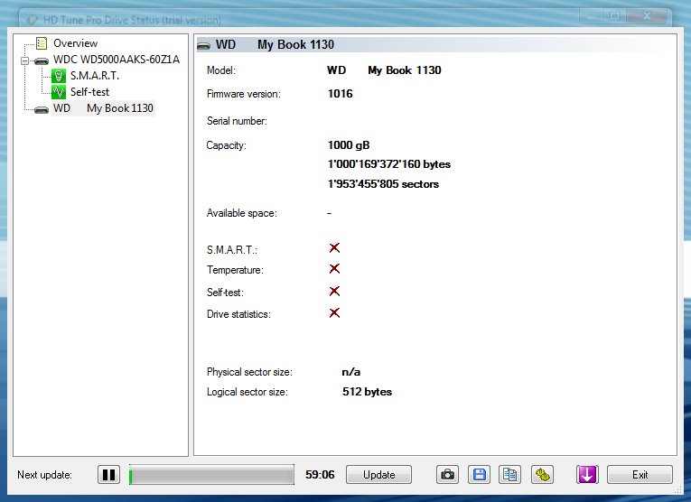

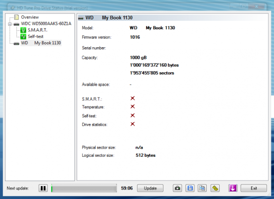

that is the only data i could take with hd tune pro drive status

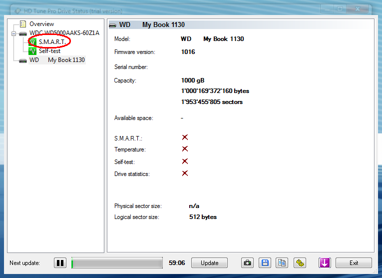

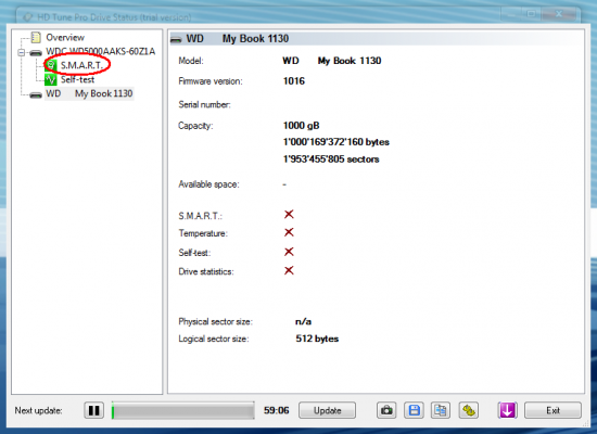

click on smart to show us smart attribute.
P.S.
Sorry, that i marked with red circle is for another drive, right?
Maybe even HD Sentinel is not able to access to smart from external drive, or smart is damaged

michael chiklis wrote:
Maybe HD Sentinel is better for external drive detection, try it.
Agreed. HD Tune tries to communicate with the drive behind the USB-SATA bridge. If it fails, it then displays whatever is reported by the bridge.
CrystalDiskInfo (freeware) is another good tool, as is smartctl (smartmontools) for Linux.
