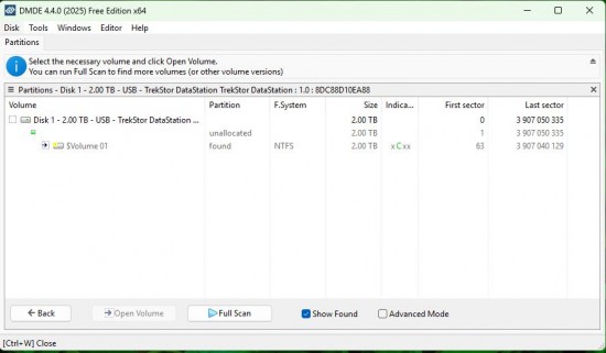

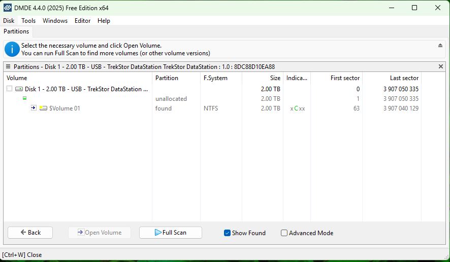

Congratulations! Sorry, I have to ask, did you reinstall your drives in the correct order? Is it a RAID 0 or a JBOD?
Can you show us the Partitions tab for the combined drives in DMDE? Can you then install each drive in your computer and do the same for each?
https://dmde.com/
If DMDE doesn't detect any partitions, can you show us sector 0 of each drive, both inside and outside the enclosure? (I'm looking for hardware encryption.)

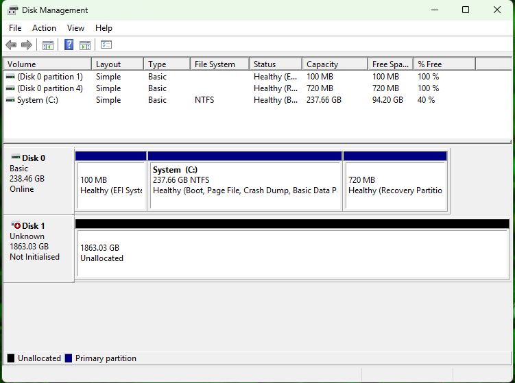

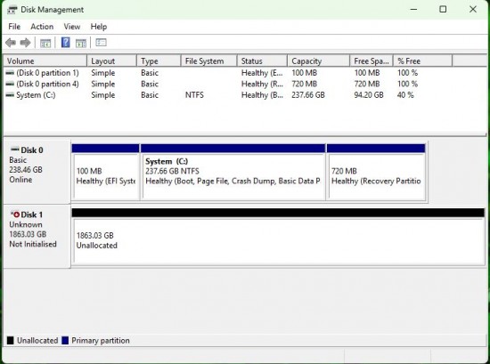

Hi All and fzabkar,
To my understanding this is just a JBOD. From what i was reading, controller of the enclosure JM20336 is not supporting RAID and no encryption.
This is how the win disk manager identifies the enclosure after the hardware fix.
And the DMDE

The standard IDEMA capacity of a 1TB HDD is 1953525168 sectors. Your enclosure is reporting a capacity of 3907050336 sectors, which is exactly double. DMDE finds a copy (C) of the boot sector, but it doesn't find the boot sector (B) or a file system (F).
Were the drives reinstalled in the correct order?
 Post subject: Re: Fried Smooth L7251 controller, possibly fried board WD 7
PostPosted: November 25th, 2025, 4:30
Joined: October 30th, 2025, 4:31
Posts: 19
Location: Dublin
Hello fzabkar,
Yes, drives were reinstalled in the correct order. I have marked them before the removal.
I used R-Studio in the end, and managed to recover almost all files from the drives.
R-Studio was not able to read some sectors during the scan, that suggest these drives got bad sectors during the power surge.
S.M.A.R.T also reported relocated sectors.
This can explain why MFT became corrupt.
