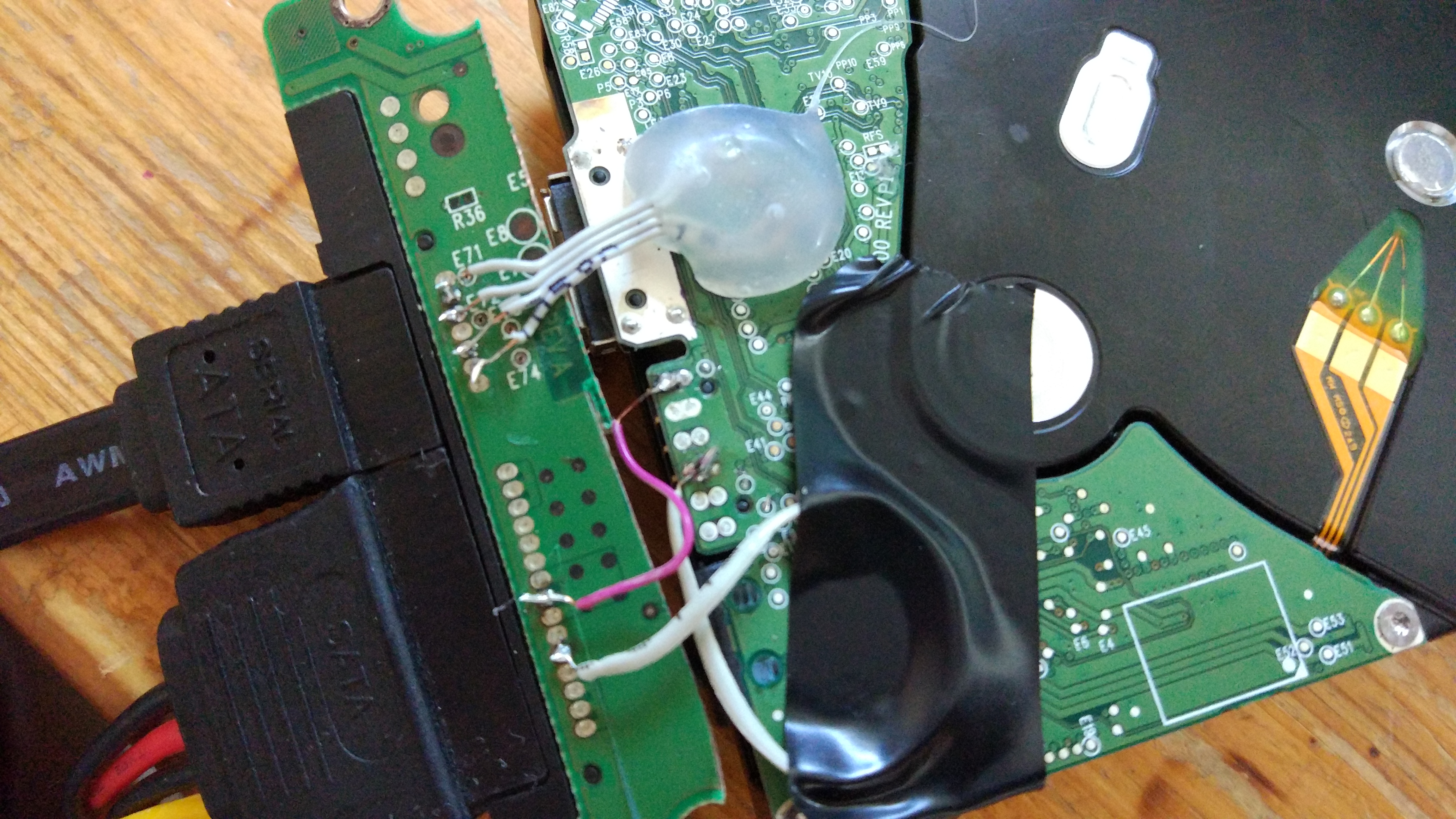

Posts: 331
Hello friends!
I have a case with this kind of drive (WD30NMVW-11C3NS2)
I think the drive has a slow responding problem, but i cant access to SA.
I converted the USB PCB to SATA (yes, is removed capacitors), but now the drive stays BSY forever even when i short TV9-TV10, or separate HSA contact.
Here it is a picture of my USB-SATA conversion work.
Has anyone a deal what did i wrong?
 Post subject: Re: New WD 3TB 2.5" Passport
PostPosted: January 18th, 2017, 9:41
Posts: 1038
Location: South Africa
I've only done about 5 so far and all have been straightforward, converted to SATA by means of 2060-800022-000 and then imaged them. I haven't had the joy of one staying BSY yet.
PostPosted: January 18th, 2017, 18:26
Posts: 331
It means my USB-SATA conversion work is failed :lol:
PostPosted: January 20th, 2017, 23:17
Joined: November 27th, 2012, 21:59
Posts: 94
Location: Upstate NY, USA
saltwater wrote:
I don't think so. I don't think you would even be able to tell the drive is in busy mode if you soldered it wrong, but you should get a second opinion on this.
Otherwise, try putting the drive in kernel mode and following the instructions here: http://blog.acelaboratory.com/pc-3000-h ... oblem.html
