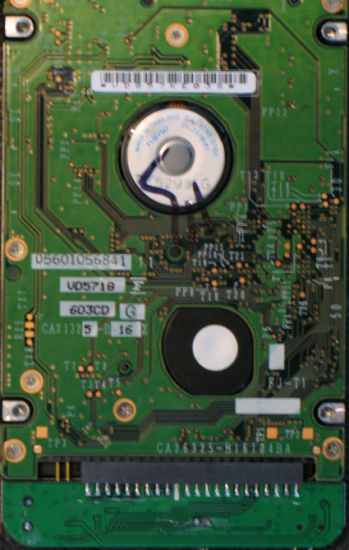

maximus wrote:
Only pictures of the actual drive are useful
Not so fast

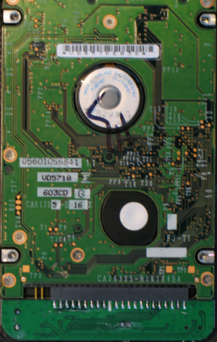

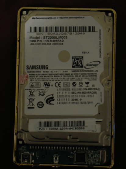

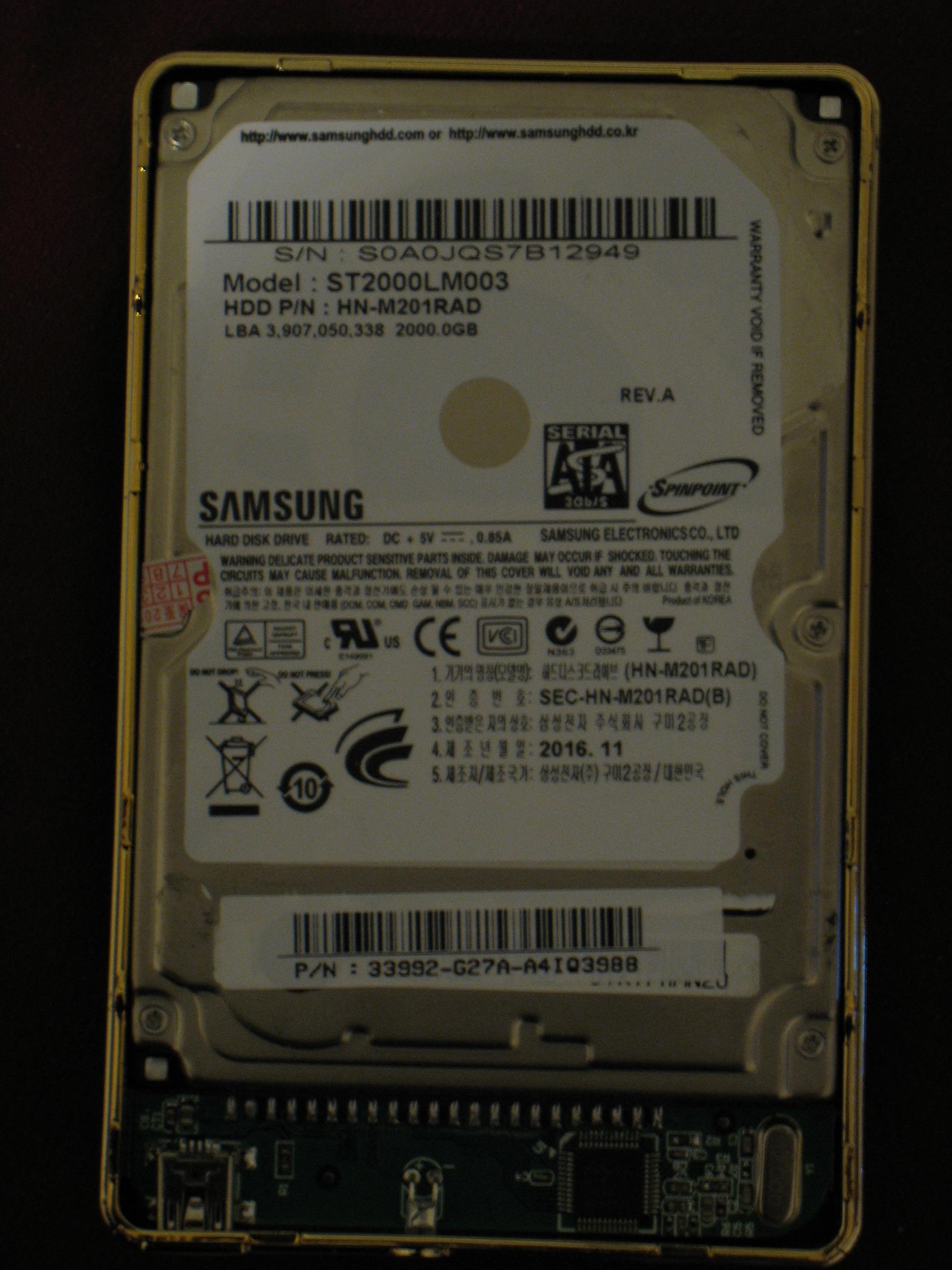

Below is attached a picture of an HDD sold by the ....... Chinese on aliexpress claims to be a 2TB Samsung HDD
(Came to me because the owner claimed that's showing raw 1.8TiB, trying to repartition the drive it shows only 55GiB.)
Opening the enclosure I couldn't stop laughing, they actually even bothered to print a nice label (2)
To check what HDD it really is...
Its an old PATA Fujitsu 60GB :lol:

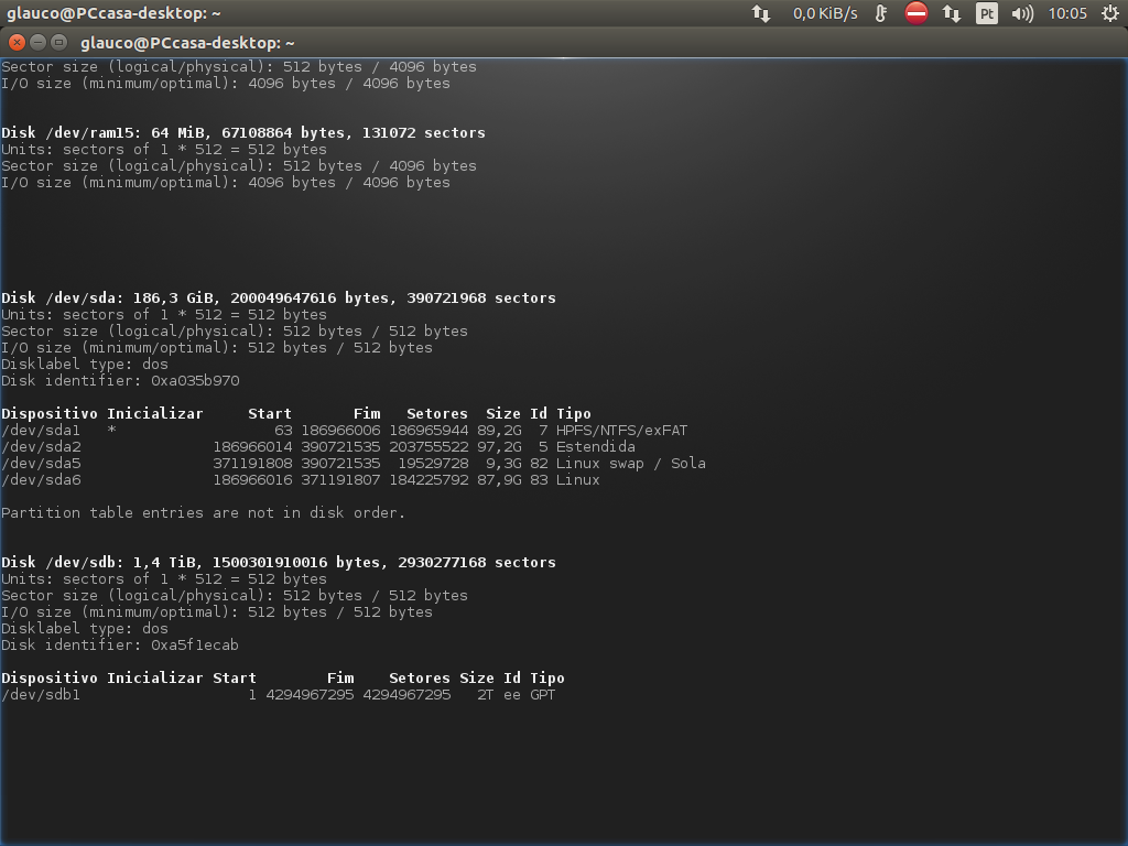

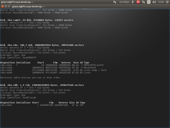

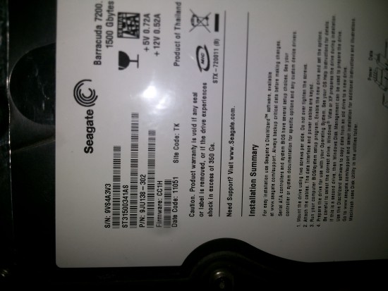

Hello, I'm sorry. At first, I did not know there could be a difference between the description of the box and the real drive. Second, I did not know it was possible to open this case. Third did not know how to open this case. I learned all this. Thank you very much.
And to my surprise, apparently, the drive has 1.5GB, is this it?
SMART Report:
(2) ST31500341AS
Enclosure : ST315003 41AS USB Device (V=152D, P=2338, jm1) - st
Model : ST31500341AS
Firmware : CC1H
Serial Number : 9VS4A3V3
Disk Size : 1500,3 GB (8,4/137,4/1500,3/1500,3)
Buffer Size : Unknown
Queue Depth : 32
# of Sectors : 2930277168
Rotation Rate : 7200 RPM
Interface : USB (Serial ATA)
Major Version : ATA8-ACS
Minor Version : ATA8-ACS version 4
Transfer Mode : ---- | SATA/300
Power On Hours : 14586 hours
Power On Count : 6395 times
Temperature : 38 C (100 F)
Health Status : Alert
Features : S.M.A.R.T., AAM, 48bit LBA, NCQ
APM Level : ----
AAM Level : FE00h [ON]
Drive Letter : F: J: K: L: M: N: O:

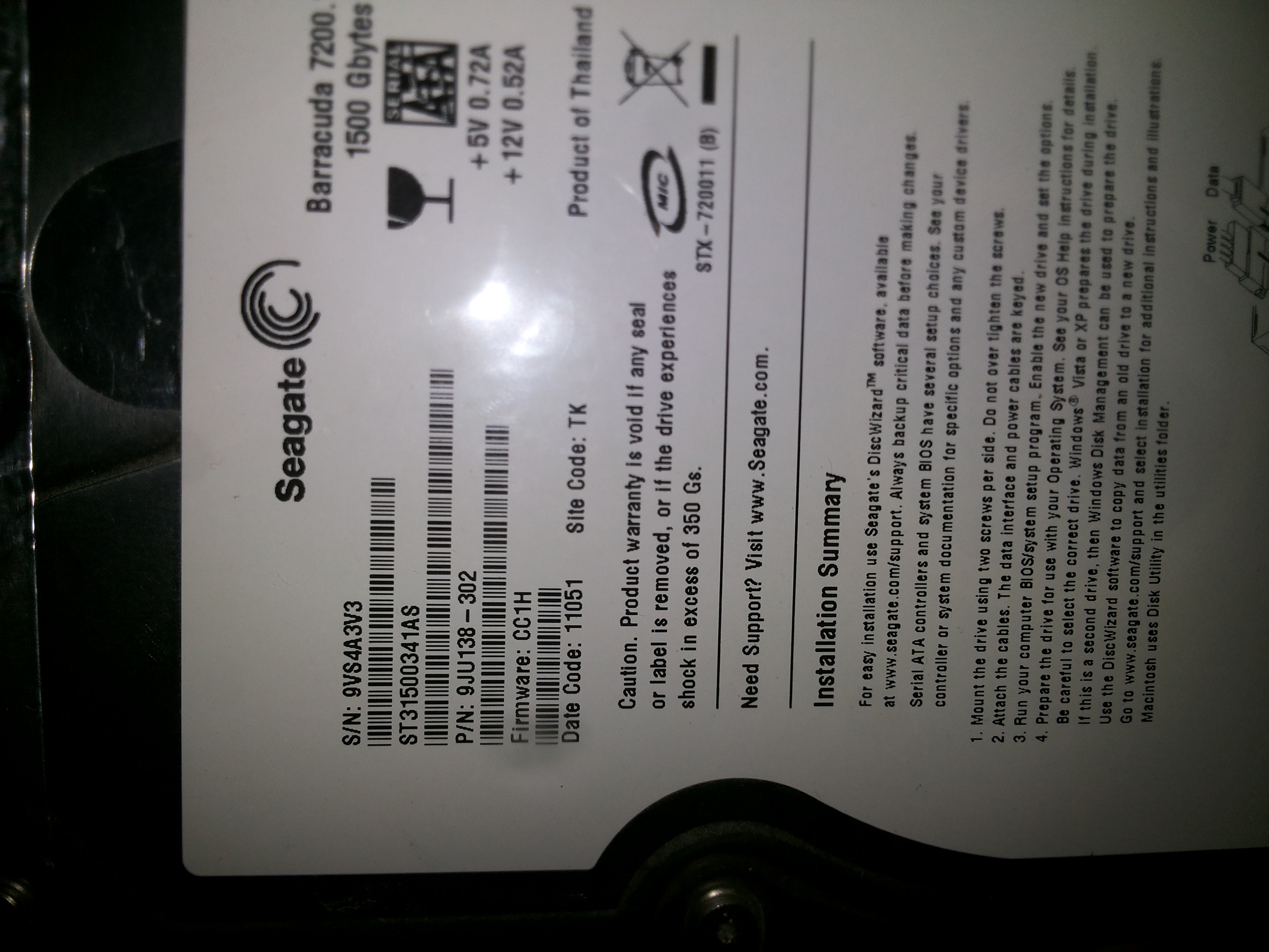

Well, seems you have a 1.5TB hard disk. If that one came from the 5TB enclosure, take it to the seller and complain to him.
As for your cloning, get a real SATA 4TB or 5TB disk ( if possibly, not Seagate ) then you can continue.
Oh, please, post a picture of the label of the 5TB->1.5TB drive.

Also, please provide the full output of fdisk -l, with both hard disks connected to the machine.

OK, i forgot!
Later I´ĺl provide the full fdisk information.
These days i'm very, very busy. But i´l do it.
Thank you so much for the patience...

Well, if that is the disk that was inside the 5TB box, you were duped. Have you paid around R$ 700 - R$ 900 for that disk ? or have you paid much less ?
If the thing was cheap, it is a fake. If you got it as a gift, maybe some friend fixed a broken one with some hdd they had and gave it to you.
Either way, for cloning that 4TB disk , you need a 4TB one ( or bigger ) . Until you get one of those, nothing can be done.
If you need the data in the 4TB disk , better take it to a data recovery firm than risk working with the original disk withou a copy..

OK. The HDD was a used gift.
I will get a 5 tb hd and I will post the results as soon as I can.
