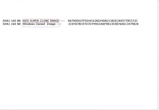

One other thing to do would be to compare the two cloned images. If there are any differences, then these might illuminate the nature of the problem.
 Post subject: Re: Cloning Tool
PostPosted: June 8th, 2017, 3:50
Joined: March 9th, 2017, 6:16
Posts: 127
Location: trinidad
Hi fzabkar
Thanks for keeping this thread alive
I have calculated 160Bit SHA1 for both images , both signatures are different. I think I have stopped cloning for different intervals after bad sectors were started appearing . Thank is the reason SHA1 is different.
If I have taken SHA1 for only good part probabaly it would been same.
I can give remote access to both files ,in case if someone wants to experiment . Pls. PM me for the same so that we can schedule it.
Thank you
