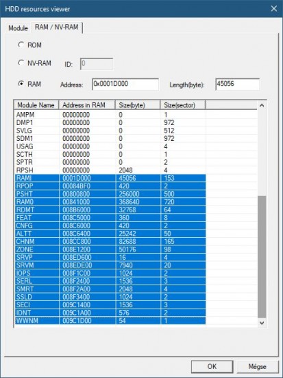

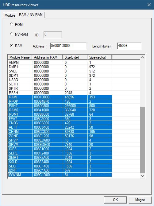

Re: HITACHI-ARM FIRMWARE RECOVERY.
February 3rd, 2023, 4:33
Maybe the problem with my loader is i used USAG module wich point to ABA address, and not to RAM address.
.....and some module size are different in RAM compared to ABA module size.
February 3rd, 2023, 4:52
Just thinking.....
Maybe we have to build a loader that contents a RAM module map (USAG section in loader) using modules highlighted in this picture above with correct RAM address and sectors:
