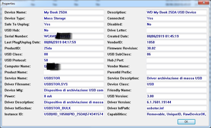

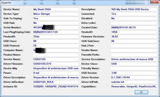

I wonder if the WWN of the My Book device shows up in USBDeview?
 Post subject: Re: PCB 0J35276 BA5145B for WD80EZZX-11CSGA0
PostPosted: June 7th, 2019, 22:23
Posts: 1768
Location: Verona, Italy
My firmware database:

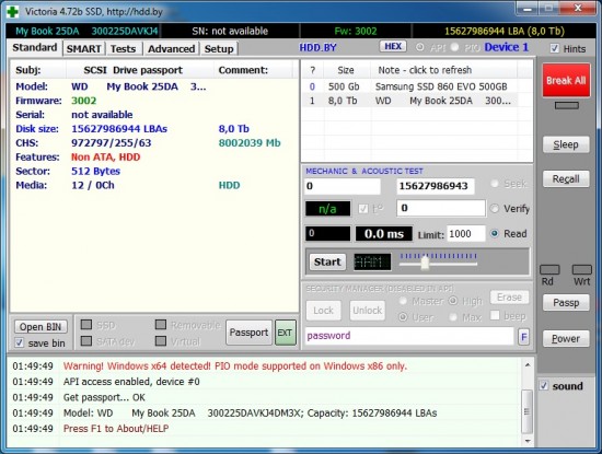

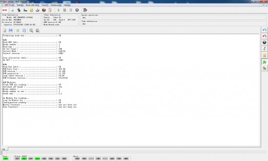

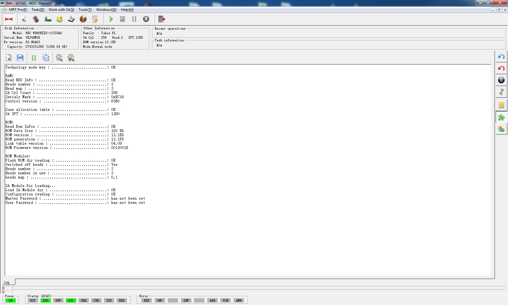

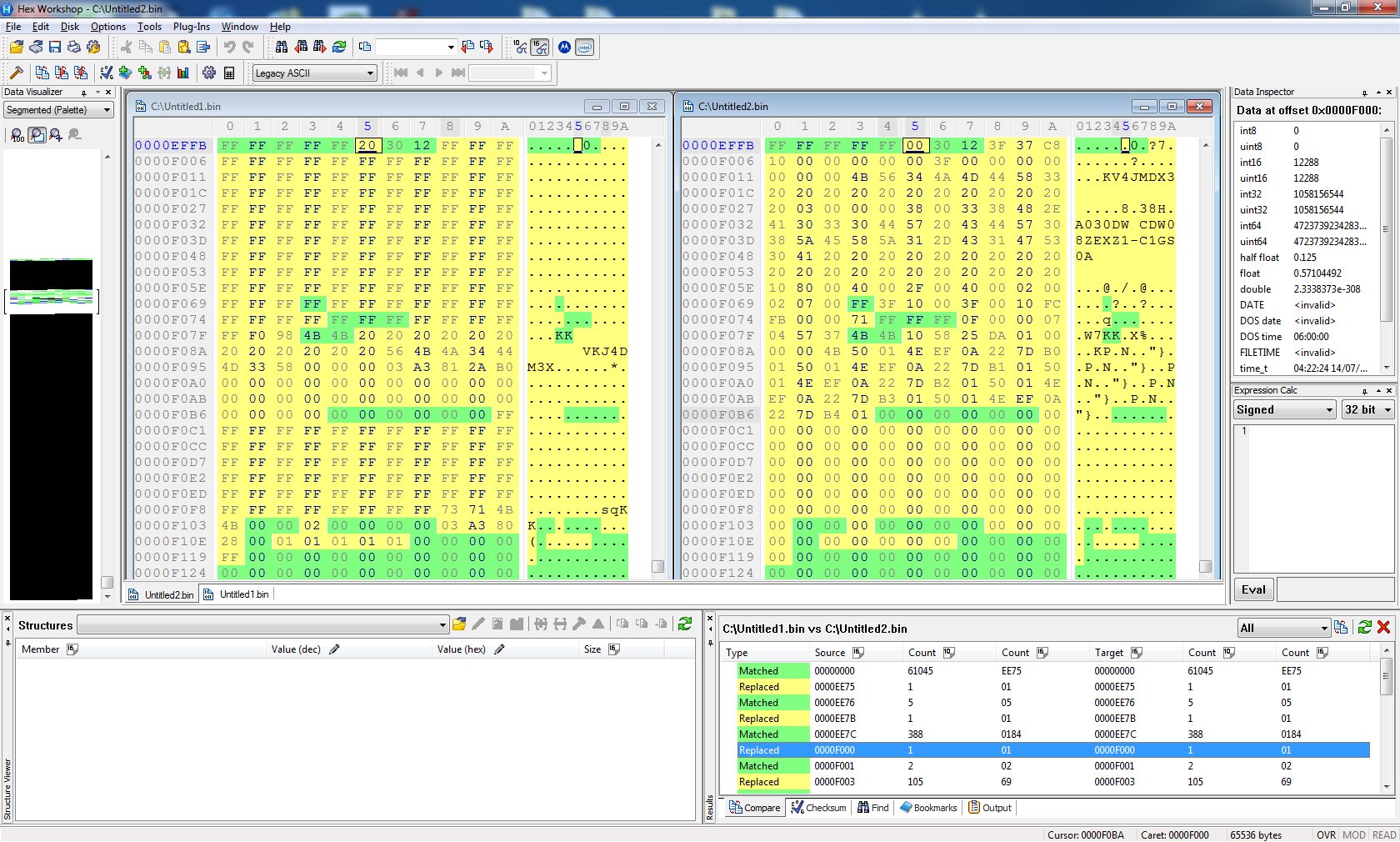

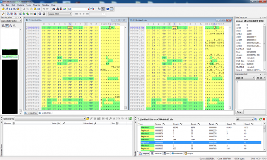

I did those changes on mod 02 of my 500 GB test drive, but somehow the modification of the capacity (LBA) is not saved properly.
The 8 TB drive has 15628053168 LBAs, once i insert this value on edit ID in MRT, when i repower the drive and go again inside utility it shows me 2743151280 LBA.
Why this number?
I did it with MRT but it's now a bug of the tool, i get the same number also when i do the same changes with WD Marvel.

Your 500GB test drive ignores LBA bits 32 - 47. :-(
  15628053168 = 0x3A3812AB0
   2743151280 = 0x A3812AB0

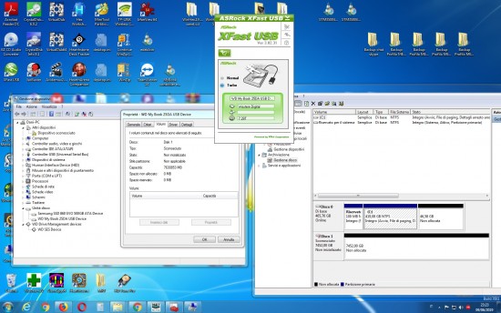

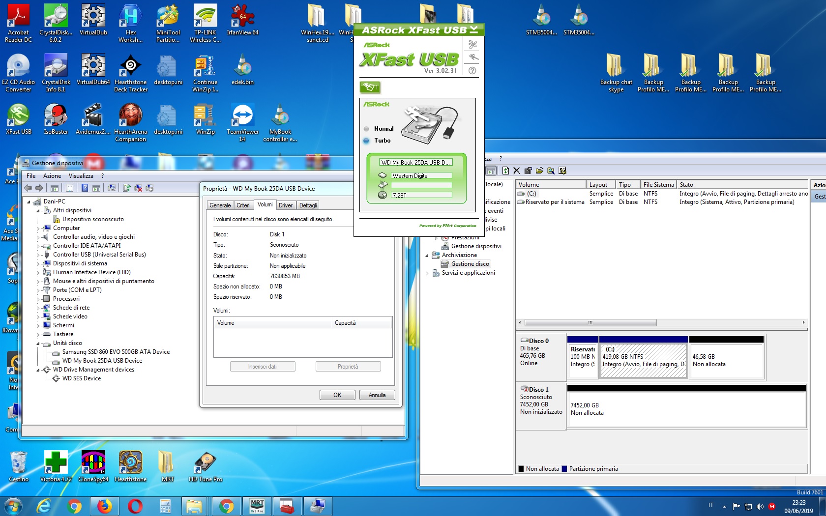

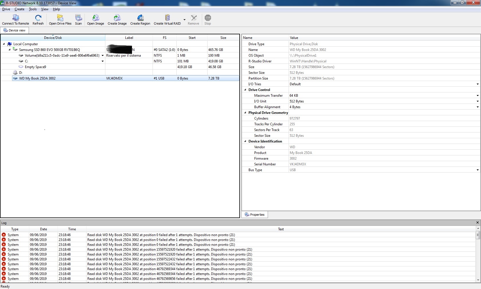

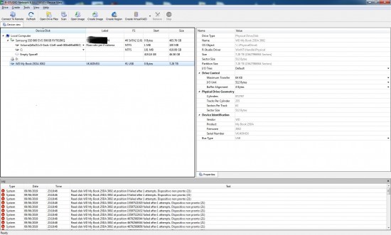

Frank,

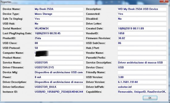

i've found another WD drive for testing, this is a 3 TB drive (Dragon family), model WD30EZRX-00MMMB0.
I edited mod 02, this drive writes properly those LBA bits relative to the capacity changing.
After i've changed capacity, s/n and fw version id of this 3 TB drive, i attached it to the 8 TB MyBook controller, then i unplugged, and finally i've attached the 8 TB drive to the controller.
Unfortunately i still can't access to user data, but it gets loaded into disk management (partition still not).
I also dumped again the controller rom, i compared 1st and 2nd parts.
Here you can download the rom code:

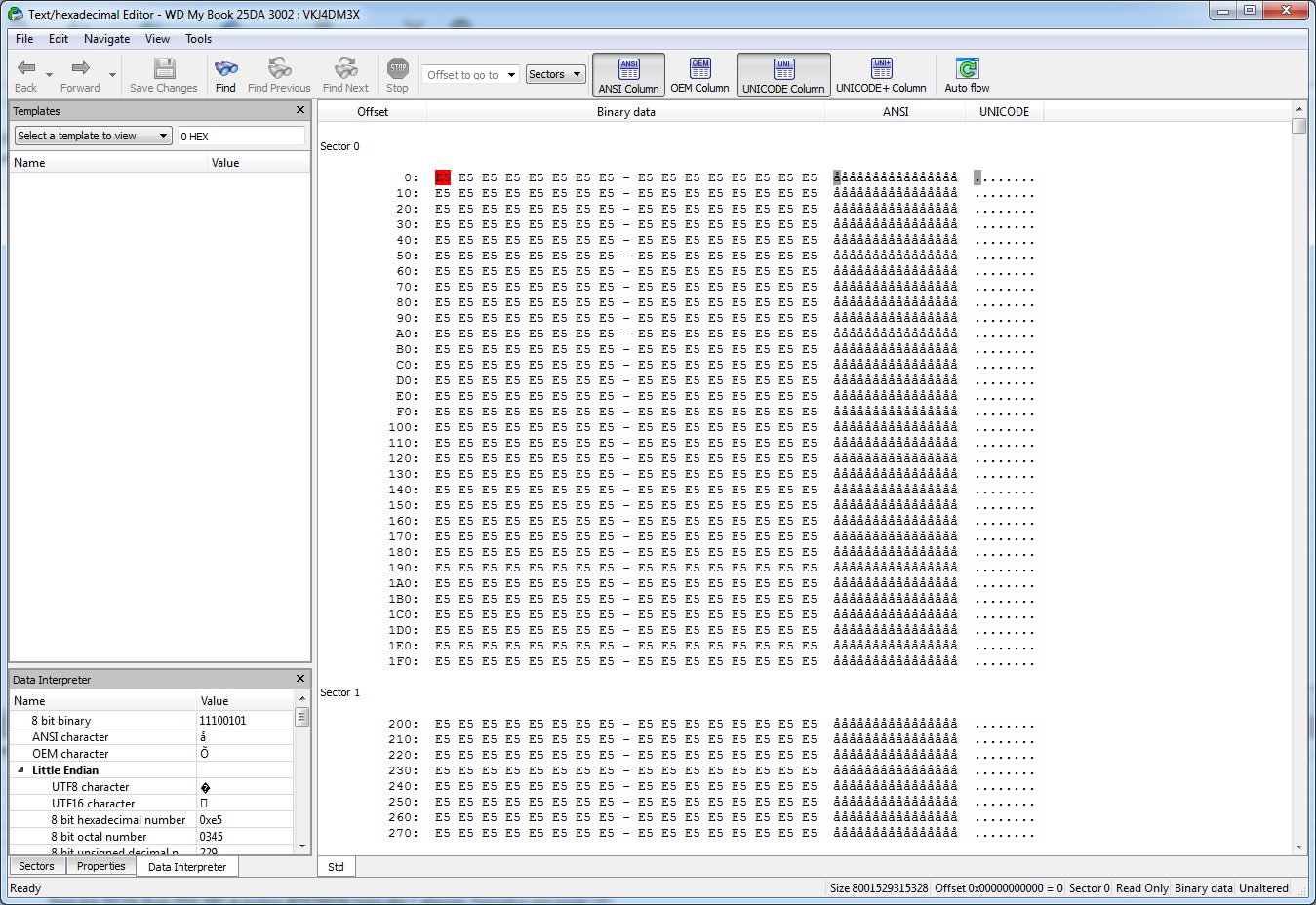

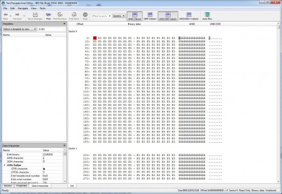

This is what i see in R-studio:
R-Studio shows all E5 pattern, from first to last lba.

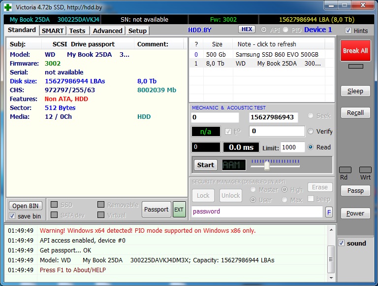

This is what Victoria shows
and USBdeview

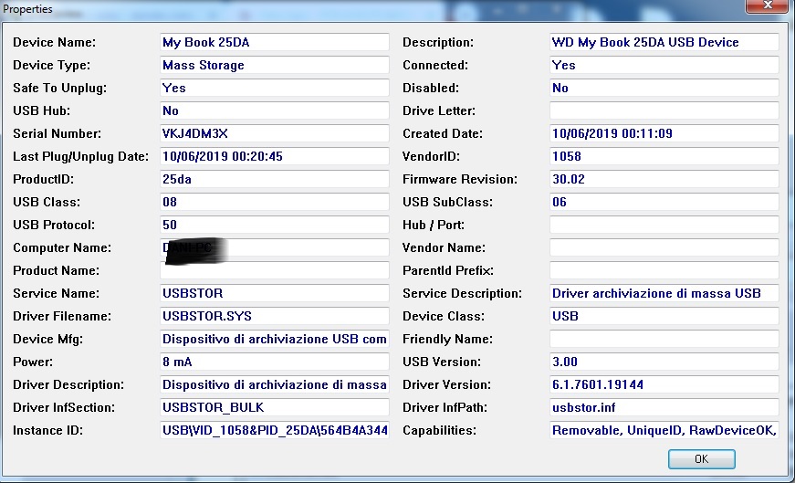

One other difference is that you have right justified the serial number (and padded it with leading spaces). Instead you should have left justified it and padded it with trailing spaces.
Your S/N changes:
0000F080              20 20 20 20 20 20 20 20 20 20 20 20
0000F090  56 4B 4A 34 44 4D 33 58                          VKJ4DM3X
Original Identify Device serial number (byte reversed):
0001F010              4B 56 34 4A 4D 44 58 33 20 20 20 20      KV4JMDX3
0001F020  20 20 20 20 20 20 20 20
