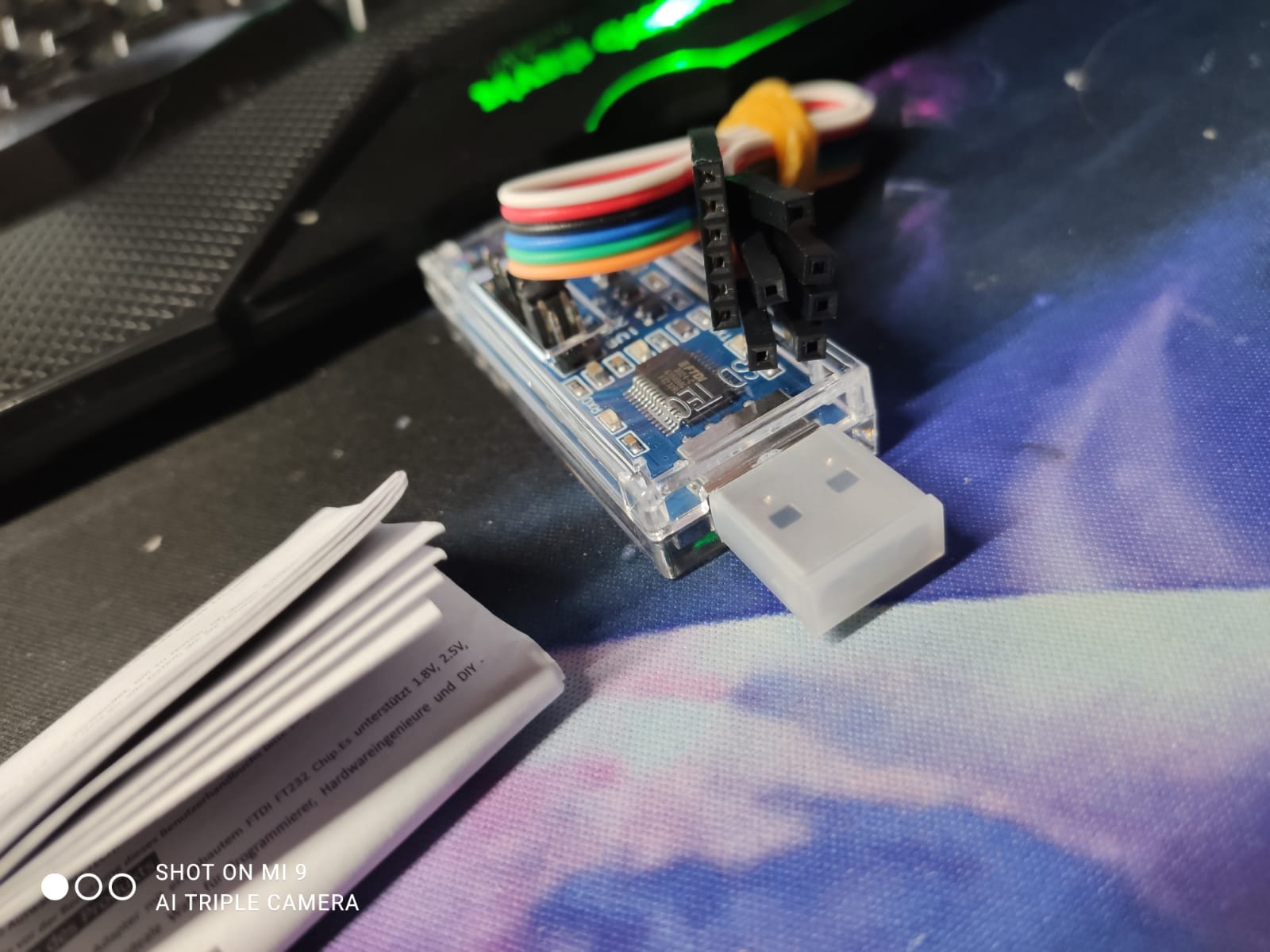

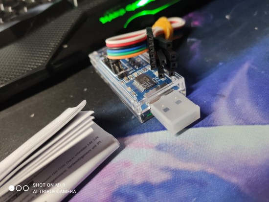

I know a lot about computing and so, but I'm not into eletronics, but I am learning a lot of new things and I'm glad because now I know a little more, for example, about welding, although they still look horrible I have learned to solder and desolder and now I realize the importance of a tester.
Thanks for telling me that I've looked that I was into electronics, even tho I'm not hehe.
Why do I feel cheated about the usb-ttl-adapter? Haha :lol: (I'm joking) Now I've to figure out how this thingie works. Time to research!
(It has 5v, 3.3, 2.5 and 1.8 V adapter it comes with a little jumper that I do put on the V i want to use)

Hopefully you won't need any support for your adaptor:
http://www.dsdtech-global.com/search?q=SH-U09C5
There is no listing for this product, and no downloads (eg drivers).
Virtual COM port drivers are available here:
https://www.ftdichip.com/Drivers/VCP.htm

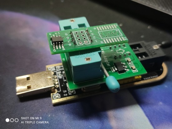

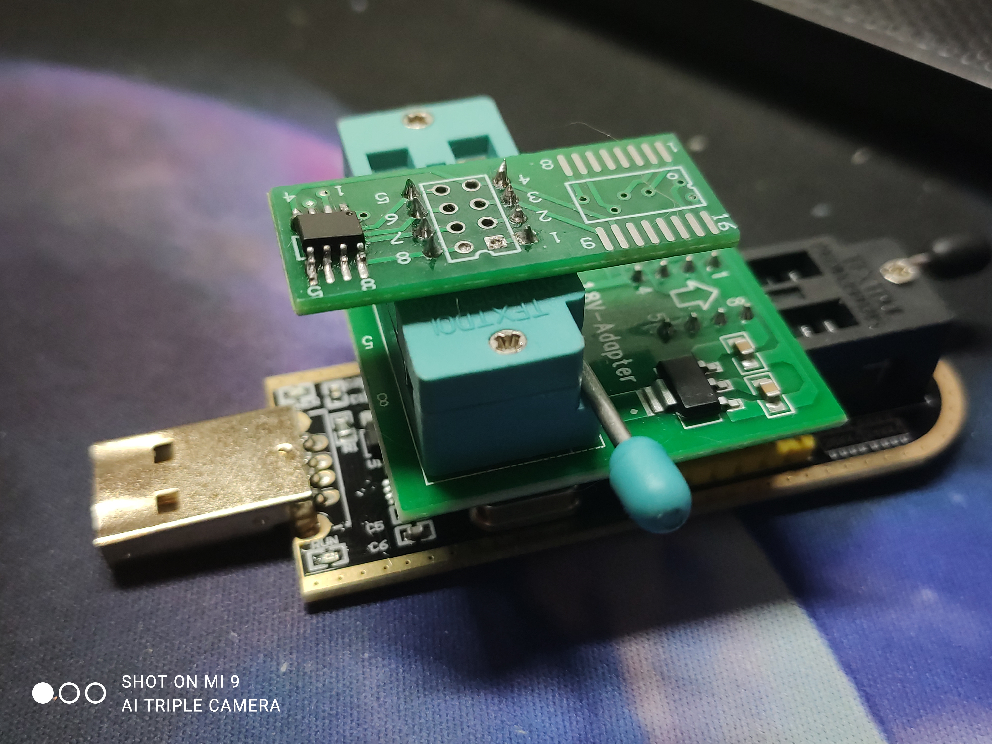

I had a hunch about what was wrong on my HDD. Ye, it could be internally damaged, but something was telling me that the ROM wasn't 'repaired' at all.
We assumed, or so I think, that the ROM was fixed, but I was not 100% sure, so in my spare time, I would read and reread my ROM readings (Remember, my programmer did not read the ROM very well) and compare it with the theoretically fixed ROM.
Do you know about the 2 halves that should be the same? (256kb / 512kb) Well, I started looking at other functional ROMS and I noticed that for example "CAP" would appear in one half but not in the other, so I did the same with mine. The CAP does not appear in the upper part (1st half) but it does in the lower part (2nd half), in addition to a couple of other differences. You could say that they are approximately 99% the same, but they differ in some detail. (By the way, WITHOUT TOUCHING ANYTHING, my programmer read the ROM better and better every time I read it, WEIRD, although there were always some gaps with zeros). So, since I had to wait for you guys to reply me about that Terminal Output Log, I was testing some modified ROMS... and boom, the miracle has happened.
I guess my ROM was malfunctioning, but I still could read some data out of it.
It's a bit difficult for me to explain. You know, language walls. But I'll try my best.
Imagine the ROM is divided in like 20 Fragments. When I hit "READ", it could give me fragments like 1, 5 and 9, REST is blank/null. On the next reading, it gives me 2, 11 and 12. On the next reading, 3 and 16. And so on.
So all I did was join all fragments to get my complete ROM. Easier said than done. Now you multiply that for 100 times. I spent like 12 hours trying to join all fragments.
On the first readings all I received was like 0 data. Then after hitting and trying some more times I could read a very few fragments out of it. Incomprehensibly (And again) without doing anything (I didn't try to re-solder, I didn't change settings, I didn't change ports), it reads now like 70% of the ROM. So now it's easier to compare between 2 ROMS.
What can I say? Maybe I could have send this to any of you and you would have read the ROM on the first try? Not sure
I tried to solder my ROM to the donor's PCB 3 times and it didn't work, and I soldered the original donor ROM 3 times and it worked everytime. So I don't think my solder's job was bad.
Anyway... all I can say is Thank you. THANK YOU TO ALL who replied to this thread. Specially to you three Fzabkar, Pepe and Northwind. Also thanks to HaQue for the Hex Editor.
