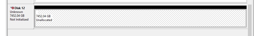

This is what the drive looks like in Windows with no spin after a while. It does show up but there is no noise. I'm sure if I did try to initialize it, it would say i/o communication error.

with the foreign pcb the drive does not start properly, albeit it reports full capacity. so it ain't mean no nothin'.
Running any recovery sw won't work, as long as foreign rom is used.
Anyway, there's a whole number of things that must be checked, it's a profession to recover data from dead media.
We can help with issues the user can likely fix, but it is obvious this thing has a couple of problems now and you have no experience in the field. You will have more and more questions as we answer them one by one, we are at the 4th page of posts and just started off.
It is also clear that you need the data from that disk. Can't get why you are messing with it. It's a misbelief you can't kill it for good without opening the lid, you can, and you might have already done it putting any pcb on the HDA and powering it up.
