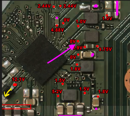

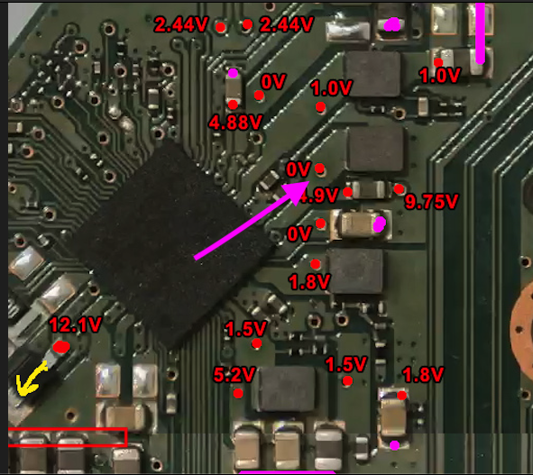

One thing that made me wonder when taking more measurements is that when checking resistance between the test point at 0V (attached below) and GND, it shows a short. Is that expected?
Normally when testing points around inductors to GND i see some resistance (low, but still 2-6Ohm, but the one at 0V is <1Ohm. FWIW the 1.5V test points (also around inductor) show OL to GND.

That short circuit is expected. That inductor is part of an inverting boost converter (negative switchmode regulator). The diode is inside the IC. I wasn't sure of this until your measurements confirmed my suspicions. Thanks.
See https://www.hddoracle.com/viewtopic.php?p=596#p596
I think most of the inductors on your board would have resistances much less than 1 ohm.

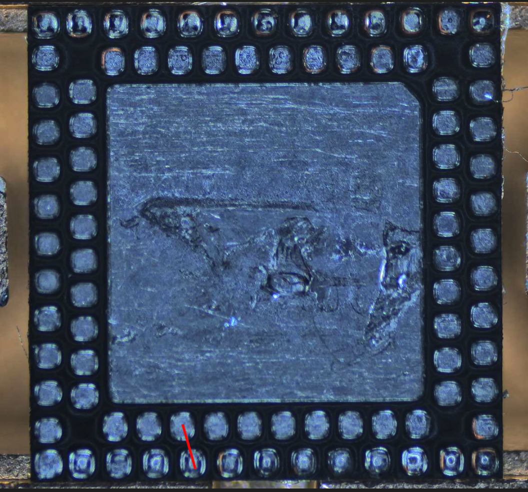

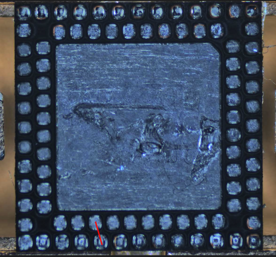

I've found a donor board from another (faulty, though with damaged plates) drive (different HDD model, but same board and thus ICs). I've tested the voltage on the Vp1 without HDA attached and there's constant ~-3V there.
I've started replacing the motor IC when I realised the pads on this IC have some weird offsets... good luck to me reballing that using an universal stencil *sigh*. looks like i'll have 88 balls to put manually on the chip.

Reballing is a tricky at best. Stencils are available for a wide range of BGA configuration.
