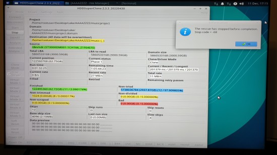

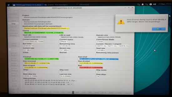

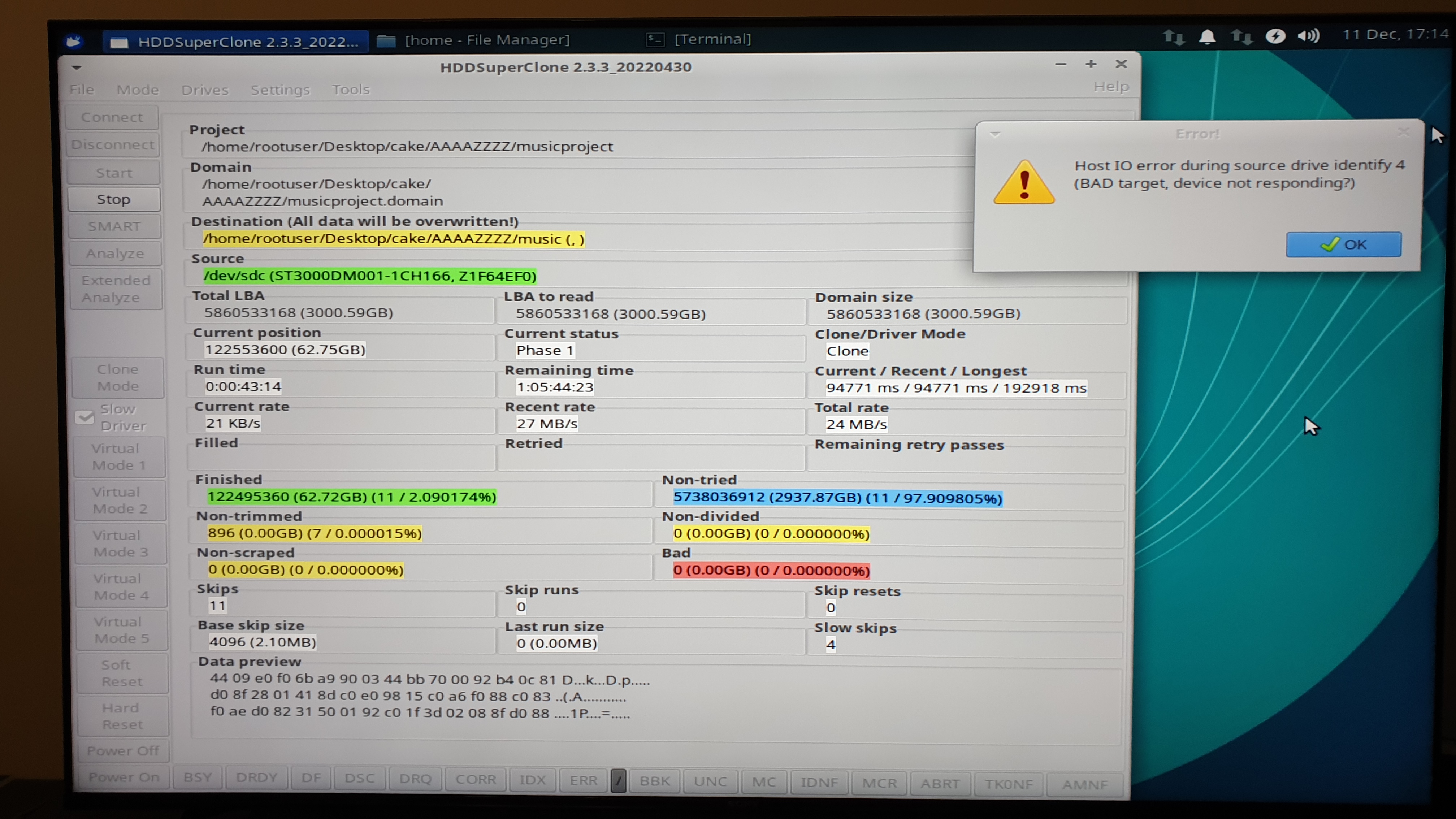

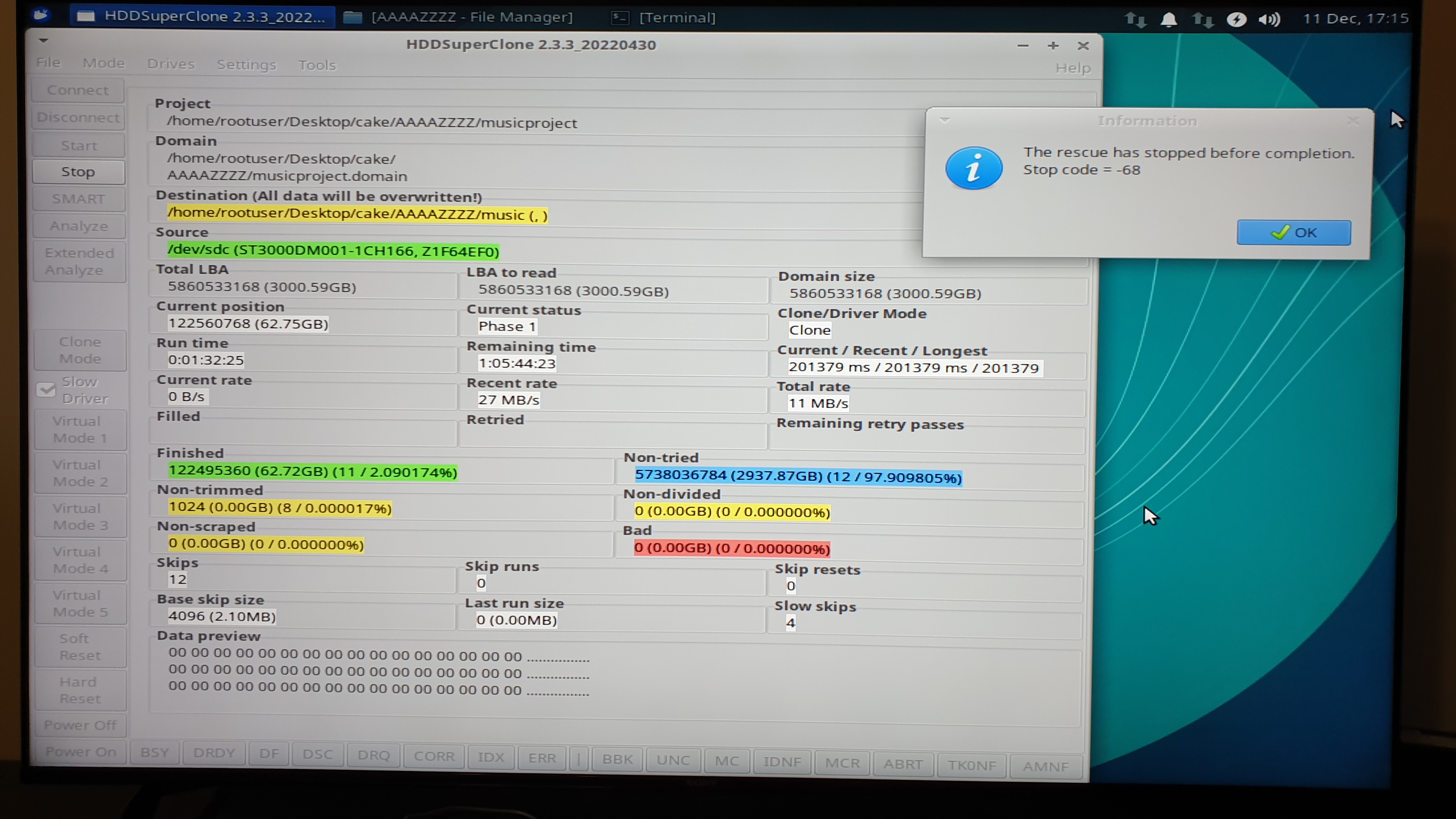

Here's where I'm at, images are in order;
Before you ask, these are indeed photos of screenshots. I didn't want to shut down the lived due to all of the stuffing around I did with getting the folder writeable.
These screenshots are within seconds of each other, so I'm not sure about the vastly different runtimes.
The Host IO error actually popped up twice but there was nothing different about the message.
I'm taking a break from it for the rest of today, as It's stressing me so much.
When I used HDDSuperClone, I simply set up the required steps, project, source and destination targets then clicked connect followed by start. I did see it slow down a few times before turning the screen off, but came back to this some time later.
Please ignore the creative directory names lol

It does seem I need to restart between attempts as the drive "disappears" when these errors occur, but better than nothing.

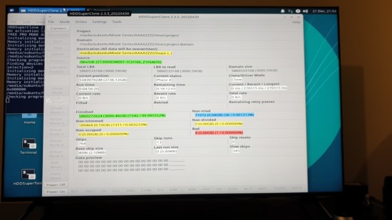

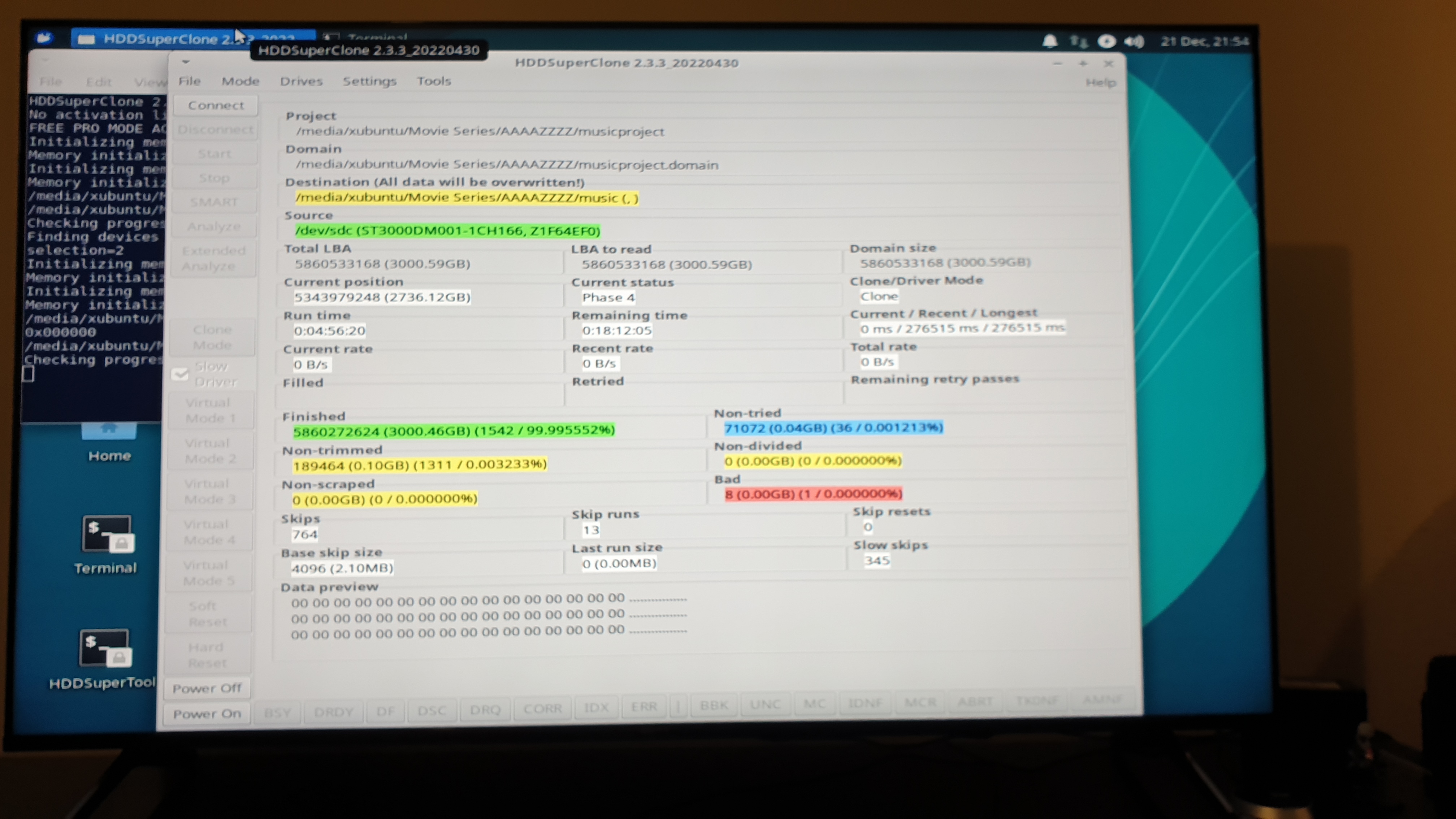

Here's where I'm at;
The drive is becoming harder to detect, and today when I went to select it it just timed out after a little while.
I'm having a break from it for now as I'm getting sick of having to restart , plug/unplug etc.
Sorry it's blurry, I took it quickly.
 Post subject: Re: ST3000DM001 1CH166-510 issue
PostPosted: December 23rd, 2022, 4:52
Posts: 1312
You appear to have managed to get 99.99% of the drive and you're on phase 4.The patient also appears to have died or is dying on the table but you're pretty much finished now anyway. Well done.
The paranoid amongst us would probably now make a copy from your clone which shouldn't take more than a few hours as it should be in perfect health.
Once you have this I'd be tempted to see if the clone of the clone would mount (read only) if there has been no damage to the file system you may get away with it and you can just copy for files. If that doesn't work you'll need some file recovery software - r-studio, ufs-explorer or DMDE .

Could you explain the 99.99% to me please?
Just cause there's so many skips I assumed that the percentage should technically be smaller?
Also Pepe said not to mount it?
PostPosted: December 23rd, 2022, 9:43
Posts: 1312
Across the entire drive you've copied all but 140Mb. If you have a look at your log file in the viewer it will give you the physical location of those blocks. Skips in the later passes are based on the read speed and skips just a couple of mb a time.

Don't the skips equal about 1.6GB?
