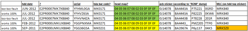

Some more notes on the 2TB Hitachi HUA723020ALA641.
Just for fun, I tried to dump one of these ROM chips having it in circuit. Using a clamp seemed pretty much hopeless, so I soldered 8 wires directly to the legs of the chip and checked and double-checked my soldering. No luck. Then I desoldered the chip from the PCB and got a good read right away.
According to what I've been told, I was wrong before when I said this drive has 5 platters. For the 7K3000 product line, it seems it's only the top-of-the-line 3TB drive that uses 5 platters.
This 2TB version supposedly uses the same 10-head headstack as the 3TB version, but the 2TB drive has only 4 platters.
Using 7 surfaces (or heads) instead of 10 would imply a roughly (3/10) * 3TB = 0.9 TB lower capacity. 3-0.9 = 2.1TB. Hmm, well, yeah, something like that, maybe. :P
Apparently the head configuration can vary from drive to drive!? That is, they didn't choose 7 out of 10 heads in the same way in all HUA723020ALA641 drives. And this may make finding a proper donor a slightly more challenging task than usual.
Would anybody like to comment on this?

Your ROM dumps should contain head maps.

Something along these lines, maybe (just a wild guess)?
I:\test>hitachitest002.exe 001_jun2012.bin
0x02000; 'E2PR0007MK7XB840      KM1017FYMH0LAG'  --> descramble --> serial: YFHML0GA ; hda bar code?: MK0171
0x02b3e; 04 05 06 07 08 02 03 0F 0F 0F  <-- possibly head map?
0x03000; 'E2PR0007MK7XB840      KM1017FYMH0LAG'  --> descramble --> serial: YFHML0GA ; hda bar code?: MK0171
0x03b3e; 04 05 06 07 08 02 03 0F 0F 0F  <-- possibly head map?
0x7f000; 'PN_LOGEX0J14078BA4443AP7S2210GRDPN_LOGAC                        '
           --> pcb sticker: 0J14078 ; BA4443A ; P7S221 ; 0GRD
I:\test>hitachitest002.exe 002_jul2012.bin
0x02000; 'E2PR0007MK7XB840      KM1017FYVH6ZA3'  --> descramble --> serial: YFHVZ63A ; hda bar code?: MK0171
0x03000; 'E2PR0007MK7XB840      KM1017FYVH6ZA3'  --> descramble --> serial: YFHVZ63A ; hda bar code?: MK0171
0x7f000; 'PN_LOGEX0J14078BA4443AP822250KW6PN_LOGAC                        '
           --> pcb sticker: 0J14078 ; BA4443A ; P82225 ; 0KW6
I:\test>hitachitest002.exe 003_jul2012bzzbzz.bin
0x02000; 'E2PR0007MK7XB840      KM1017FYVH4NAZ'  --> descramble --> serial: YFHVN4ZA ; hda bar code?: MK0171
0x03000; 'E2PR0007MK7XB840      KM1017FYVH4NAZ'  --> descramble --> serial: YFHVN4ZA ; hda bar code?: MK0171
0x7f000; 'PN_LOGEX0J14078BA4443BP78228201RPN_LOGAC0J14078BA4443BP78228201R'
           --> pcb sticker: 0J14078 ; BA4443B ; P78228 ; 201R
I:\test>hitachitest002.exe 004_feb2012.bin
0x02000; 'E2PR000UMKUXB840      KM2017GYPGXNAM'  --> descramble --> serial: YGGPNXMA ; hda bar code?: MK0271
0x02b3e; 04 05 06 07 08 09 03 0F 0F 0F  <-- possibly head map?
0x03000; 'E2PR000UMKUXB840      KM2017GYPGXNAM'  --> descramble --> serial: YGGPNXMA ; hda bar code?: MK0271
0x03b3e; 04 05 06 07 08 09 03 0F 0F 0F  <-- possibly head map?
0x7f000; 'PN_LOGEX0J14078BA4443_PMZ205TTP0PN_LOGAC                        '
           --> pcb sticker: 0J14078 ; BA4443_ ; PMZ205 ; TTP0
I:\test>hitachitest002.exe 005_sep2011.bin
0x02000; 'E2PR000UMKUXB840      KM2013GY3GG6A5'  --> descramble --> serial: YGG36G5A ; hda bar code?: MK0231
0x03000; 'E2PR000UMKUXB840      KM2013GY3GG6A5'  --> descramble --> serial: YGG36G5A ; hda bar code?: MK0231
0x7f000; 'PN_LOGEX0J14078BA3967AP6y13704K5PN_LOGAC                        '
           --> pcb sticker: 0J14078 ; BA3967A ; P6y137 ; 04K5
Or in table form:
These observations could possibly suggest that e.g. YGGPNXMA wouldn't be a suitable donor for YFHML0GA. But why, though? What part would supposedly be incompatible?

Thanks, but the Ultrastar seems to differ quite a bit from the Deskstar both electronically and mechanically.
In any case, I'm quite confident that I have ONE proper donor in my list above. That is, YFHVZ63A should be a suitable donor for the patient YFHML0GA.
Of course, the offsets 0x02b3e and 0x03b3e for the head map were just a wild guess, but maybe not such a bad one ... ?
If those are indeed the head maps, I guess it looks like heads 0 and 1 would be physically missing in all five listed drives. Additionally, one of the heads actually present in the drive will have been disabled in the ROM; seemingly head 9 for the drives marked with green and head 2 for the drives marked with yellow.
Or maybe I'm completely on the wrong track. :D
