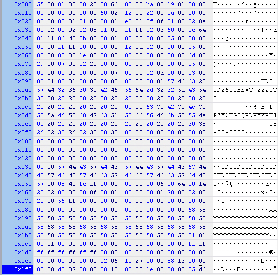

hi i was stuck with the same problem which i solve on a WDC2500bevt
just a quick list of master pwd i found on my travels
WDCWDCWDCWDCWDCWDCWDCWDCWDCWDCW <----THIS ONE WORKED FOR ME
WDCWDCWDCWDCWDCWDCWDCWDCWDCWDCWD
&'()*.WDCWDCWDCWDCWDCWDCWDCWDCWDCWDCWD
h2oinsyde <-----for acer drive(but not mine)
if none of the above work then the fun begins
first download MHDD boot disk (google for it)
copy the unzipped files i put up on to a usb stick and plug in
remove all drives except locked one
boot the cd and press F5 (safe mode)
type 'c:' to get to the contents of usb drive
then type MHDD to run the program on the usb not the cd as that is wrong version
in MHDD (select drive this might take a little bit of getting use to!)
run the script by typing ".dump" or ".dump2" (two different scripts)
the script will run and return "DONE"
read the 22.bin file if DUMP script run ok with a hex editor
and 42.bin if DUMP2 script run ok with a hex editor
also read all other posts for more info
hope this helps

Heloo,
I read bin from my WD5000BEVT.
But I Cannot see code from bin. Can you help me what is code? Thanks

PostPosted: December 3rd, 2009, 15:03
Joined: November 14th, 2007, 12:21
Hi Luda,
Have you got the 42.bin?
Have you run all the 3 dump scripts?
Have you tried the Zu if you just want to remove the password?
Good Luck.
hope this helps
and a great big thanks too all who posted and helped me save 8 months worth of HNC elec engineering work thanks!
Nirvanowiec, a big xtra thanx for the script i used....
MHDD.zip
