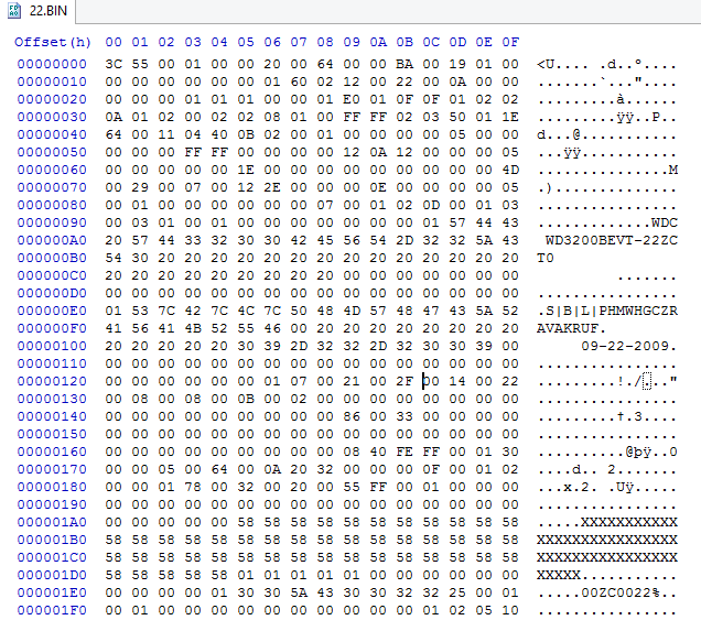

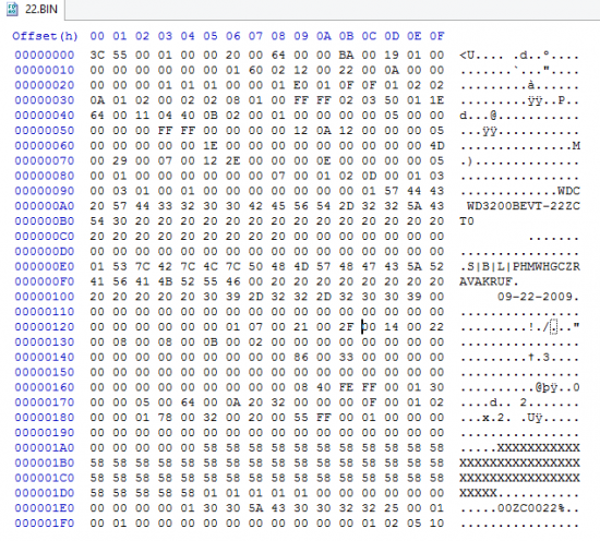

Hi all,
I've been having a go at MHDD to give a dump to show me the hex code to retrieve the password.
The dump is attached (http://i.imgur.com/RAlXxBL.png), and as far as I can see the code should be 21 00 2F 00 14 00 22 00 08 00 08 00 0B 00 02.
Translating this to dec gives 022 051 079 099 098 023 046 053, which does not unlock the disc :(
Can someone help me out?
TIA.
File comment: The MHDD dump

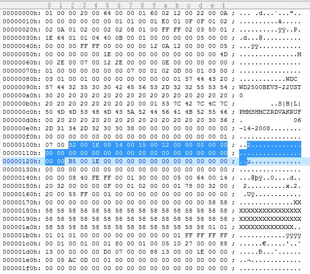

I already spent the whole afternoon and some further hours in reading this thread and managing to unlock my WD2500BEVS(-22USTO). I already knew that it was locked, when i bought it from ebay, thinking I could save some euros. Normally I'm not a total noob when it comes to to computer stuff, but this really cracked me up :D I just wanted a cheap hdd to build in my Xbox360 Fat -> can't flash the drive with it being locked
So, I followed some instructions in here and dumped my 22.bin, I also found the 01 07 Hex key, indicating the pw and the high security level. I also thought I figured out the password (keyboard-method), to be "matye". But at this point I don't know how to unlock the drive, since I don't know how the previous owner locked it and mhdd not accepting the phrase as user/master password. Could anyone give me a hint? Apparently I can't use ZU either, it's a 2.5" drive.
I really would appreciate some help :))
Here's my 22.bin dump, the pw section highlighted.:
