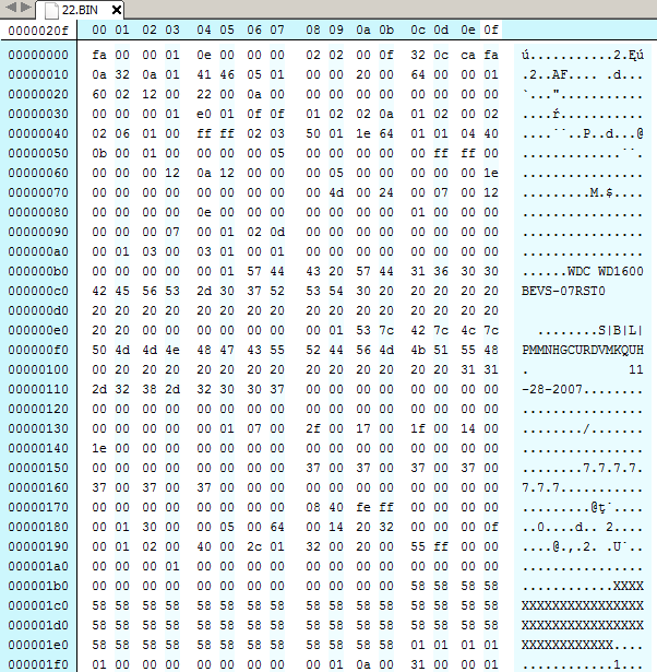

Hi Guys,
I've been reading this topic for a while in order to unlock a 160 GB WD Scorpio drive (WD160BEVS) from a Fujitsu laptop. I got the laptop from a disbanding company - it already came with a locked drive. Using MHDD 4.5 script I managed to dump the '22.bin' file, however I have had no luck deciphering the password from it. Would you be so kind to help me do that?
Thank you in advance,
mcz_1
Screenshot of the file is attached. I can upload the bin file if needed too.
File comment: File

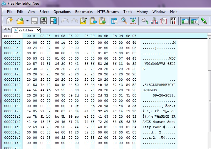

Would someone please put me out of my misery, I have spent three days trying too unlock a HDD from a BT Vision box to use as a spare, don't ask me why, it just seemed like fun at the time and became a major challenge......
.dump produced 22.bin which I have attached as picture file below with the drive set as Primary Master
I can see PACE FRANCE Master Security PDW2 but having tried both of these it still says locked, using MHDD 4.5
any advise and guidance would be greatly received.
kind regards Stuart
File comment: my results

THANKYOU Fzabkar, I can't send PM's THANKYOU for the PW. I'm off to see if I can manage to input it...... Will keep you informed,
Many thanks

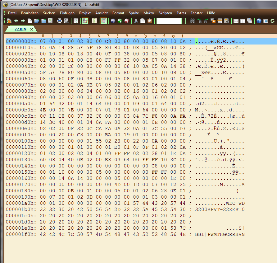

Hello to all.
I have a WD 320Gb WD3200BPVT.
I did unlocked the drive user password but in order to wipe it out or secure erase it needs the master password (I think so).
I did run mhdd and all the scripts from .dump, .dump2 and .dump48 and received the data.
When I look at the 22 bin file I can't be sure where the password would be hiding. So, if there are good willing members, please give a try at my file ore just pinpoint where should I look at and how to convert it into hec
Thank you

With a great deal of frustration and trying and more enormous help from Fzabkar..... My drive is finally unlocked. Here is what I did
1, The HDD needed to be the only one installed into a machine
2, Boot it to c:\
3, run MHDD from Floppy
4, having written/copied scripts in MHDD type .dump or .dump2
5, the one that works does not return an error
6, you should now have .bin according to which one worked (21, 22, 42)
7, the next thing is to download a nex converter, to view the .bin file
I needed alittle help here, and Fzabkar kindly provided me with a .bin file
I then tried several ways to run " Victoria 4.46b"
I found this best to run on windows XP
8, run Victoria and input the password or prepared .bin file
It's then an anti climax as the drive magically UNLOCKS
Hey Presto, a very happy camper
Thank you once again Fzabkar, you are da man!

Thanks Fzabkar.
I manage to remove the password under zu, but when I try to erase it, it doesn't complete, hence it still stays unrecognizable in the system ans I can not format it. I gave a try with linux and hdparm. Here says as follows:
Security: Master password revision code=65534
Supported
not enabled
not locked
not frozen
not expired, security count
supported: enhanced erase
But when I try to secure erase i get an Input/Output error.
It seems that here the locked one is me, or I'm missing something and don't know what.
P.S. A 21 bin file renamed in txt is attached.
21.BIN.txt [512 Bytes]
Downloaded 982 times

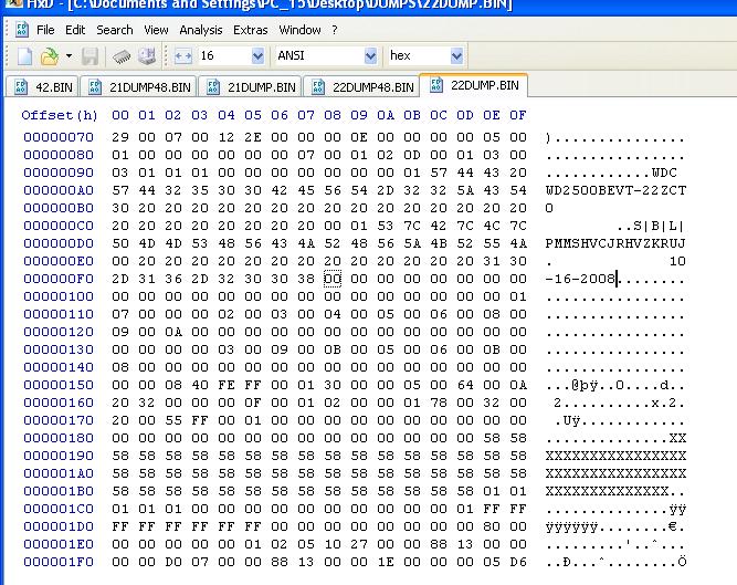

Hello, it's been days since I dared to unlock my WD2500BEVT-22ZCT drive but to no avail. So, I'm here to get help if you won't mind. :lol: My head is aching as to what the master password is.
Thanks much in advance.
22DUMP.zip [416 Bytes]
Downloaded 686 times
