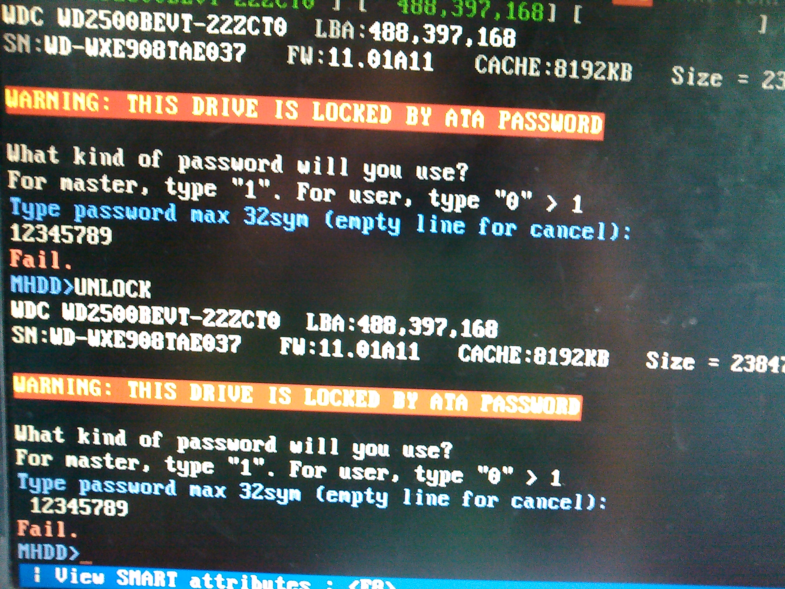

PostPosted: October 26th, 2013, 2:13
Joined: October 20th, 2013, 2:22
Location: Philippines
hi, I already converted the pass but why it doesn't work? Please help me what's the correct way to input the pass. Thanks. This is my cousins' laptop played by kids due to her negligence, it's really messed up, OS corrupted, BIOS & HDD locked. I'm just stucked in HDD, the BIOS pass already cleared.

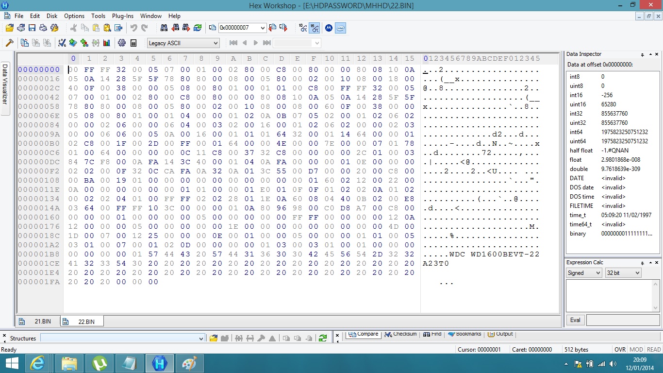

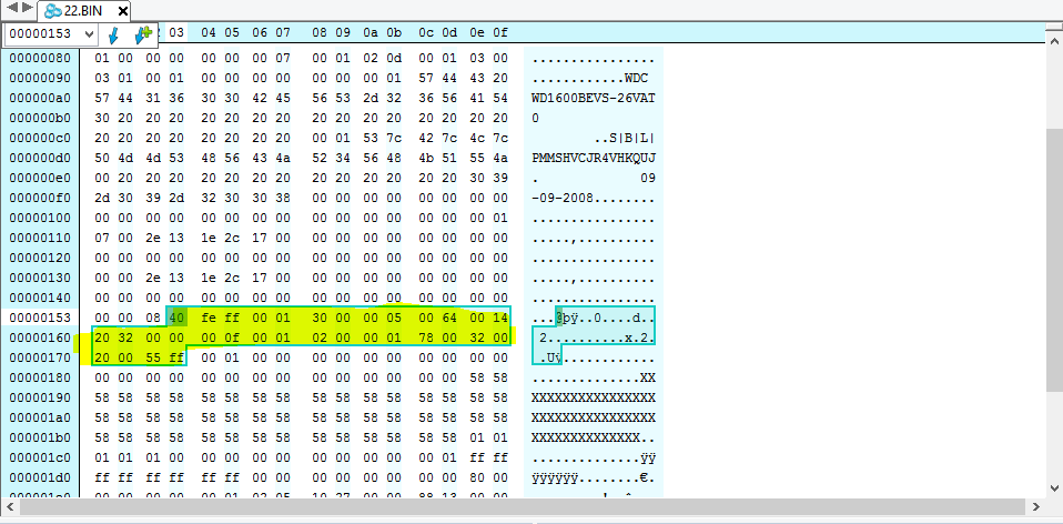

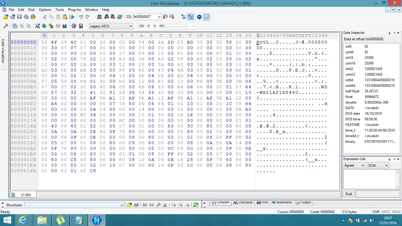

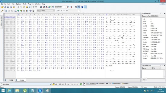

PostPosted: January 12th, 2014, 16:12
Joined: January 12th, 2014, 16:01
Posts: 7
Hi guys, I have been following the post and trying to test the theory out on a WD1600BEVT that I already know the password for.
I cant seem to find 01 07 anywhere in the files
can anyone help?
PostPosted: January 12th, 2014, 16:59
Posts: 17316
Offsets 0x0A - 0x0B in 21.jpg indicate that there are 4 sectors in MOD 02. You need to examine 23.jpg.
PostPosted: January 12th, 2014, 18:57
Posts: 7
thanks, it was indeed in the file I didn't check lol
I had to alter the offset using the code posted above in order to be able to dump the correct range.

could someone please help me out with my 22, I think it is around the area of 2e 13 1e 2c 17, any help is greatly appreciated,
WD1600BEVS-26VATO 160GB
22.zip [393 Bytes]
Downloaded 795 times

so I guess it has a user password? and I have to put in the hex keys that correspond to that area right before the "WDCWDCWDCWDCWDCWDCWDCWDCWDCWDCW" section, so would I start at "40 and stop at ff"? and do I use hdat2 to input password or can I use mhdd? oh and thank you very much for such a prompt reply :) I understand that this is a kinda old thread, thank you for the help!

Show us 23.jpg.

after going through a good bit of this tread I did see something about pic "23" but can't seem to find it again to know what to show you, lol, sry it's been a long day :) I've included 42 bin if that is what your possibly looking to see
42.zip [162 Bytes]
