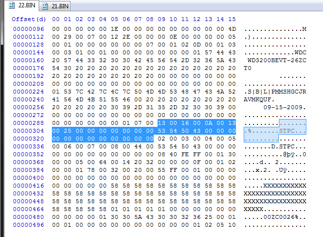

PostPosted: March 17th, 2014, 22:49
Posts: 17316
Sorry, the password was indeed in 22.bin at location 0x10E.
Offset 0x7A in 21.bin points to offset 0x30E in MOD 02 as the location of the password block. The size of the block is 0x48 bytes.
00000100                                            00 01
00000110  07 00 2E 13 1E 2C 17 00 00 00 00 00 00 00 00 00
00000120  00 00 00 00 00 00 00 00 00 00 00 00 00 00 00 00
00000130  00 00 2E 13 1E 2C 17 00 00 00 00 00 00 00 00 00
00000140  00 00 00 00 00 00 00 00 00 00 00 00 00 00 00 00
00000150  00 00 08 40 FE FF
You need to create a 32-byte file consisting of "2E 13 1E 2C 17 00 00 ... 00" and then send it to the drive as a password string. Victoria for Windows can do this.
PostPosted: March 17th, 2014, 23:13
Joined: March 17th, 2014, 14:10
Posts: 10
Location: Louisiana
okay cool I so now I will just have to get to learning how to create that string, I have Victoria it picks up the drive, I can send the file, just don't know how to make it but I will try my best :) thanks I appreciate the help.
PostPosted: March 18th, 2014, 14:04
Posts: 10
Location: Louisiana
I have successfully removed the password and am currently accessing the drive :)
Thanks for the much appreciated help with this, I wouldn't have been able to get as far as I did with this project if it wasn't for your help.

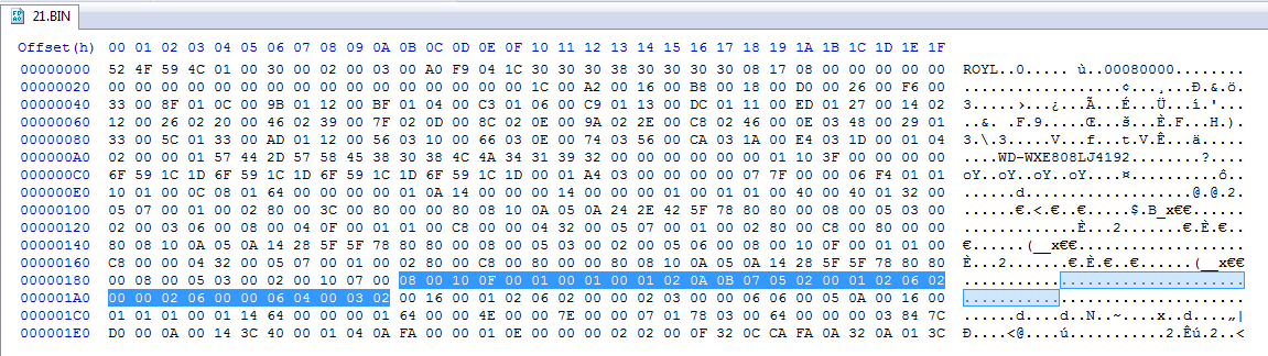

Hay Guys,
i almost read every page of this thread but cant fix the unlock
I just cant read out my password
The HDD is a Model: WDC WD3200BEVT-26ZCT0 and Serial: WD-WXT0E79RWK14 (Which both differs from the hexdump !!!?)
I used ".dump" (.dump2 lead to a DRQ error)
Im thankful for any help :)
PostPosted: March 18th, 2014, 23:29
Posts: 17316
Did you use HDDHackr on your drive, and did you apply a foreign UNDO.BIN file?

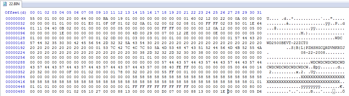

Oh, i see that the mhdd.zip i used already contained 21 22 and 48.bin files from someone. And my mhdd didnt overwrite them somehow. I will try again by deleting the files out of directory
PostPosted: March 19th, 2014, 18:09
Joined: March 18th, 2014, 22:54
Location: someWhere
thisDude wrote:
no never.. Only used mhdd with the Script ".dump" and now i got this hexcode.
Greetz
OK now I finally got the right HexDump.
So the lines are:
00 01 07 00 13 00 16 00 0A 00 13 00 25 00 00 00 00 00 00 00 53 54 50 43 00 00 00 00 00 00 00 00 00 00 00
Decimal would be: 019 022 010 019 037 083 084 080 067 ... when pressing ALT-GR and type its: ????%STPC ... weired... ? doesnt work
Anyone Help ??
