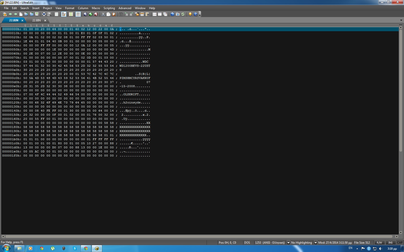

Attaching 22.bin. I'm a noob so please tell me where my password is.
Take a look at the start address 102h and see if you can make it out.
If someone could just tell me where it begins and ends so i could save it to use with viktoria software. Thank you.

Spildit wrote:
vagelisfr wrote:
h2oinsyde
Allready tried that. Straight on laptop, on mhdd and with victoria software. Wrong pass.Master and user...

vagelisfr wrote:
Spildit wrote:
vagelisfr wrote:
h2oinsyde
Sorry my mistake it worked. My fault thank you, you are great.
h2oinsyde is the password set by the bios but you asked for your password.
OLDDRIFT is your password.
Or maybe it never was yours? :shock:

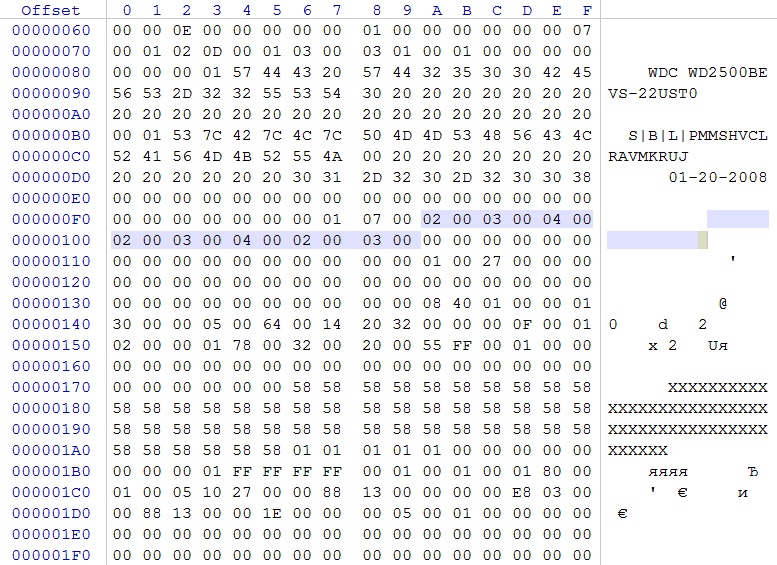

Greetings to everybody!
I have the similar problem that other guys have here. HDD is WD2500bevs-22ust0.
My laptop Acer Aspire 5920 died once (guess smth happened with motherboard), and I had used the hdd password before it happened, so I can't restore the information from its disk now.
The most funny thing is that I know the password (!). It is "12312312". And despite that I can't restore the access to hdd. I tried to type my password in MHDD and Victoria (both "master" and "user" variants), but they returns me "error" or "wrong".
I've carefully read the topic and have been able to obtain the .bin file by using the scripts. It's also funny that I've even found there my password coded into hex!! (highlighted on the screenshot, where '0200' = '1', '0300' = '2' etc)
So, my question is what i'm doing wrong? And how can I enter the password which was "12312312" with MHDD or Victoria?
PS I've also tried enter with Right_Alt and NUMpad (001 002 003 001 002 003 001 002), but it hasn't helped.
PPS It's quite important for me to recover the information, so is it possible with soft i've mentioned?
Thank you all in advance, guys! :)
PostPosted: July 27th, 2014, 14:34
Posts: 927
Location: uk
Hi! You seem to have done everything right.
Try using Victoria for Windows version. Then try "12312312" (as plain text) or "0203040203040203" (as Hex).
One problem might be the bios is freezing the password function. You would know this in Victoria for Windows as in the passport window it might show security "frozen" in which case you would need to plug in the drive immediately after the system has booted in to windows. Good luck!

PostPosted: July 27th, 2014, 17:48
Posts: 17316
@Maelstrom, the following MHDD script should disable your drive's password. It uses the standard ATA SECURITY DISABLE PASSWORD command -- it does not write to the firmware.
The password is transmitted to the drive via a 512-byte file (disablpw.bin). The first 2 bytes constitute the control word (00 00). This is then followed by the 32-byte password. The rest of the file is padded with zeros. You should place this file in the same directory as MHDD.EXE.
; send ATA SECURITY DISABLE PASSWORD command to disable password
reset
waitnby
regs = $00 $00 $00 $00 $00 $a0 $f6
waitnby
checkdrq
sectorsfrom disablpw.bin
disablpw.bin
00000000  00 00 02 00 03 00 04 00 02 00 03 00 04 00 02 00
00000010  03 00 00 00 00 00 00 00 00 00 00 00 00 00 00 00
000001F0  00 00 00 00 00 00 00 00 00 00 00 00 00 00 00 00
PostPosted: July 28th, 2014, 17:48
Joined: July 27th, 2014, 11:56
Location: Russia
Success!
fzabkar, have got error reading drq with this script in mhdd.. (after the string "checkdrq")
But also have tried HDAT2 v5 and finally done the unlocking with it by entering user-password in the HEX-mode: 02000300etc(whole password in hex)+0000(filling free space in the field up to 32 symbols with nulls). And it has worked :)
So, thank you very much guys and your great forum :)
