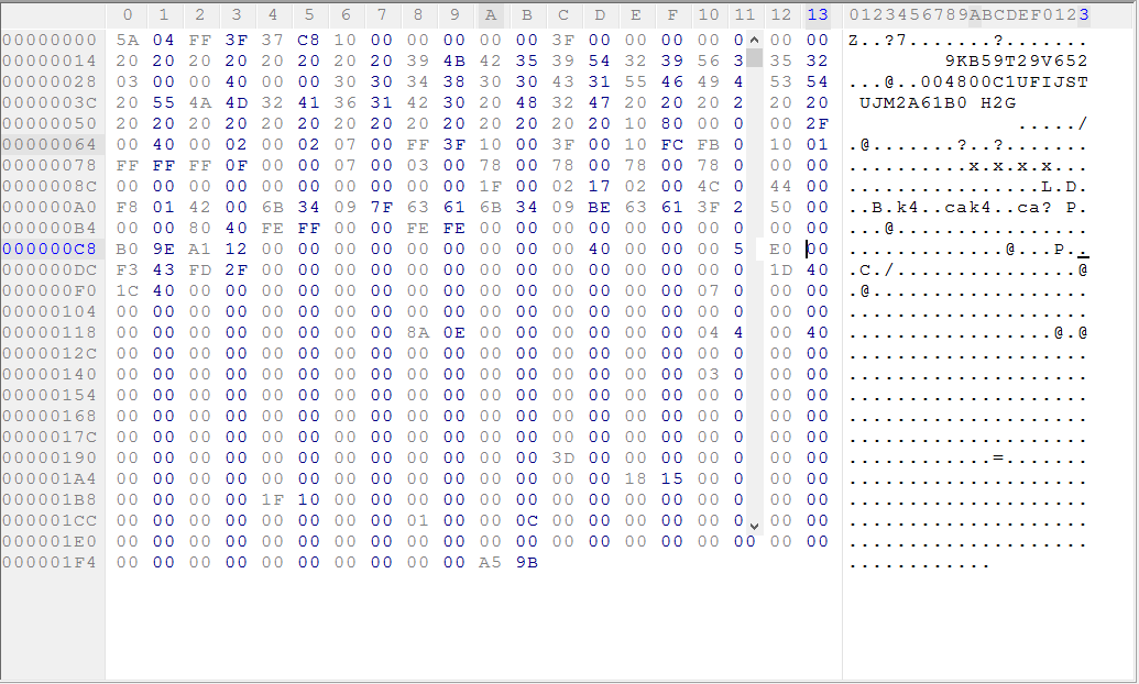

hi everyone, a few months ago I had success unlocking a WD hd, so today I am having trouble with dumping the bin for a Fujitsu hd that I have, does anyone know why I may be having trouble with mhdd sumping the bin for me?
thanks for any help that can be provided it is greatly appreciated.
hd is a FUJITSU MJA2160BH G2
PostPosted: August 26th, 2014, 15:19
Joined: March 17th, 2014, 14:10
Posts: 10
Location: Louisiana
Hi, I believe I have made some progress in getting the .bin from my FUJITSU hd, I have included the .bin that I was able to get from it, I suspect that the password is in there, would anyone be able to maybe verify this suspicion?
File comment: pic of the .bin
File comment: .bin is from victoria, I think it may contain the passwords
FUJITSU MJA2160BH G2_K95BT9926V25.zip [426 Bytes]
Downloaded 1225 times
PostPosted: August 26th, 2014, 17:31
Posts: 17316
That's an Identify Device information block. It has nothing to do with passwords. In any case this thread is about WD drives.

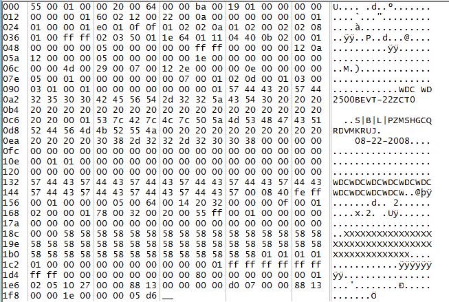

Hi all
After days and days of head scratching, reading and re-reading these last 42 pages, I am still no closer to working out this password.
I can see the mater password WDC.....WDC etc, but unable to see where 01 07 00 is and where the password starts. The Hard drive is from my wifes (now dead) Dell Inspiron 6400. Password was put on when she was at Uni and shes now forgotten it. Ive put it into a newer dell to retrieve the data, but asking for a password on start up.
Thanks in advance
PostPosted: September 24th, 2014, 5:00
Posts: 927
Location: uk
@ryanmini1275
In your case to be able to disable a password it would be easier to mount the drive in a pc not in another Dell laptop.
Look at the address starting 10e.....00 01 01 and you can see your drive is not showing as locked so maybe you have some other kind of drive protection?
01 01 = password disabled
01 07 = password enabled

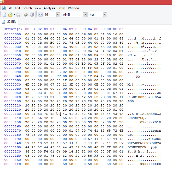

PostPosted: October 1st, 2014, 12:57
Joined: January 7th, 2012, 11:48
Posts: 33
Location: netherlands
sedric wrote:
please tell me where my password is.
“WDCWDCWDCWDCWDCWDCWDCWDCWDCWDCW” Not worked.
look at 00000170 tabernus is your password
PostPosted: October 2nd, 2014, 4:27
Joined: February 21st, 2013, 0:42
Location: tehran
zenelli wrote:
doesn't work :(
