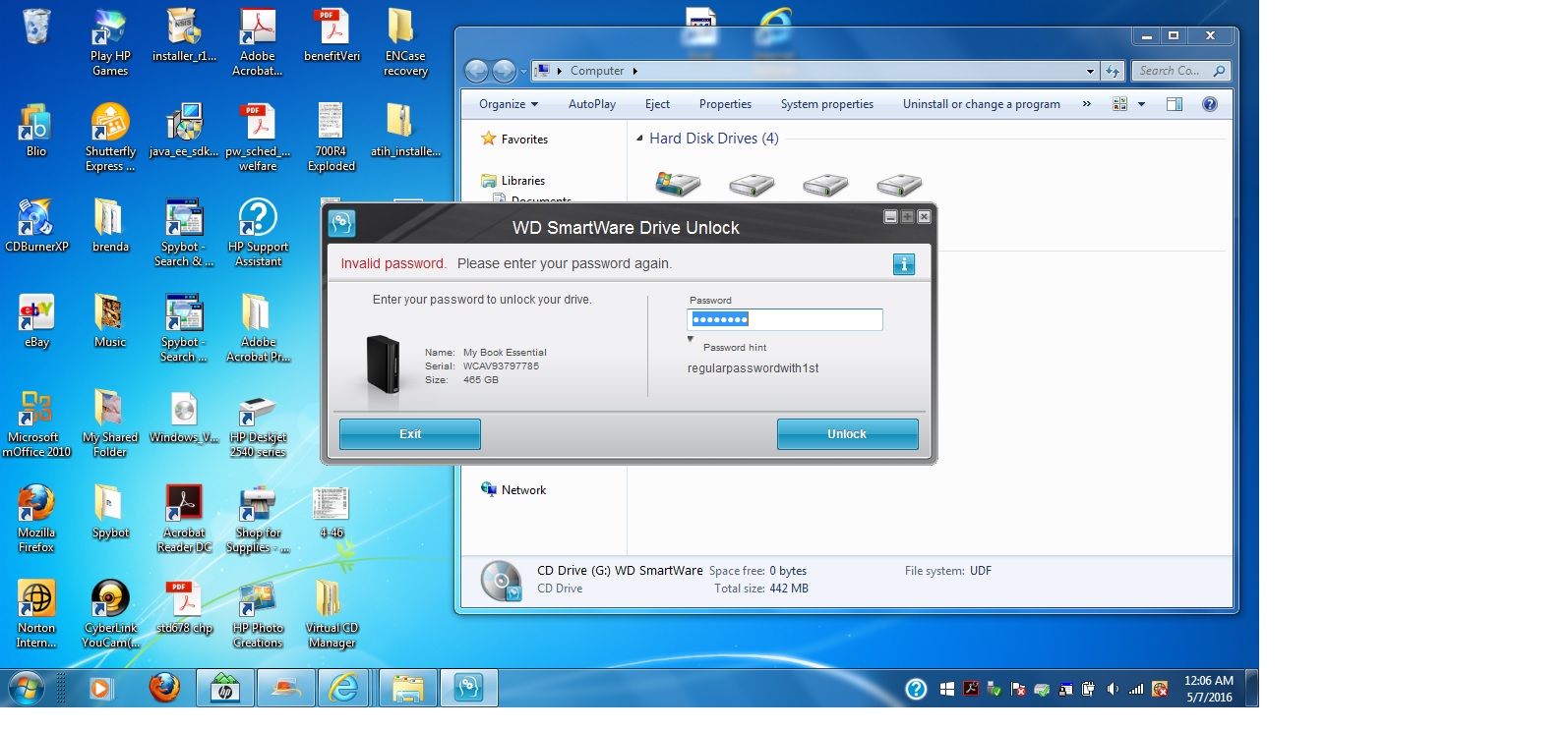

I have a similar issue, if not, the same. I have a WD My Book Essential 500gb external harddrive. I haven't used it in over 6 years and I forgot the password. Even the hint doesn't help. I tried to click on the link for youtube and the link is bad. Seems like it violated Youtube rules and got removed. Any idea where I can find this video so that I can unlock or bypass the password window? Thanks in advance.

The video was just a demonstration of his procedure working, but it did not showed HOW it was done.
If you need those files, the easiest solution would be a DR Recovery shop. Depending on which city you are, you can find some people in the forum that could help you.
