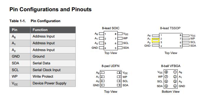

Your diferent way is welcomed. This is other way, ill test to to close contacts 2-3 on ATMLH008, but i need tech info about mine IC

U5 has a working voltage range of 1.7V - 5.5V, so 2.8V is OK.
The number "ATMLH008" is not the actual part number. See the "Part Marking" section of the AT24C256C datasheet (page 14).
ATML = Atmel
H = Industrial/NiPdAu Grade/Lead Finish Material
008 = YWW date code (week 08 of 2010)
The marking code is on the next line (2ECL).
By shorting pins 2 and 3, the EEPROM's address pins are shorted, which means that the controller will not be able to detect it. Therefore the controller would power up in kernel (?) mode.

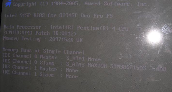

Hi Randy
I try this waiting diferent amount of time (1 sec, 2 sec, 3 sec, 4 sec, ... ) about 10 times but not SSD is not recognized. by MHDD.
Note: I plug power to SSD, wait a bit, DRSC (in blue) and DRDY (in blue), and AMNF (in RED). When i execute "eid" commmand always get: BUSY (green), and DRSC (in blue) and DRDY (in blue), and AMNF (in RED)

If you short U5's address pins, then this will be one way to verify whether the POWR607 is releasing Power On Reset. If you get output from the serial console, then this will prove that the controller is not brain dead. If not, then this would support the idea that POR is not being released, which would in turn support the idea that Vio (or Vcore ?) is too low.

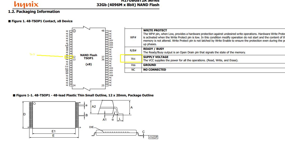

There are similar PCBs in this review:
http://www.storagereview.com/ocz_vertex ... d22vtxe60g
They use Hynix H27UBG8T2ATR MLC NANDs. These are specified for operation over a range of 2.7V to 3.6V.

I'll test v NAND chips
See pic
 Post subject: Re: OCZ Vertex 2 240GB SSD for recovery
PostPosted: April 13th, 2013, 6:17
Posts: 17223
If you want to probe the NAND voltage, then I suggest you pick a safe spot such as an adjacent filter capacitor. For example, C39 next to U16 on the controller side looks reasonably safe.

Did you short pins 2-3 on U5 and did this give a terminal output with clear text instead of garbage?

sort pins is safe to SSD?
PostPosted: April 17th, 2013, 9:56
Posts: 3973
Yes, you would be shorting the pins 2-3 on U5, which is AT24C256C. Read the post by Fzabkar above.
I read on another forum that the poster was able to get a clean text serial output. You got a serial output like this:

First: I must say that in in my first test i get output data via serial, but after i get no data via serial port output (today i get no data neither)
I tried to test serial output shorting pins 2 and 3.
but no response via serial Port.
Note: when i short pins 2-3 and them power up SSD the green diode is ligthing but Red diode not ligthing

Continue testing About BIOS:
If power up SSD and when them short pins 2-3, Green diode is ligthing and Red diode is ligthing
too. and no BIOS info
