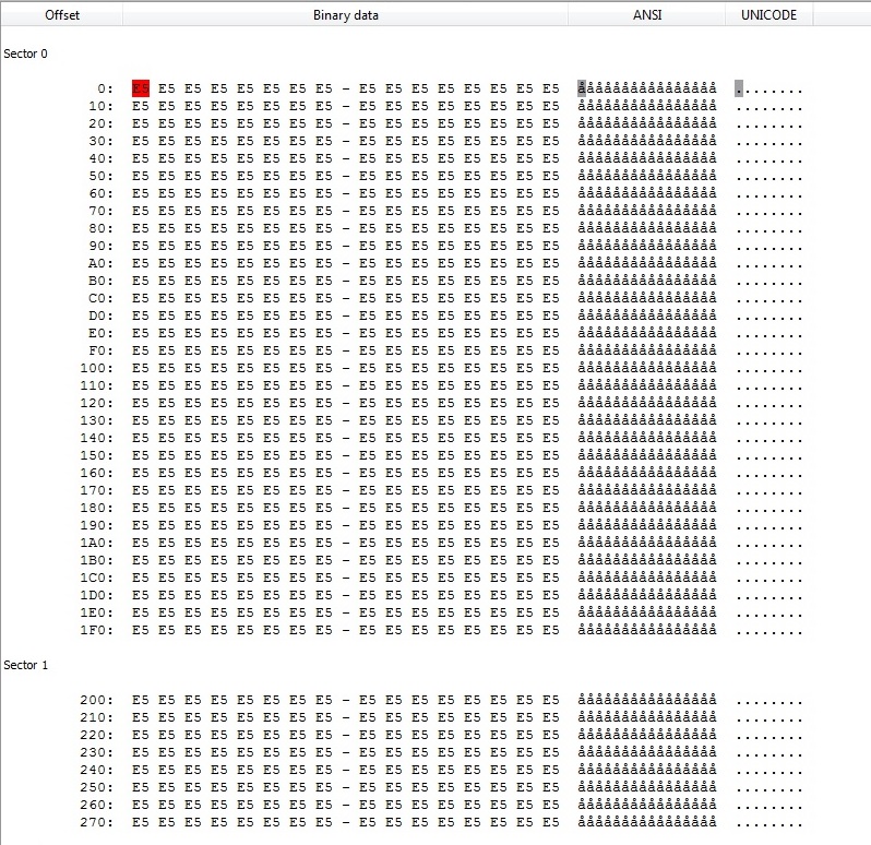

After long time, i decided to work again on this case and i was able to make detect this helium drive with correct size in windows.
I just did some little modifiations on the usb controller rom.
MyBook controller eprom rebuild.rar [35.08 KiB]
Downloaded 1056 times
Unfortunately drive is still unusable :cry:
Partition still not accessible and i can't even initialize the drive, i also changed the usb controller an it behavies the same.
R-Studio always show dummy E5 pattern on all sectors
I came to conclusion that this drive has damaged translators
Unfortunately a solution is still unavailable for this type of drive. :(

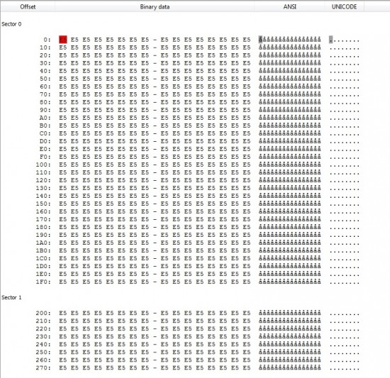

Same 0xE5 pattern here:
https://groups.google.com/g/datarecoverycertification/c/J607fMsAm8E
