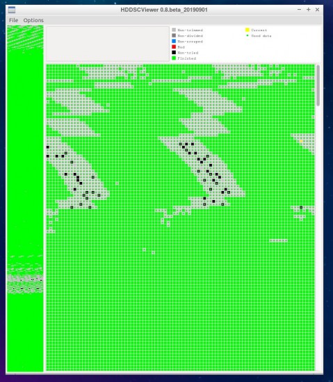

BGman wrote:
The head is not bad, the surface is scratched. Can you make the difference?
Yes, I make the difference. Head crashes on disk for whatever reason and surface gets scratched. I assumed that a head touching the platter and scratching it would be called a bad head. But you're correct, I should have said how much data was recovered from a platter with a scratch.
BGman wrote:
Normally it takes less then 24 hours to recover the data from such a drive by the way proposed by @Northwind..
I know. I didn't have the donor stuff yet and we decided to take the risk without it.

 Post subject: Re: PCB BIOS and FLASH swap
PostPosted: November 11th, 2020, 18:25
Posts: 992
BGman wrote:
zvit wrote:
I am amazed at how much data was extracted with a bad head.
Everything I saw in the logs provided indicate that there is a totally dead head. Maybe the file system (MFT) is all in the good heads, but there will likely be some files or chunks of files that may seem recoverable, but are either damaged or blank if any part of them was in the bad head. This drive would almost certainly require a head swap to get any data from the dead head, assuming the platter surface is not already destroyed from the current recovery attempt. But yes, a pro would have got to this point much faster, and hopefully inspected the heads before making a decision to thrash on the drive without a head swap.
http://www.hddsuperclone.com
Home of HDDSuperClone

I would have thought that a head crash would be audibly obvious, especially after such a long recovery.
PostPosted: November 11th, 2020, 19:45
Posts: 4826
It's probably not a head crash, just surface damages which affect data integrity, or the head is weak, ie it reads servo (so no clicking) but not user data.
i didn't see the logs, but from the screenshots i would think the head can still read user data but the drive gets stuck at damaged sectors where resets can come handy or change config to reduce retries.
But anyway, data read from those areas will be corrupt, nothing to do about it.
PostPosted: November 11th, 2020, 19:53
Posts: 992
The drive had a complex issue, both the slow issue and a bad/dead head. The drive was old enough that the slow issue could be fixed with HDDSuperTool. Only then could it be seen that there was also a bad/dead head. From what log data I have I can see that the head is not reading any data at all. That is MY assessment based on data available to me.

I might have made a wrong assumption about the colors based on PC3k map coloring. But here he has green and other colors mixed, not large blocks of green, then large blocks of something else. Or this part is from a good head albeit damaged surface...

pepe wrote:
https://forum.hddguru.com/viewtopic.php?p=285375#p285375
Yes. The upper part of that is where the slow issue was present. Then you can see a pattern related to a head issue. But with the last image the OP has selected the show good data option in HDDSCViewer, and the green dot inside the cells indicates that there was data read in that area. Everything in the bad head area has no green dot, no data read.

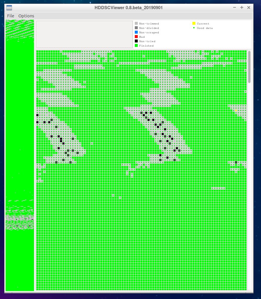

PostPosted: November 11th, 2020, 22:51
Joined: May 9th, 2010, 11:23
Posts: 63
Location: Jerusalem, Israel
Thanks pete, no worries, all is good. I wasn't offended in any way.
After fixing the slow issue with HDDSuperTool and starting again, the green started from the top.
Can't find on Google a reason how a surface gets damaged without a head crash or some physical shock to the drive, which didn't happen. (Maybe some static electricity discharge?) If the head is just weak or bad (like maximus saw in the logs) then I understand that the head can't read data, but since there is no noise or clicking, what else could cause surface damage (and put the drive at risk to further surface damage during a scan?) Perhaps a piece of dust broken off of the bad head? If a bad head is just not accessing the data but no surface damage, wouldn't it be safe to scan without further damage? (Or perhaps a bad head can break off a piece of dust at any time?)
Attached screenshots from last 40 minutes of scan. One is a time-lapse :-) (in case it's interesting to anyone)
Here's a good example of how physical damage to the platter tends presents, You can see the heads struggling for the first 10% and again around the 75% mark but some data is able to be read in the area and the rest of the surface is fine.

I should probably read the manual for HddSuperclone, coz one thing is not clear: a green (or whatever color) block means one sector or a block of sectors of arbitrary count? First I thought it is one sector now i tend to believe it is a block of sectors. The whole map would be more readable if it was sector based or if it was possible to select how many sectors they represent at least (maybe it is... ?)
In the viewer, you can choose how many sectors a block will be (for visibility purposes.) You can also play with the points (block size) for display purposes. There is a nice video showing how to use the viewer here: https://www.youtube.com/watch?v=jD_tKUh8npM
PostPosted: November 12th, 2020, 9:25
Posts: 4826
Ok, then what was your setting for map display block size?
If you watched the video, you'd see a trick to play around with the sizes and window size, to get the bad head section lined up nicely in the graph. Since this would change every few hours (depending where it was scanning) I changed the sizes a few times, depending on what I wanted to see and how I wanted to line up the graph. So I can't remember what setting I had exactly at the time of the screenshots (and gif) but I started with: 1 dot = 12K and dots size 8pt.
PostPosted: November 12th, 2020, 18:18
Posts: 4826
that video is a demo and it is not your case, i was curious about yours. I wanted to see if there are any good sectors in the marked areas, or they are completely bad or they were skipped. I don't care about how nicely the pattern lines up, i wanted to get a picture about what's going on there. Which i can't see coz the block represents multiple sectors, which in fact can be a pretty large area.
The only log file i saw was from the very beginning of your process, i might have missed a larger log?
HDDSCViewer does not have a set block size, but instead has a way to set how big the map is. The number of sectors in a block would be determined by the size of the drive in sectors divided by the size of the map. But I never intended it to be an exact size, it is meant for being able to visualize the recovery. The user can click on a block and in the terminal it will display the first sector of that block, but that does not help someone like you asking absolute questions. BTW, only a sith deals in absolutes :wink:
In this case, the option to highlight good data has been selected. That option would put a little green dot in any area that had been attempted and had any good read at all, but was in a state other than fully read (non-trimmed, non-scraped, bad...). The non-trimmed areas are in grey, and if any of those would have had a good read, there would be a green dot in the middle of them. I have examined the logs that were available, and at no time did I ever see any data read from what would be considered the bad head. If you want to know the size of the head reads, I can get that from one of the logs, but it won't be exact since phase 2 has not been run and there will be data that was skipped and not read up to the back edge of the bad head, if that makes any sense to you.
