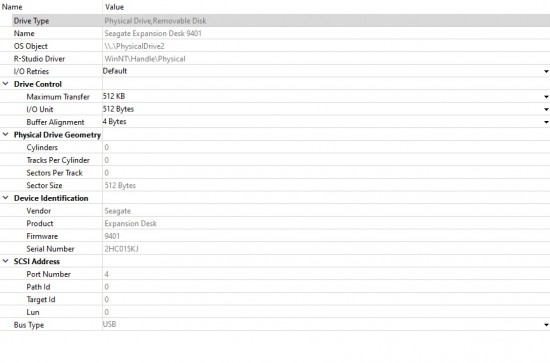

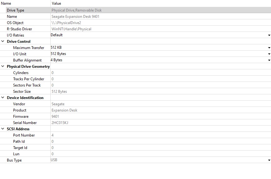

Got some more donor boards in today, another one boots up the drive perfectly, stays on, however, in o/s it can't detect proper "Physical Drive Geometry". Of course because of random bios:
I just can't believe I can't get these files. Seems like the drive is right there, spinning, on, everything working... I could initilize the disk, but I heard your data is gone after that. Plus it probably wouldn't work anyway, just say i/o communication error.
Also, in SeaTools it passes the Short Generic Basic Tests.

Seems like the core of the problem is the ROM chip and data on it. probably it was fried and the ROM data gone.
If that is the case, the ROM will need to be rebuilt. I'm not sure, but try Seagate recovery as they created the drive and you never know, they might have a database of all the ROMS made (Wishful thinking I know.). Also, be aware the drive might be formated in 4K and the bridge board might be needed. Not sure how important this is, but if the drive does seem to work, but cannot access or initialize the drive, it could be a bridge board 4k stuff.
Not too sure.
I guess you didn't have a backup of your data?

Guys at Seagate could not do it, in fact they sent me test job to see if i can do them. Unfortunately it was a Grenada that i was able to recover the SA from, but one critical parameter i could not restore, so the user area remained unreadable.
I recovered a ROM for a drive after it was at Ontrack, so they cannot do it i suppose. We would know about it if anybody else was able to, IMO.
This parameter is there in your rom's remnants, so there is a chance i can recover it, but it is a very complex and time consuming job.
I looked into it briefly and saw it might be possible but i need the drive physically. I usually do rom recovery for those older families at 1500 eurs, i need to estimate the complexity of this job and wether i can find the time to do it.
The cheapest and least expensive way would have been reading the orig rom chip, perhaps with some special settings and measures, i suppose this chance is busted if those good people erased it on purpose :s
There's perfectly no point in experimenting with other roms, for the chance of those to be working is lower than winning all of the existing lotteries on the globe simultaneously.
