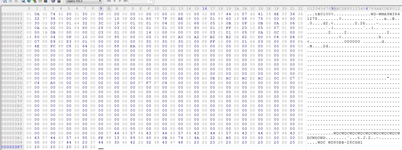

please tell me where my password is.
“WDCWDCWDCWDCWDCWDCWDCWDCWDCWDCW” Not worked.
look at 00000170 tabernus is your password
doesn't work :(

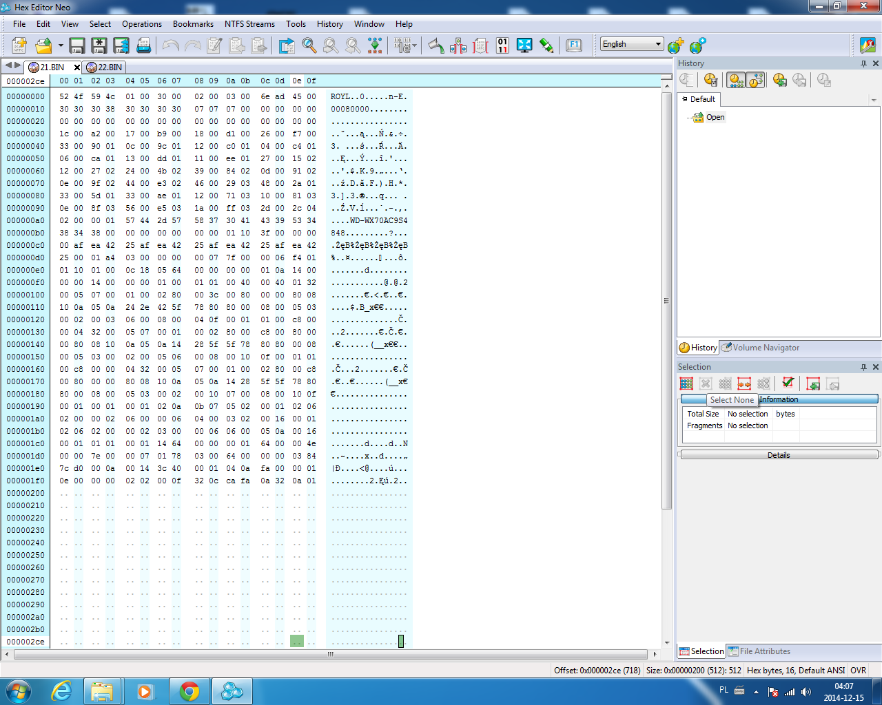

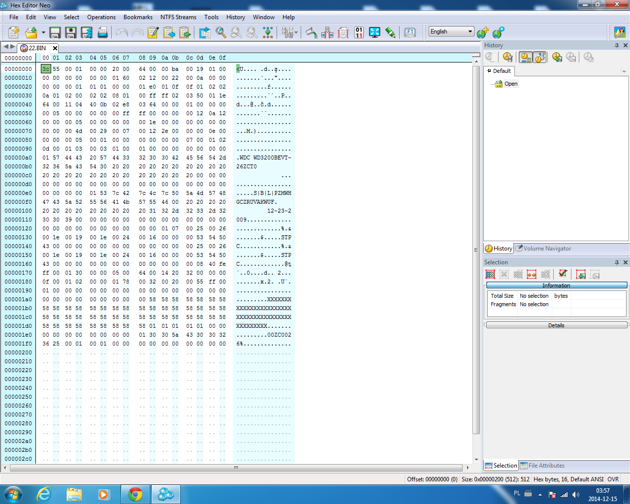

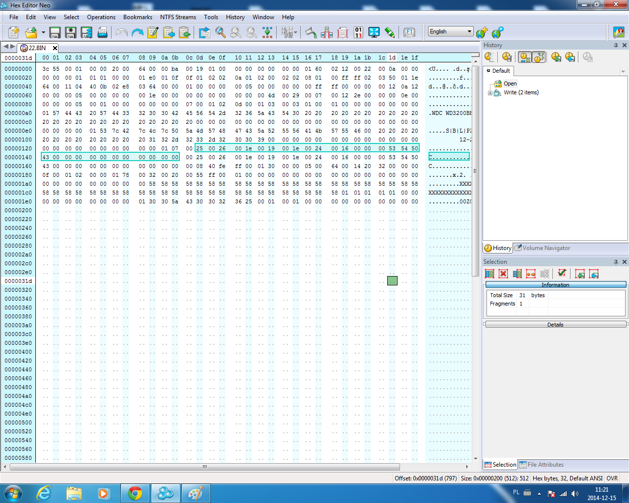

Heloo,I read bin from my WD3200BEVT.
But I Cannot see code from bin. Can you help me what is code? Thanks
PostPosted: December 15th, 2014, 0:47
Posts: 402
Location: Moscow
0x12D - 32 byte user password
0x14D - 32 byte master pass.
PostPosted: December 15th, 2014, 6:25
Joined: December 14th, 2014, 22:53
Location: POLAND
So password is %&$STPC but is not working or i blind and cannot see the correct...anybody else can help here?
PostPosted: December 15th, 2014, 7:11
Location: POLAND
I unlocked it with HDAT2(hex)Thanks for help and sorry for spam:P

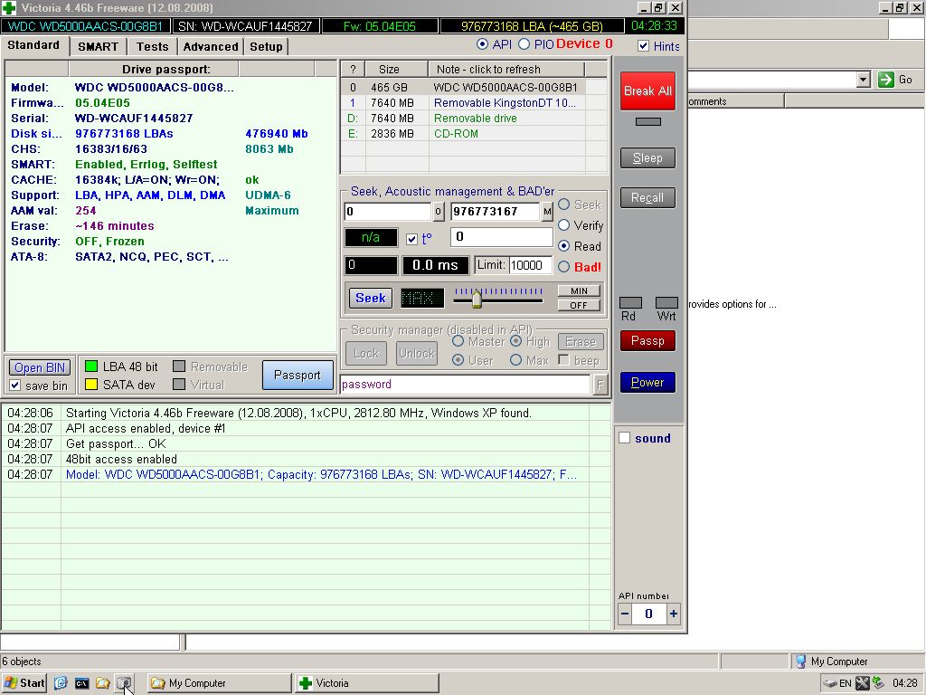

Dear community:
First of all I introduce myself. My name is Juan Manuel and I am from Argentina. (also please excuse my horrible English).
I have given to you because of nowhere, after formatting my HDD WD Caviar Green 500GB for the OS reeinstalar my PC, the HDD is lock and I am not accessing and aboslutamente anything.
I have read several pages, various forums across the web and have not been able to find the result. What if I stay clear is that the HDD Password Lock by Ata.
I write here because all you have come to the solution of the problem, only the help of this forum helped me.
Step to tell them and also with Screenshoots my problem:
By MHHD I could extract the 22.BIN, yielding the following:
http://i.minus.com/ibmlYRjbRmFPiP.jpg
I have read about identifying Users Pass and Pass Masters. As purchased by you and watching the 22.BIN sack in conclusion that:
User Pass:
00 00 00 00 00 00 00 00 00 00 00 00 00 00 00 00 00 00 00 00 00 00 00 00 00 00 00 00 00 00 00 00
http://i.minus.com/ikpHwOVEE9ope.jpg
Master Pass:
57 44 43 57 44 43 57 44 43 57 44 43 57 44 43 57 44 43 57 44 43 57 44 43 57 44 43 57 44 43 57 00
http://i.minus.com/i58CkXNHKHwwc.jpg
If until now acquired information that is valid (please correct me if I make mistakes), then with these data, I could not unlock my HDD.
By accessing the keys in MHHD I always throw the message "Fail", but also'm not sure I used the correct method and the correct way. It has not been clear how I admit you the keys with "ALT GR" and all that ...
Then I found information that Victoria can do. The method is the same as the friend Spildit shared, but I think it was failing on the way to save the key in the file ...
I'll try to Spildit information, as this much clearer copy and paste and save the file that way.
I just wanted to ask if so I have to save the files:
User Password:
http://i.minus.com/isSL1z3cJ7YjT.jpg
Master Password:
http://i.minus.com/ib1UJseSf7Sl4f.jpg
I also show you information that throws me Victoria, and errors when loading the file.
The Victoria I'm running from the Hiren's Boot MiniXp. You can run this way?
http://i.minus.com/i1k3PMwE6n2vi.jpg
http://i.minus.com/ibjBmU6ML5RUb5.jpg
Greetings all, many thanks for having been so many years fighting this problem and providing all possible solutions!
I start to realize the shared Spildit tutorial and step them the news. Many Thanks!

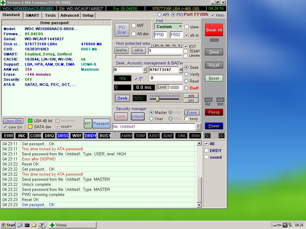

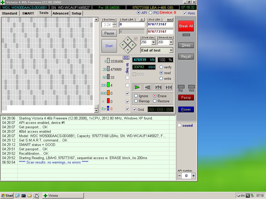

I'm almost what I can not believe !! I fall a few tears ... hahaha
Spildit Thank you so much for sharing the information was very useful and clear, I could solve no problems !!!
Eternally grateful to this forum and everyone who helped to solve this big problem.
Affectionate greeting to all !!!

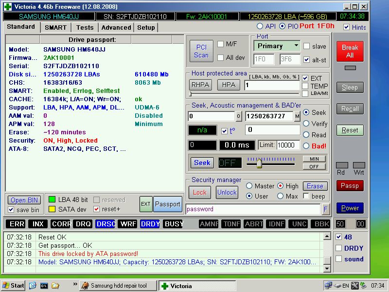

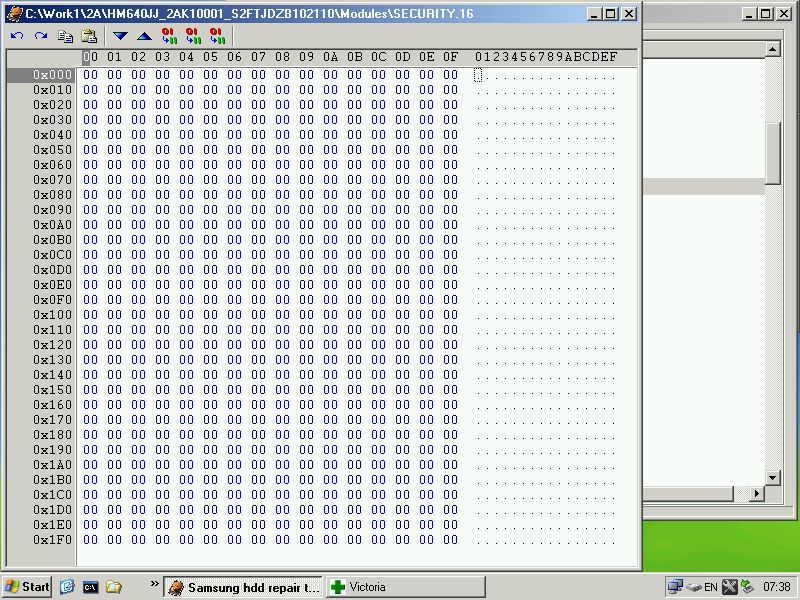

Hello
I'm new on this site, but I'll try to list all the details of my situation.
I bought a Medion MIM2280 laptop from some guy on the internet, which has a Samsung HM640JJ HDD in it. He sold me the laptop quite cheap, because he said it's "broken", but after some research, I found out that actually, the HDD was locked by an ATA password. Till now, I didn't even know that you can put a password on a HDD, so obviously I had to do a little bit of research. I tried all kind of "solutions" found on the internet, but none of them worked. Yesterday, I came across this forum, and learned that the ATA password shoud be hidden somewhere in the hex code...so I gave it a try.
I booted HBCD from an USB, and started Mini Windows XP. Then I used Samsung Repair Tool to access the hex code of the HDD, but then, I bumped into another problem: it's all zeroes, and I have no idea why or what that means. So if anyone thinks that can help me, please do!
File comment: Victoria 4.6b HDD info

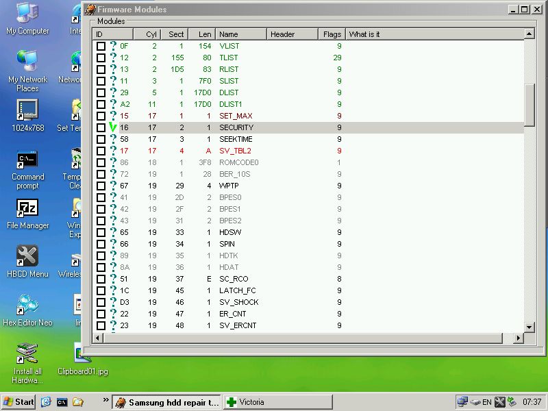

Yes, I've read the module (the green checkmark is there), and I don't know why it's not at the start of the module, or why the hex is completely empty.
Where I could find a module for my drive and how to copy it into the HDD? (sorry for being such a noob, but I'm kind of new into this stuff)
PostPosted: February 19th, 2015, 6:11
Posts: 411
Location: Romania
This is differrent series and differrent firmware structure compared to old ones......The pasword is in other place in firmware.
www.datasave.ro
