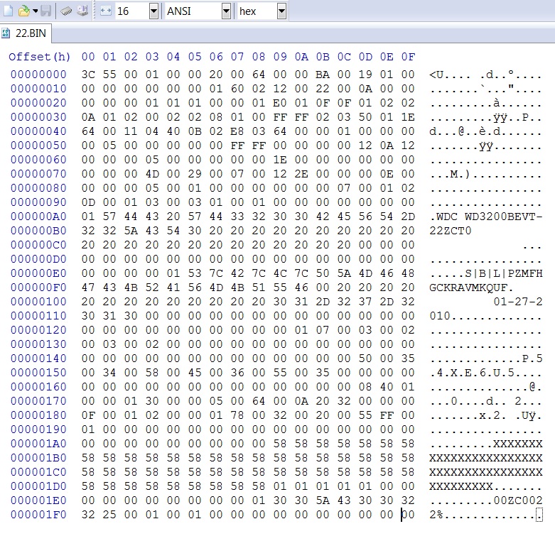

PostPosted: March 1st, 2015, 11:08
Joined: March 1st, 2015, 10:59
Location: scotland
Could anyone help me please.
PostPosted: March 1st, 2015, 11:47
Location: scotland
Bin version.
PostPosted: March 1st, 2015, 12:10
Location: scotland
Bin file. HDD WD3200BEVT-22ZCT0 .Any help much appreciated.
21.zip [482 Bytes]
Downloaded 993 times
22.zip [390 Bytes]
Downloaded 994 times
PostPosted: March 1st, 2015, 15:56
Location: scotland
You are a star Spildit big thank you.

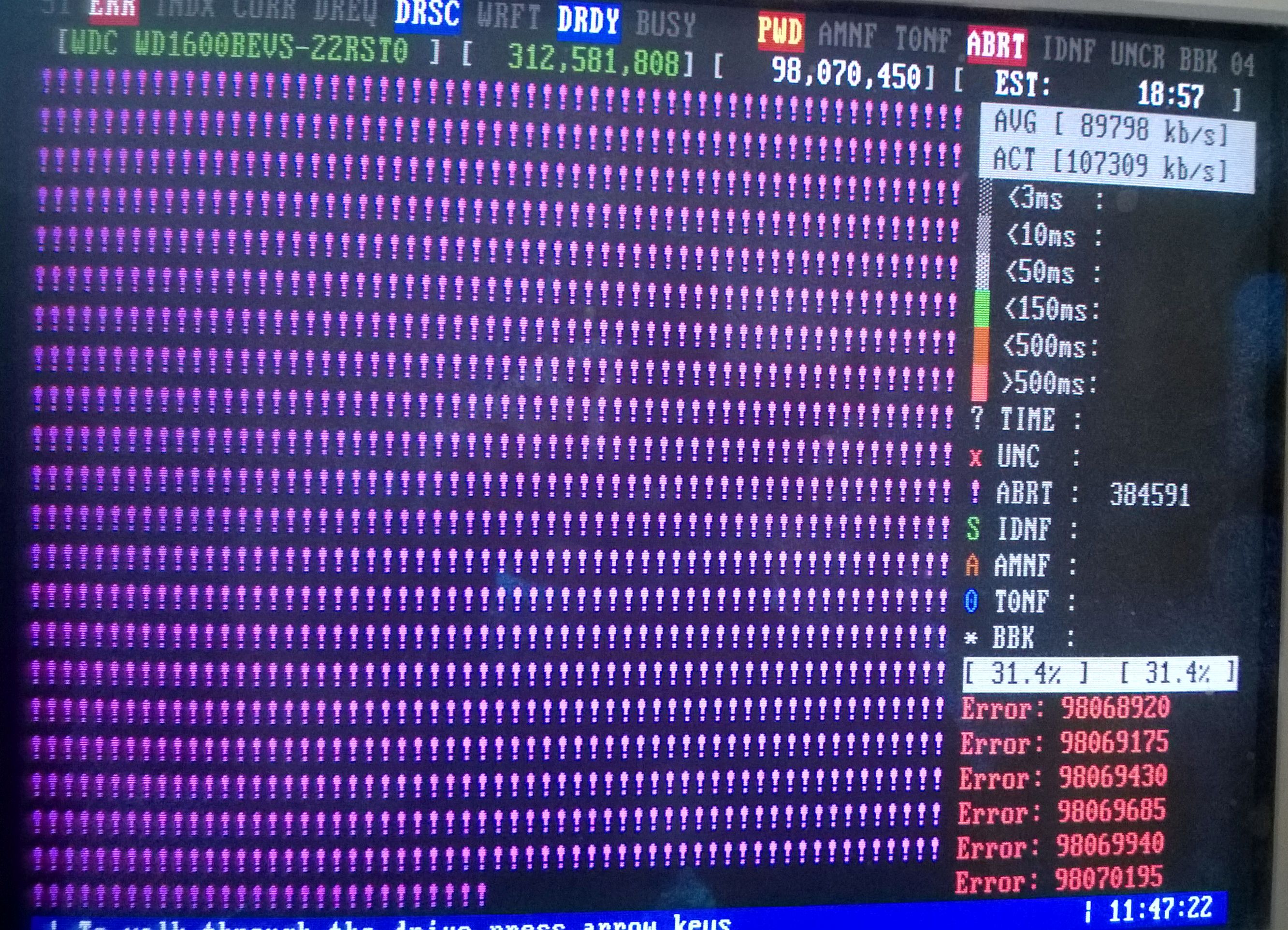

Hello.
I have wd 160gb scorpio drive and i dont know the password.
Followed Arden instructions but i dont know what to do when i enter mhdd.
In mhdd, i press f2 to scan drives,then i select my hdd and i get message something like "your drive is locked".
Then i press f4 and it begins to scan the drive,at least i think so.
All i can see then are pink exclamation marks on the left.
Is this correct procedure or i got something wrong?
Thanks for the help.

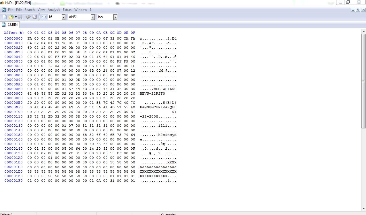

PostPosted: March 8th, 2015, 7:44
Joined: March 8th, 2015, 6:41
Posts: 6
Location: Croatia
I got this...
PostPosted: March 8th, 2015, 8:13
Posts: 927
Location: uk
keymaster wrote:
I got this...
Passwords are clear to me! If you can't work out what to do next then read the posts by Splidit on the previous page
PostPosted: March 8th, 2015, 8:21
Posts: 6
Location: Croatia
I guess passwords are 1111 or h2oinsyde.
Have tried both of them when my laptop boots up and asks for hdd password but none of those matched.
I will try to enter it through victoria and hex file like in that tutorial.

When i enter mhdd i select my wd drive.
Then i type dispwd and program asks master(1) or user(0) password.
I tried both of them and then typing 1111 and it says fail.
I guess the password does not match or something like that.
PostPosted: March 9th, 2015, 6:00
Posts: 6
Location: Croatia
It worked!
I had to unlock it first and then use dispwd command.
Thank you guys,Spildit especially,i thought that i will throw this hdd in garbage.
