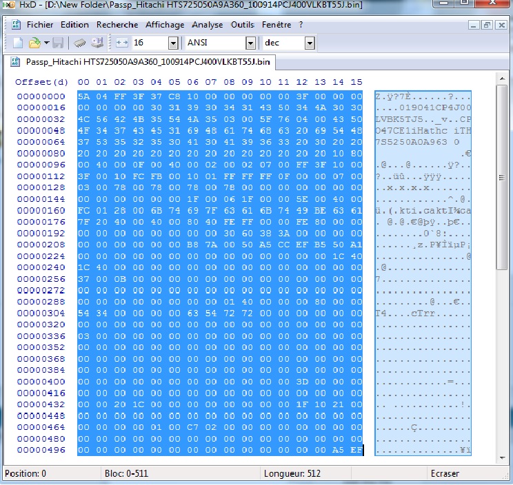

PostPosted: January 19th, 2016, 12:00
Joined: January 19th, 2016, 11:40
Location: france
Hello everybody,
To begin, i'm sorry for my English
thanks to Spildit for his guide.
But i've got a problem with this guide.
My hard drive Hitachi is Locked : Sécurity On High Locked *Expired (on Victoria)
I have extract the file .bin with Victoria but i can't find my password is this file.
can you help me for find my password ?
thank you
PostPosted: January 19th, 2016, 12:32
Posts: 927
Location: uk
Look at the title. This thread and method is for a Western Digital drive!

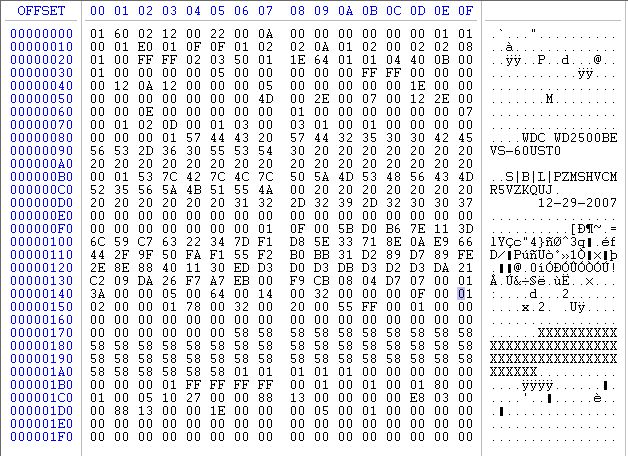

Hi, I new to this forum I learned a lot on how to read 22.bin ...
I have a panasonic CF-53 any HDD or SSD I put inside get a password.
I have two SSD with password yet, so I put a old WD hdd inside, bios also put password on it.
I really need to know the password, I will be able to unlock 2 SSD
So I managed to read 22.bin from my WD2500BEVS
Thanks for the help,
Best regards.
22.zip [444 Bytes]
Downloaded 1754 times
