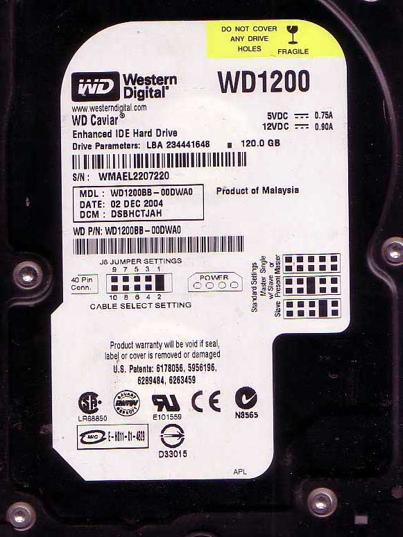

can anyone help me with new HARD DISK PCB WD120 here is my HD info :

That's Traiblazer
compatible PCB could be on following drives
WDxxxxBB-xxEDAx
WDxxxxBB-xxEVAx
WDxxxxBB-xxFTAx
WDxxxxBB-xxFUAx
WDxxxxBB-xxFBAx
WDxxxxBB-xxDWAx
WDxxxxBB-xxDYAx
WDxxxxBB-xxHTAx

match this
Board No: 2061-001173-000 DA (white label on the IDE connector)
